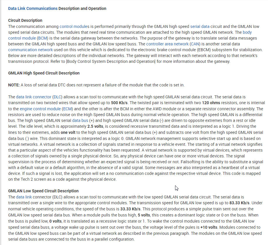

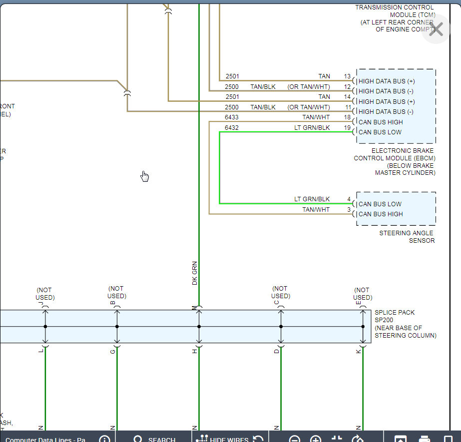

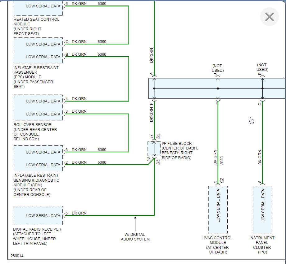

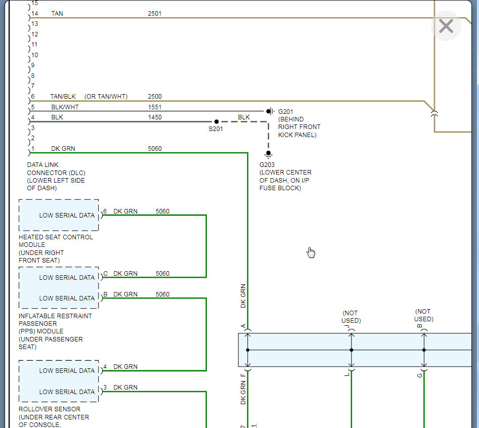

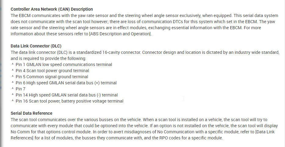

Okay. Couple things. I doubt this is a scan tool issue. With that many tools not communicating with the vehicle, we most likely have a bus issue. You have a hybrid bus on this vehicle meaning you have two types of bus communication. First you have the GMLAN high speed bus that handles most all the communication between the modules. Then you have a CAN bus for the brake control module.
The fact that you cannot communicate with the brake module means either the module has failed, or it is a power, ground, or bus issue.
Take a look at the wiring diagrams and let's check voltage on pin 6 and 14 of the DLC. This is the GMLAN data bus wires. With the key on you should have about 2.5 volts on both lines.
If you don't have communication with the BCM then you are not going to be able to pull codes and it is not going to recognize the VIN. So we need to start here and then we are going to have to check termination resistance.
You do this by unhooking the battery and check the resistance across pin 6 and 14 of the DLC.
Here is a guide that covers CAN networks in a little more detail:
Let me know the voltage and and resistance of this and we can go from there. Thanks

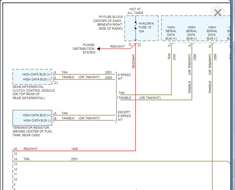

Okay Kenny, here is what I got between 6 and 14 terminals .385 volts and even did each pin to ground and got nothing. that reading was directly between the two pins of .385 vdc, and with battery both terminals off I got 58 ohms between pin 6 and 14 of the dlc.
thanks a million..
Dec 21, 2020 at 12:19 AM
Okay. The voltage to both pins 6 and 14 and when you checked them to ground was 0 volts?
Meaning you put one lead on 6 and the other on ground and then 14 and ground and it was 0?

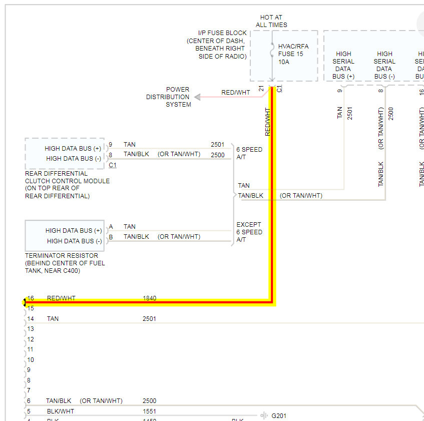

If this is the case, let's go to pin 16 and check for power. Meaning put one lead of the meter on 16 and the other on ground. You should have 12 volts. See the diagram below and we can go from there. Thanks

I got the readings now:
#6 to ground 2.4 volts
#14 to ground 2.1 volts
#16 to ground 11.6 volts
Dec 28, 2020 at 12:05 AM
DADDYCOOP
  • 14 POSTS
Hello Kenny, waiting on you. I need to get this darn vehicle read like last week?
Dec 31, 2020 at 7:14 AM
Okay. Those are good readings and would not cause the tool to not communicate. This proves it is not the tool. Which means it is most likely the module. However, in reading back through this can you take me through what was happening before the dash went out? Was the vehicle working properly before this happened and you were just trying your new tool or was there an issue to cause this?

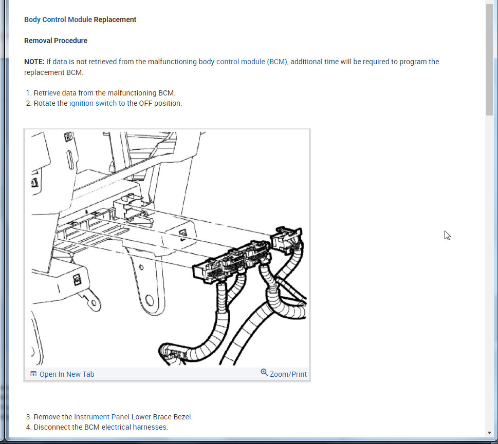

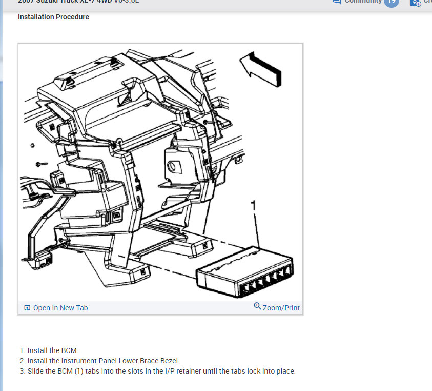

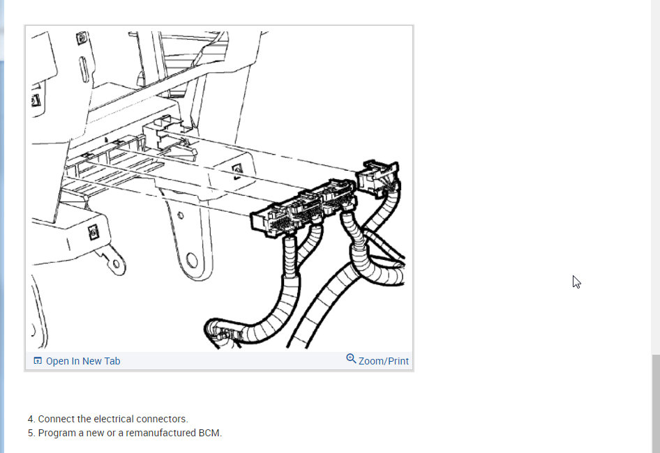

If that is the case then this issue was there prior to you scanning it. Which means you have a decision to make. If the vehicle is operating and driving then you can replace the module as that is most likely the issue as it is not responding to the scan tools. Or you can just leave be until there is an issue that would require its replacement.
If it were me, I would not mess with it if the vehicle is operating. The failure to communicate with the scan tool is not uncommon but there are communication circuits in the control module that will receive and respond to the scan tool. If the wiring is intact and the module has power and ground (which it does or it wouldn't work) then the module is the issue. Again, as long as the vehicle is operating I would not worry about this until it is necessary.
Jan 2, 2021 at 9:18 AM
DADDYCOOP
  • 14 POSTS
the biggest problem is it snows here and she does not have All Wheel Drive. now, they say since ABS light is on, and when you refer to module you are saying the computer, i would get another one but don't know how or where to program it since no Suzuki shops anywhere around now.
Jan 2, 2021 at 9:51 PM

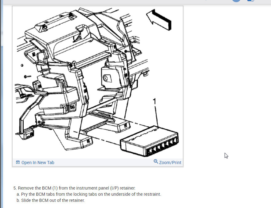

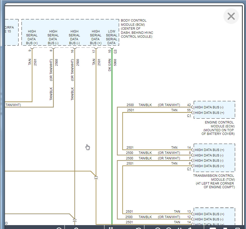

That is a bit of an issue. I think the only option at that point is too find a company that will program the body control module for you and then send it to you for you to just install.
The BCM is the gateway module and is what facilitates the communication between the modules and the scan tool. So if you can't communicate with it, then you either have a wiring issue from the DLC to the BCM or the BCM is failed.
