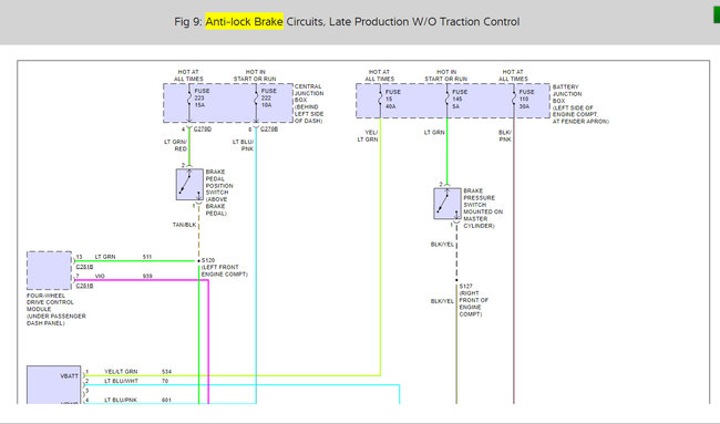

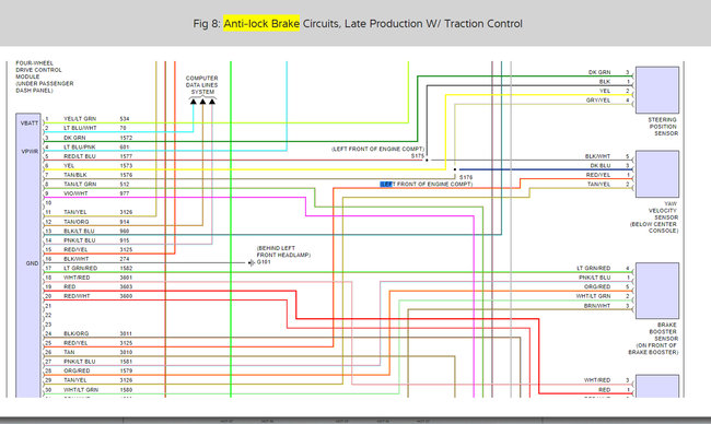

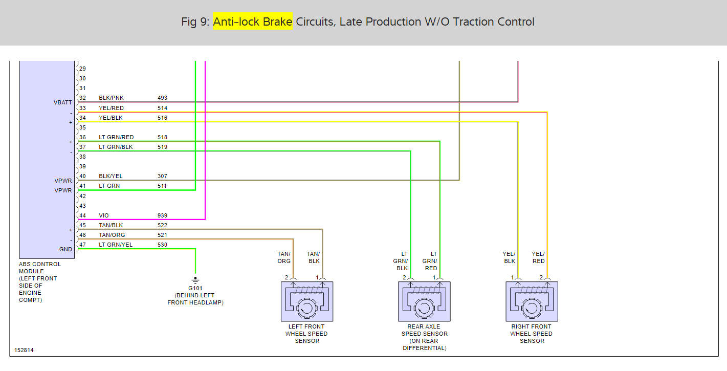

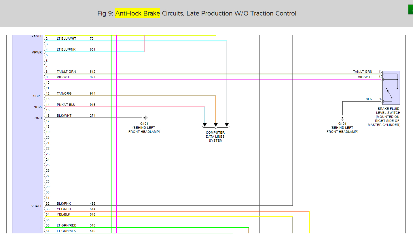

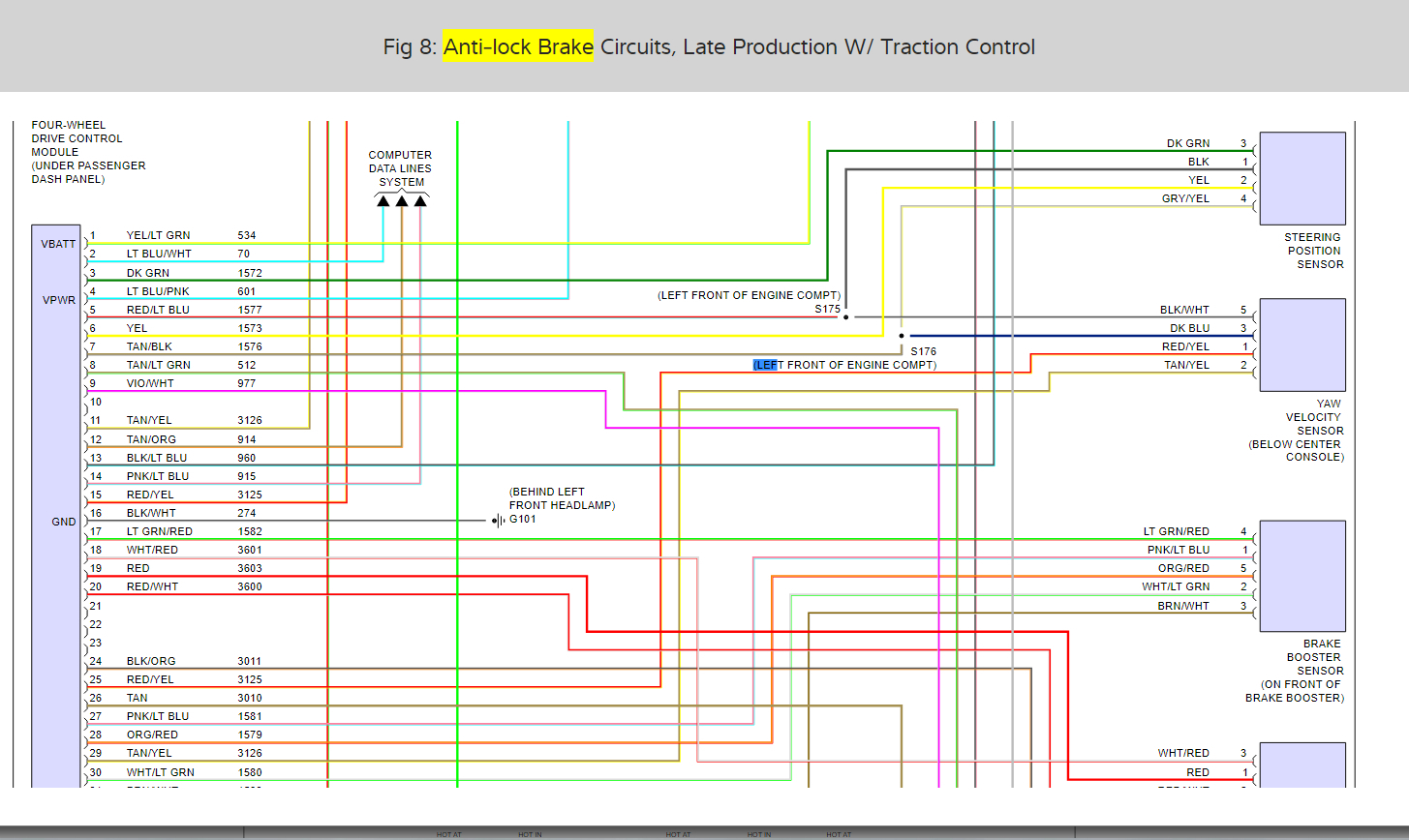

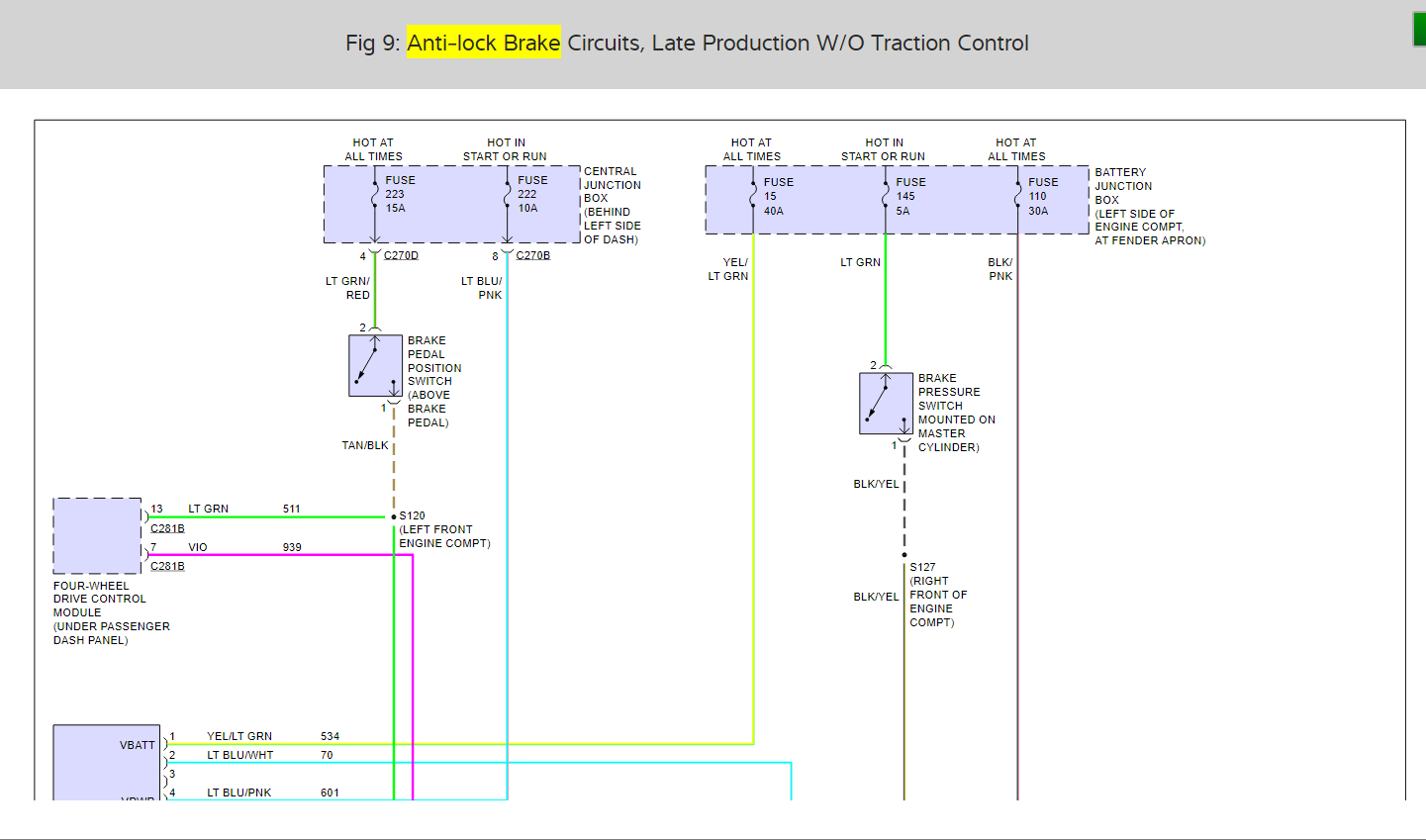

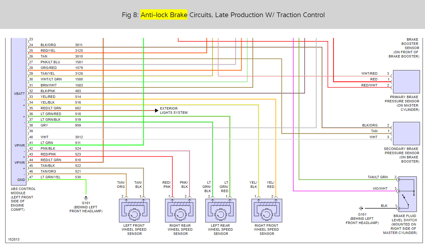

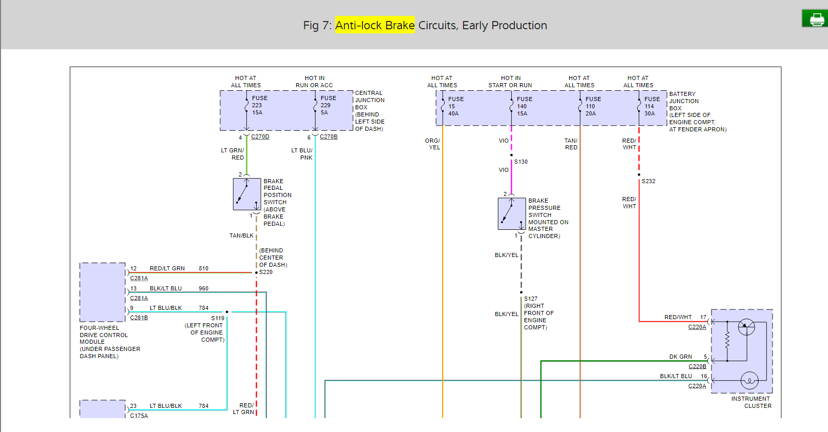

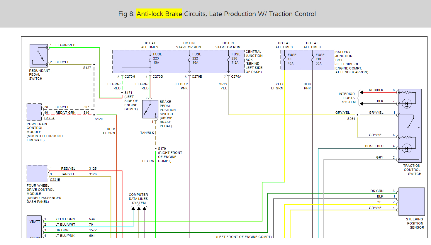

ABS light stays on and drains the battery over night. I pulled the fuses on the first row close to the engine the 40/60 amp for the ABS then took off red cable used a light with the fuses out the light still came on. thank you, Lee
Mar 11, 2019 at 8:13 AM
SCGRANTURISMO
  • 4,897 POSTS

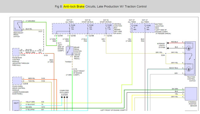

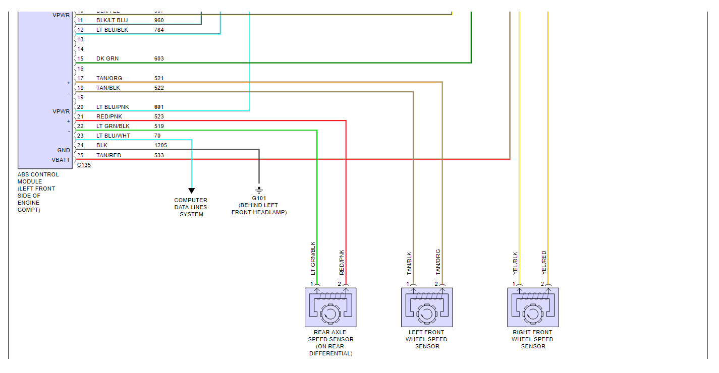

This sounds like you could have a short to power in the ABS warning lamp circuit. I have included in the diagrams below the wiring diagrams for the ABS System of your vehicle. Please get back to us with what you find out.
Thanks,
Alex

You were right on the money. Short in the system .Thank you very much. It saved me a lot of money. Lee
