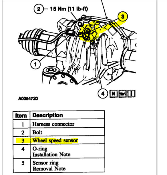

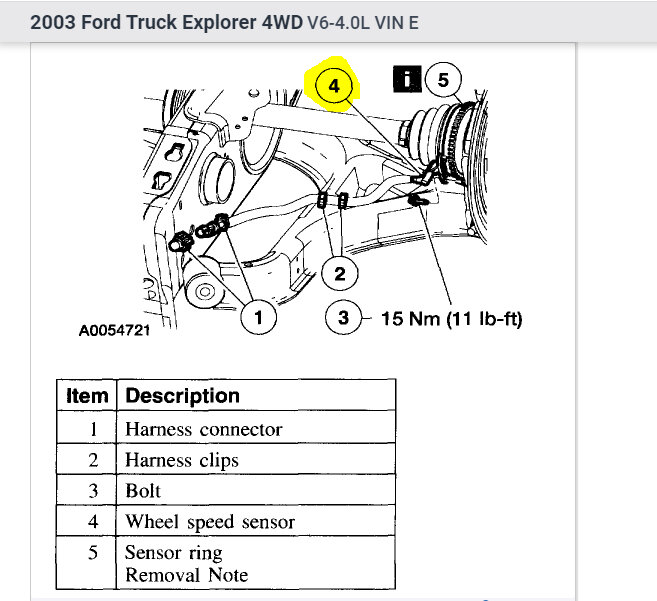

ABS light staying on, both front wheel sensors were replaced?
2003 FORD EXPLORER
115,000 MILES
JANE MULHERIN
ABS light still on after computer said front wheel speed sensors need replaced. Both sensors have been replaced light still on. Other possible causes?
Aug 19, 2023 at 3:38 AM
  • 110,244 POSTS
By chance, do you have the codes that are stored? Also, I need to know if this vehicle is 4wd and the engine size.
If I have the code, it will help point me in the right direction for diagnostics. Keep in mind, it could be related to a rear wheel speed sensor as well. If it has 4-wheel ABS, there are two sensors on the rear. On the other hand, it could have what is called 3-channel ABS which only has one in the rear-mounted at the top of the differential. There could be a variation between that sensor and the front causing an issue.
See pics below for sensor locations. Pic 1 = 4 channel (one on each rear wheel). Pic 2 = 3 channel.
