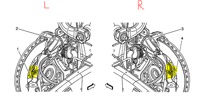

Today went to go pull my vehicle out of my drive and as soon as I went into drive the ABS light came on (only - no others).
Has not shut off since.
Drove it multiple times today and still on. Never has done this before.
Again, only the ABS light.
I checked the fuse and it looks intact.
Sep 6, 2021 at 11:39 AM
  • 110,251 POSTS
Chances are one of the wheel speed sensors has failed. If it does, the light will come on. One other thought is this. If the brake fluid in the master cylinder is too low, it can cause this light as well, so check that too.
Now, the wheel speed sensors are behind each of the brake backing plates (behind the brakes). I attached a pic below showing the locations for the left and right front.
What you need to do is check to see if they produce a voltage signal when the wheel is turned by hand. Here is a link that explains how it is done:
https://www.2carpros.com/articles/abs-wheel-speed-sensor-test
Let me know if you are comfortable doing this or if you have other questions.

Are there only the two front sensors?

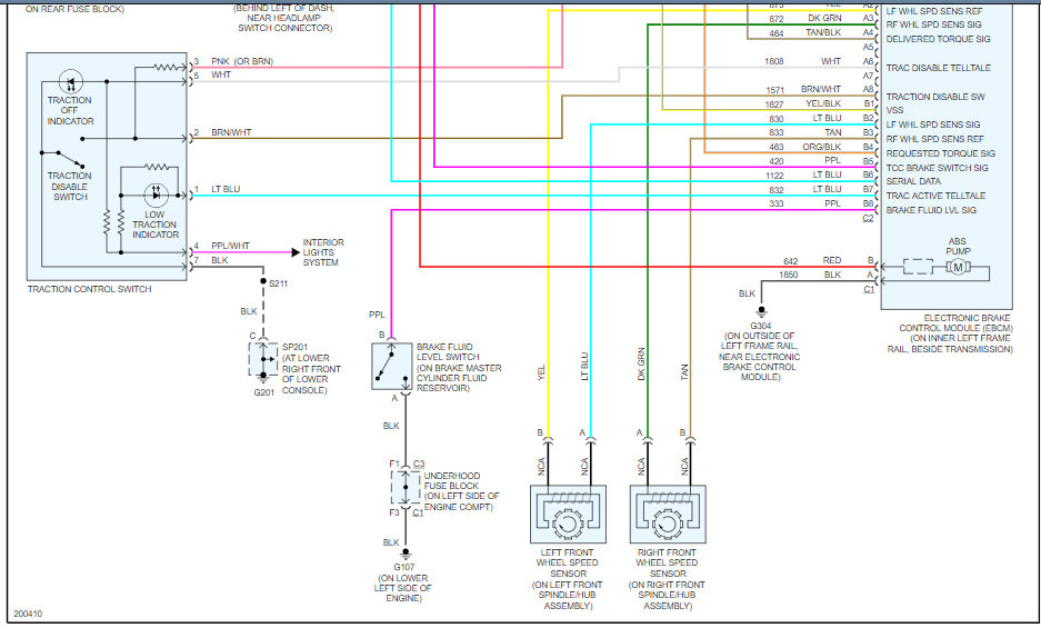

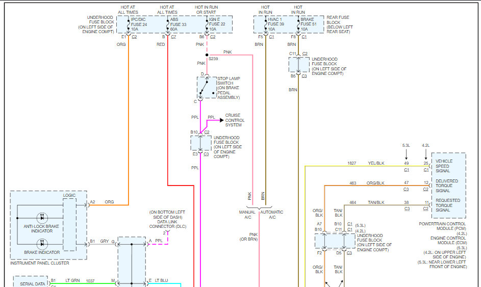

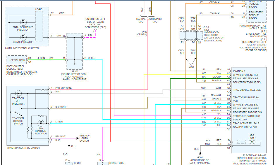

DANNY L
  • 5,648 POSTS
Hello again.
I've attached an anti lock brake system wiring diagram below in case you want to test the wiring circuits to which the wheel sensors are located. Here is a tutorial showing how to test electrical wiring:
Keep us updated to if you ever get the code information on your vehicle. I've cut the diagram into three pieces so you can view larger. Hope this helps and thanks again for using 2CarPros.
