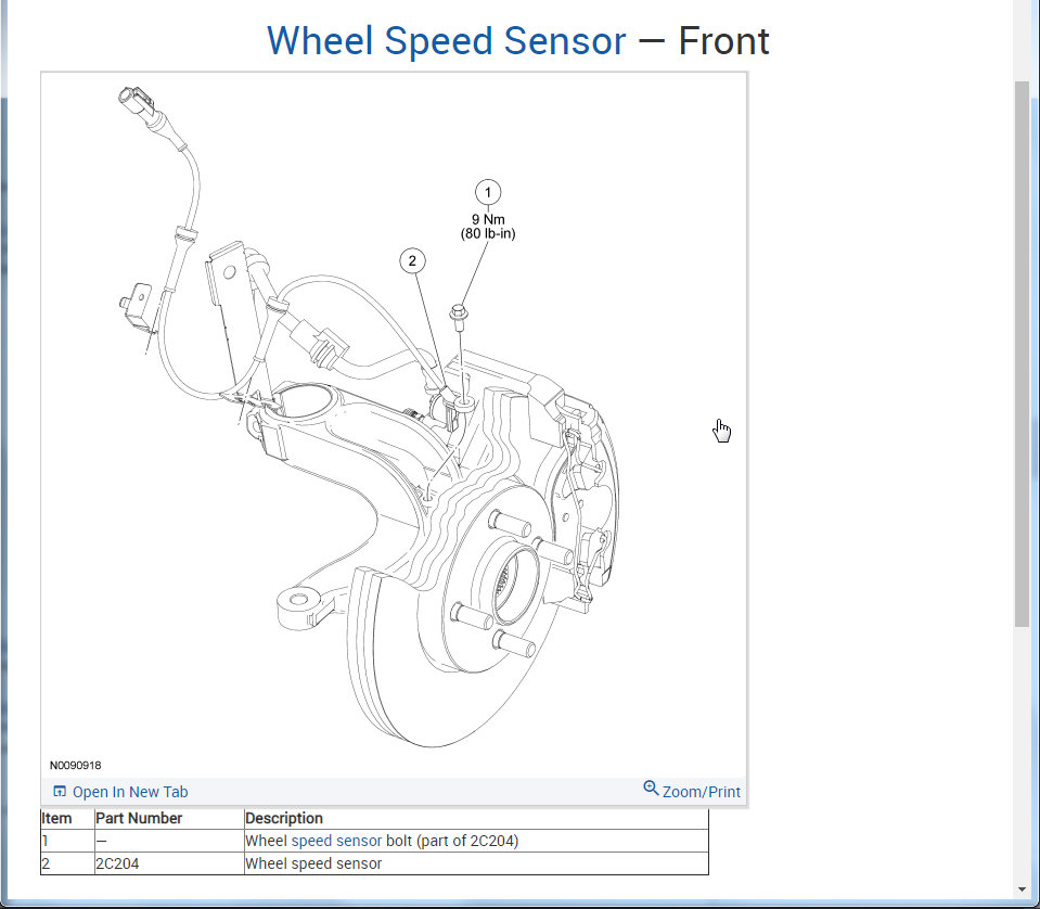

I have the car listed above with a 1.4 tdci. The ABS light is on and car is not revving. Have trouble codes C1233, C1234, C1236. So far changed ABS control Module but no luck. While car is running connected odb tool to perform live wheel speed sensor signal reading and found that from 3 wheel speed sensor the signal is showing 0 and the other one doing fine. Please help me with this issue.

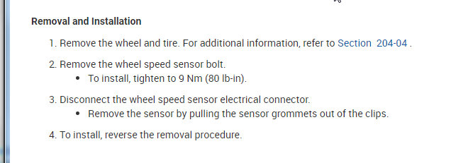

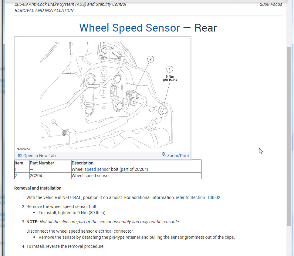

I am attaching below how to replace the front and rear sensors from the manual. Please let us know if you have questions. Thanks
