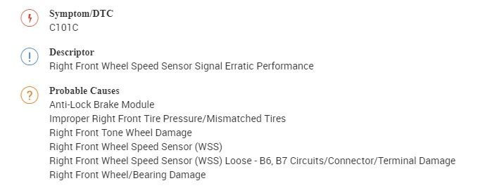

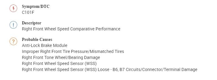

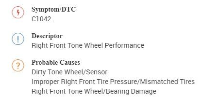

ABS light comes on often. i went to parts store, they gave me the codes that Roy had asked for earlier. they are: C101F, C1042 and C101C.. please help
Dec 29, 2019 at 8:44 AM (Merged)
Hello again,
All the codes point right to the right front wheel.
Make sure all the tires are the same size as well as the tire pressures are correct.
The sensor look like the issue as it is common to all 3 codes.

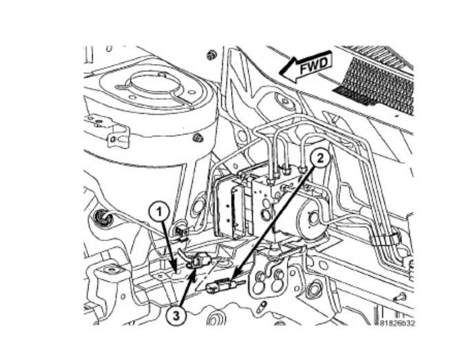

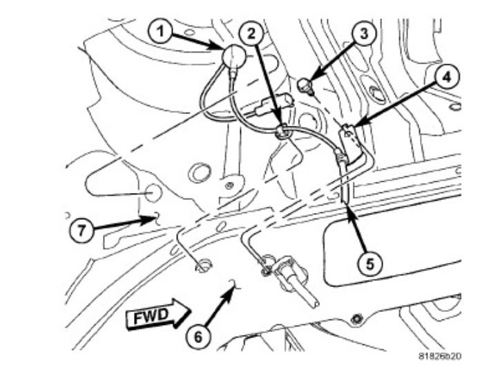

REMOVAL
NOTE: Before proceeding, See: Brakes and Traction Control > Technician Safety Information > Warning See: Brakes and Traction Control > Technician Safety Information > Brakes - Caution .
1. Open the hood.
2. Disconnect the wheel speed sensor cable connector (2) from the wiring harness connector (3) on top of the frame rail (1) to the inside of the strut tower.

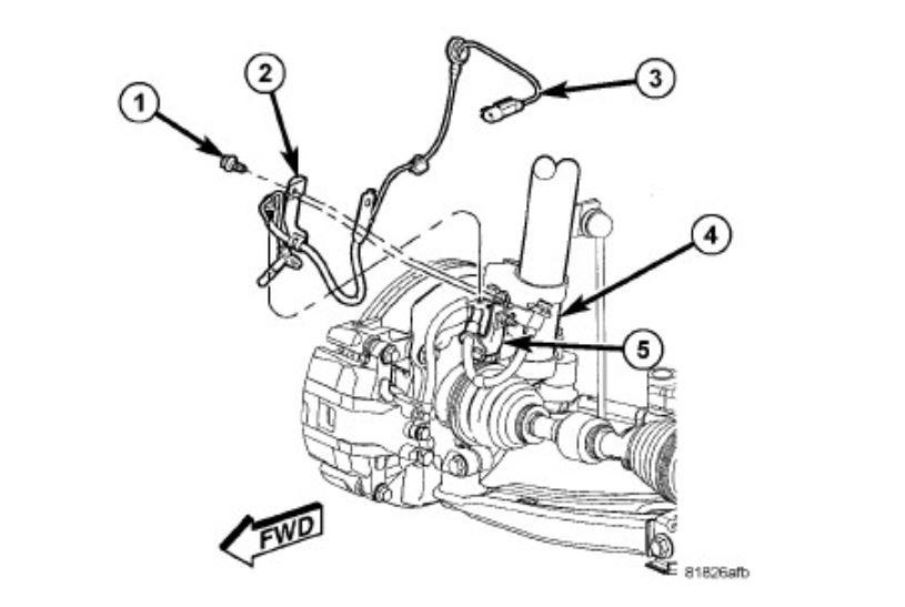

3. Raise and support the vehicle. See: Maintenance
4. Remove the grommet (1) from the hole in the body (7) and pull the wheel speed sensor cable out of the hole.
5. Remove the speed sensor cable routing clip (2) from the outside frame rail (6).
6. Remove the screw fastening the cable routing clamp (3) to the outside frame rail (6).
7. Remove the screw (1) securing the wheel speed sensor routing bracket (2) to the brake flex hose bracket (5).

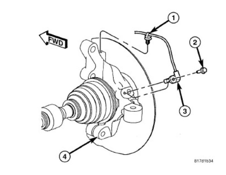

8. Remove the mounting screw (2) fastening the wheel speed sensor head (3) to the knuckle (4). Pull the sensor head out of the knuckle.
NOTE: In the following step, the routing clip can be easily removed without damaging it by rotating it (with entire sensor) counterclockwise.
9. Remove the routing clip (1) securing wheel speed sensor cable to the knuckle (4). Remove the sensor from the vehicle.
