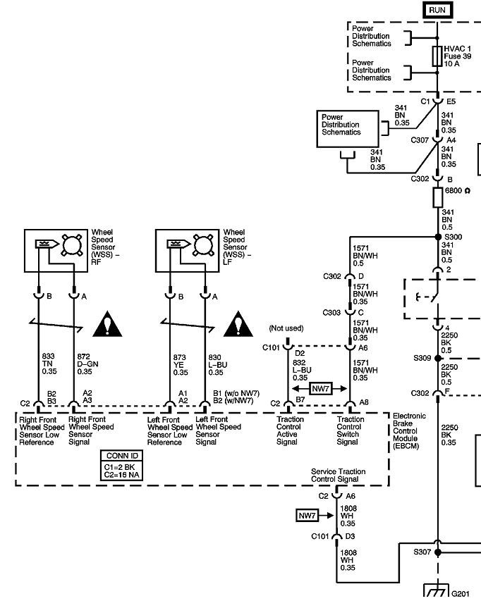

Had the ABS code read at a part store and they claimed that the code said that there was no wheel speed signal. So I replaced the sensor for it. Two years ago this hub/bearing assembly was replaced and I assume a sensor came with it. Any ideas?
Jun 25, 2019 at 4:30 AM
CARADIODOC
  • 34,381 POSTS

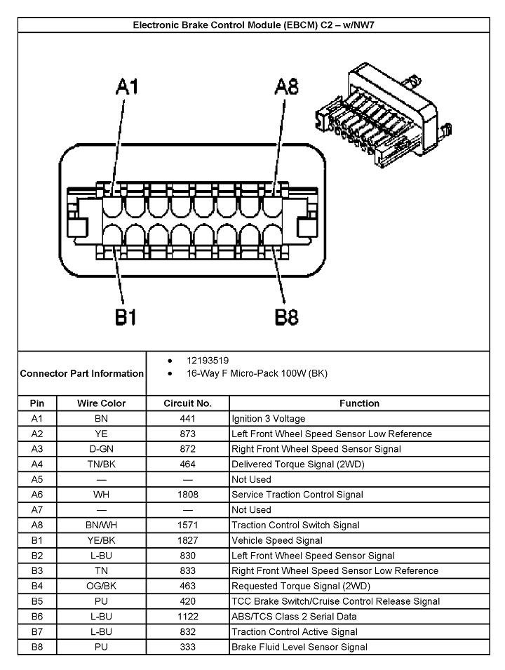

If you read the fault code properly, you'll see they never say to replace a part or that one is bad. Fault codes only indicate the circuit or system that needs further diagnosis. When a part is referenced in a fault code, it is actually the cause of that code about half of the time, but in this case, a more common cause is rust build-up under the sensor. That rust pushes the sensor away from the tone ring. That reduces the strength of the signal to the point the computer can't read it.

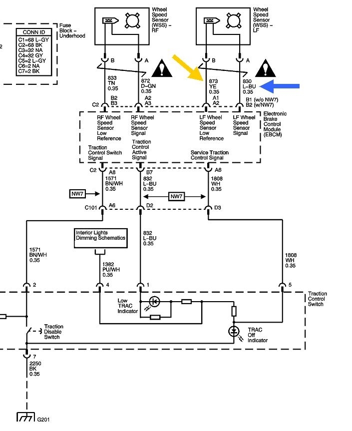

I agree it's not likely a sensor will fail in two years. A better suspect would be corrosion on connector terminals, or a damaged flexible cable going to the sensor. The best way to tell is to start with a continuity check of the entire circuit, right from the computer connector.

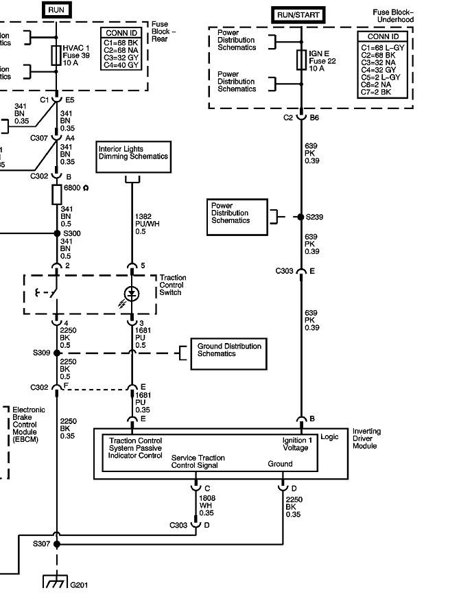

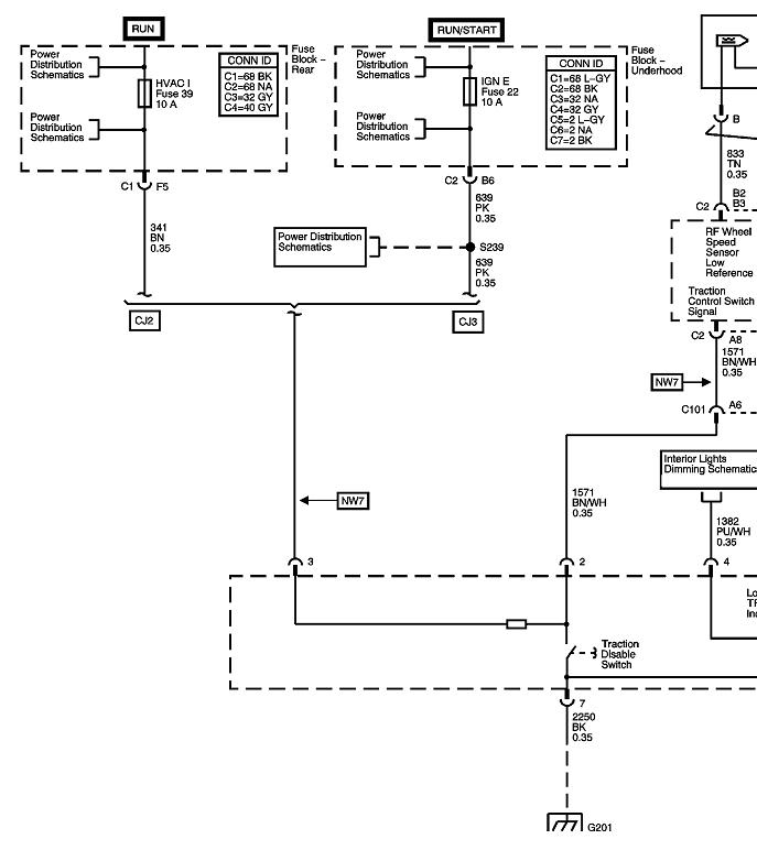

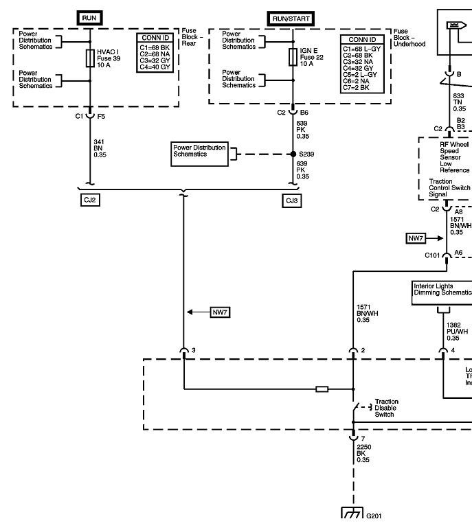

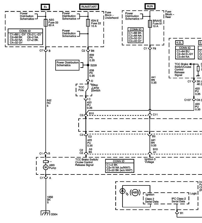

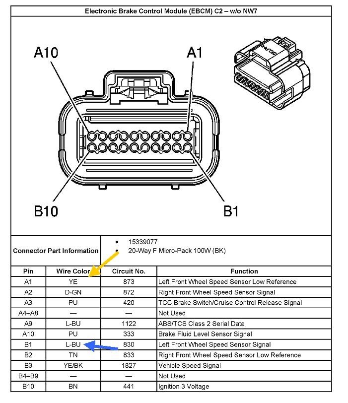

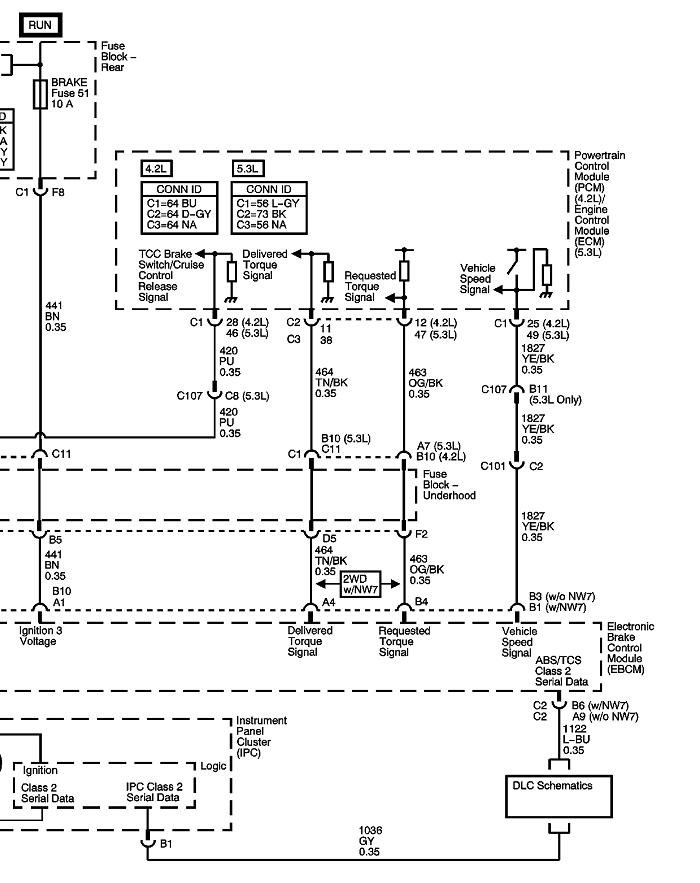

There's really only three diagrams for this system. I cut each one in half so I could resize them to make them easier to read. The computer is listed as "on the inner left frame rail, adjacent to the transmission".
Sensors of this type typically have around 350 - 800 ohms of resistance. What you're looking for during the continuity test is you don't want to find an open circuit or really high resistance, or shorted or really low resistance. Where many of us overlook a problem is we forget to measure each wire to ground. The sensor circuit could read correctly, but if one of the wires has rubbed through and is touching the body, that can short out the signal voltage. You should find an open circuit between each wire and ground.
If all the continuity checks are okay, suspect rust under the sensor. You might try reading an AC voltage between the yellow and light blue wires while a helper spins the left front wheel by hand, but the only value in this is to show if you have something or nothing. The signal is somewhat of a square wave at roughly 45 hertz at one revolution per second. Digital voltmeters are only accurate with sine waves at 60 hertz. The point of this test is if there is no voltage developed, that verifies what the fault code is saying. If you see a low voltage, as in 0.30 volts or less, suspect that rust is causing a weak signal to be generated, and it's too low for the computer to read.

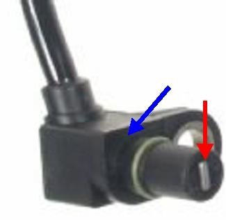

I'm confused by "clean sheet of metal". Where the sensor develops this problem of "false activation" is with those that are bolted to the wheel bearing assembly. If you have the style that is a large 2 1/2" or 3"-diameter ring pressed onto the back of the bearing, that is different and not related to this problem. Your vehicle uses the one that develops this problem, as shown in the photo.
Any time you want to generate current in a generator, or a signal voltage with a sensor, you need three things. You need a wire, (coil of wire is much more efficient), a magnet, or electromagnet, and most importantly, movement between them. That's why generators need to be spun. As far as wheel speed sensors, your sensor has the magnet built in, and the coil of wire wound around it. The last thing is the wheel has to be rotating, and the faster it does that, the higher the voltage will be of the signal it develops. On the other hand, the slower the wheel rotates, the lower will be the signal voltage. The movement in this case is the magnetic field is disturbed, or moved, as a tooth on the tone ring moves past the magnet.
At 0 mph there will be no signal voltage developed. Most manufacturers program their Anti-lock Brake Computers to stop operating below about 3 - 15 mph, specifically to prevent this false activation. GM's wheel speed sensors are well-known to develop real weak signals to start with, then, anything that causes that signal to become weaker will lead to false activation, meaning the computer modulates brake pressure to the wheel it thinks has locked up, when it really hasn't. The wheel speed signal gets weaker and weaker as speed slows down, until it becomes too weak for the computer to be able to read it. That's why it falsely thinks the wheel has locked up.
The rust that builds up under these sensors is in the area of my nifty blue arrow. The rust pushes the sensor away from the toothed tone ring inside the bearing assembly. If that is what you cleaned already, can I assume you looked at the sensor and the mounting pad on the bearing? The next thing, which is often overlooked, is rust or metal filings on the tip of the sensor's magnet. My red arrow is pointing to that. The magnet needs to be clean, but be careful to not use a file or coarse sandpaper. Those will remove part of the end of the magnet and make the air gap bigger. That moves the magnetic field away from the toothed ring that is intended to disturb that field as the teeth pass by it.
If you suspect the magnet may have already been cleaned in a way that increased the air gap, consider shaving off 1/32" of the plastic housing so the sensor will sit in the hole a little deeper. 1/32" will make a big difference in the strength of the signal.
