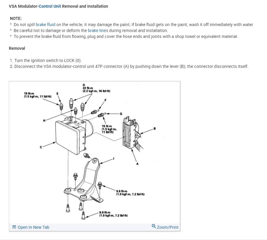

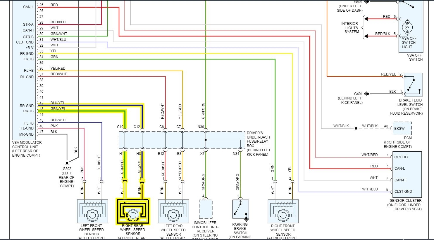

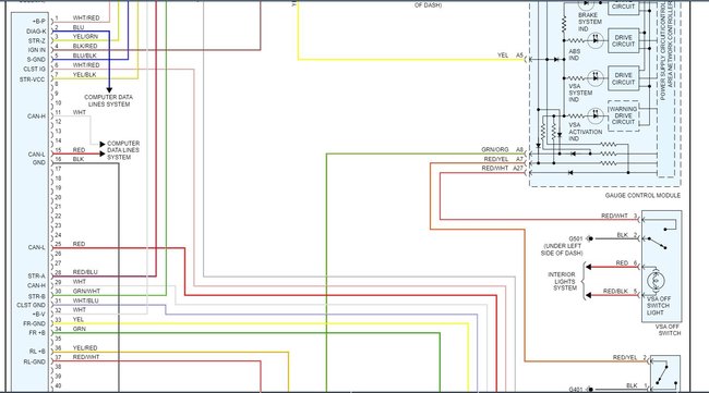

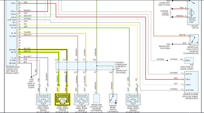

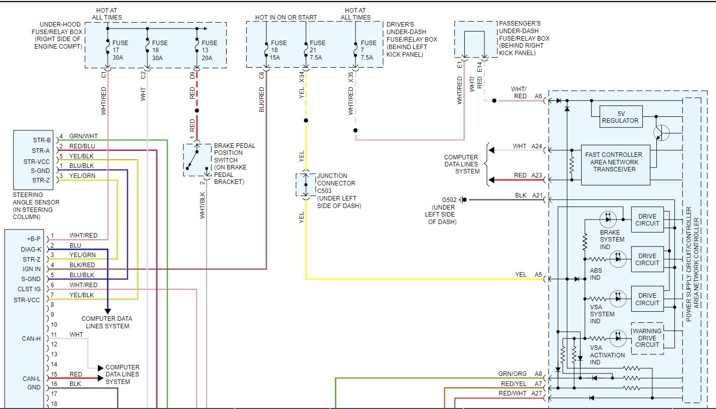

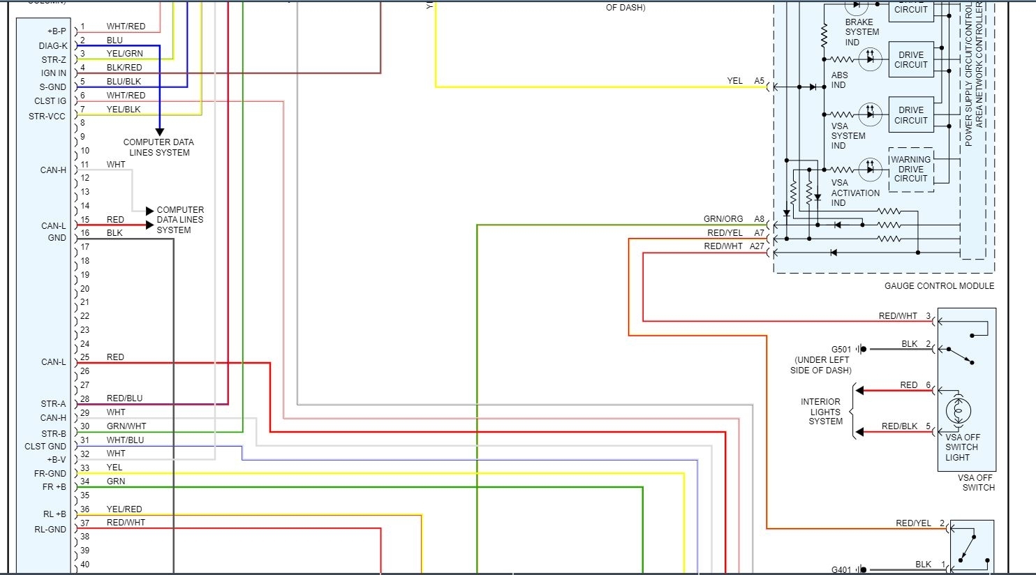

Rear ABS harness left side have power, but right side no power. Where should I check? the fuse looks good. Do they have relay on ABS system?
Mar 12, 2022 at 5:09 AM
Good morning,

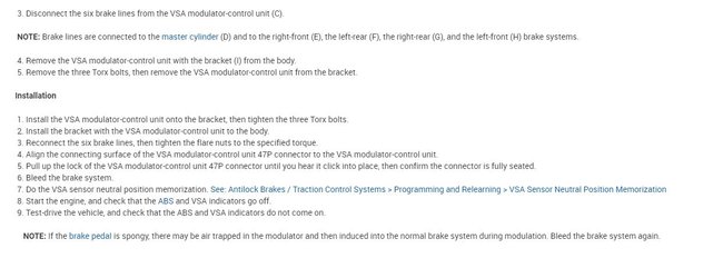

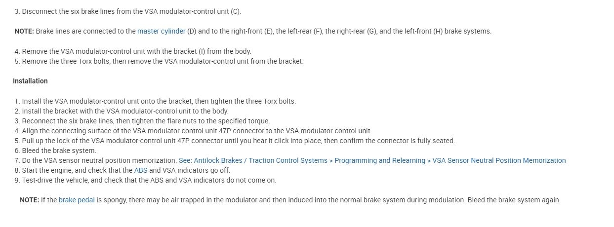

I attached the wiring diagram for you to view. You need to test the wire for voltage coming out of the module to determine if it is a wiring issue or a module issue.
https://www.2carpros.com/articles/abs-wheel-speed-sensor-test
https://www.2carpros.com/articles/how-to-replace-a-abs-controller
