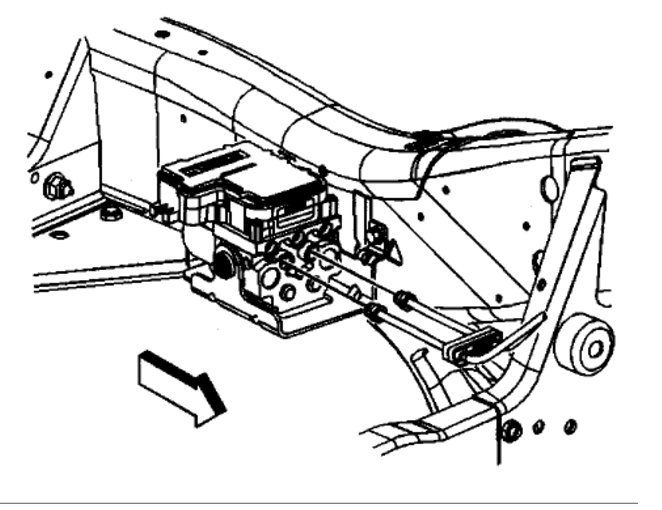

What could be the reason why my ABS light is on? I had three different things come up. Speed sensor, module and ABS pump. I am confused. Do I have to go to the dealer to find out why it is on?

It sounds like you have a module that is out Here is a guide that will give you an idea on what you will need to do to replace it, they have them on Amazon, $190.00. Here is the guide:
https://www.2carpros.com/articles/how-to-replace-a-abs-controller

OK but when I got the code it came up c0110 if I remember correctly. And that was for the pump so what should I do
Saturday, February 27th, 2021 AT 1:37 PM
KEN L
  • MASTER CERTIFIED MECHANIC
  • 48,323 POSTS
Yep that is a pump code,

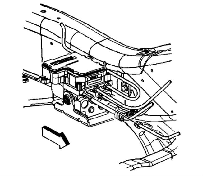

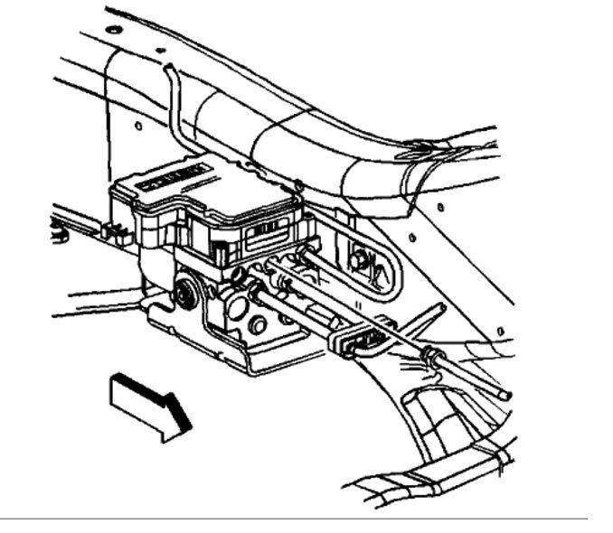

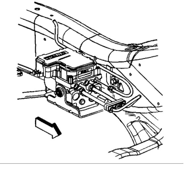

Here are some diagrams to help you get it changed out.
Make sure you use a line wrench
https://youtu.be/HNlvgp_YfQ0
