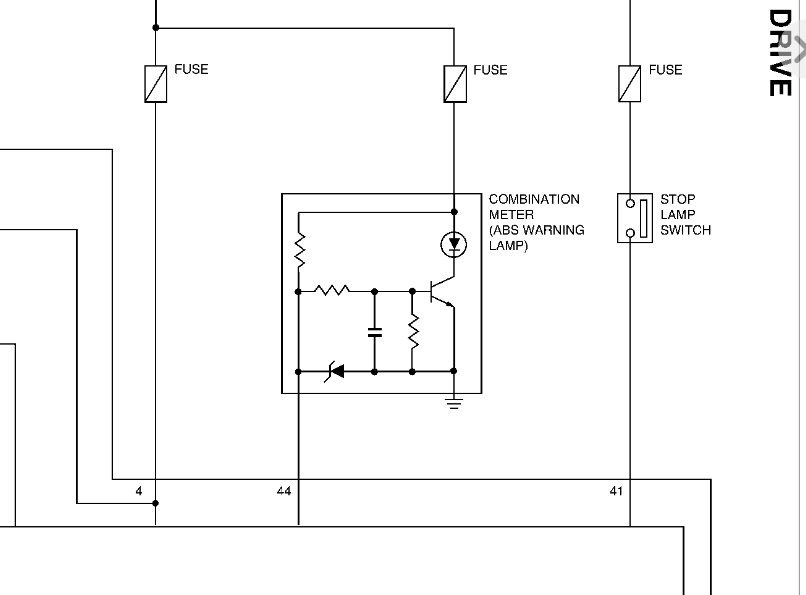

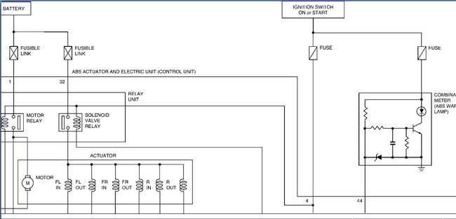

Hello Roy,I found a diagram of the t39 connector that goes to the abs module,I checked pin 44 to ground and it only has 7.5 volts,the wire is a solid blue with a white stripe,I just have to find out where the other end is,any suggestions,thanks Henry(sorry to bother you)
Mar 12, 2018 at 4:21 AM (Merged)
Hi, you never bother me.
Let me get a diagram for you
Three powers to the module. check for battery voltage to all three pins.

Hello Roy,seems as though it is the ABS module. I have all three voltages there,I have to see what I am going to do now. Thanks

I wanted to update you on this issue. I located and bought a used module and installed, (I did not flash the module). still the same issue, light will not go out. I bought the Bluedriver OBD2 and it says no pending ABS codes. I tried clearing the light with this unit still no good.
Do you know where pin 44 connects to? I figured I would track that down to another connector because it only has 7.4 volts. any other suggestions? thanks, Henry
Apr 6, 2018 at 3:20 AM (Merged)
Good morning.
Let me check.
Apr 6, 2018 at 3:36 AM
Goes to the ABS light in the cluster.
The light may be on from the flash not being done as well.
Apr 6, 2018 at 3:42 AM
