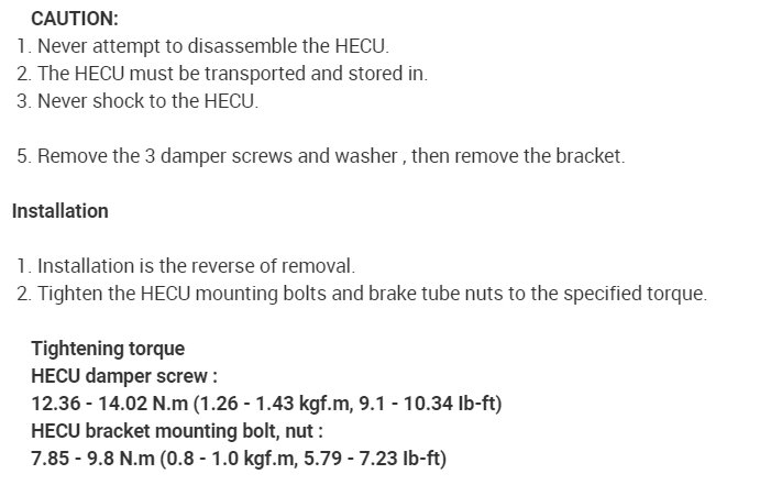

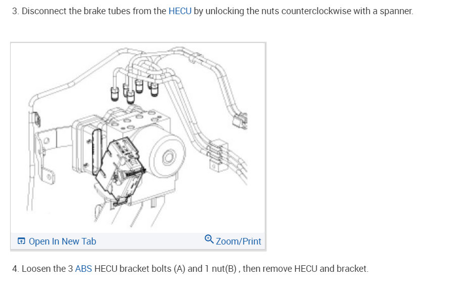

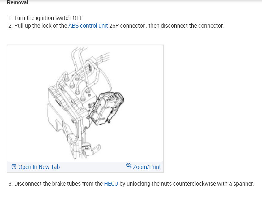

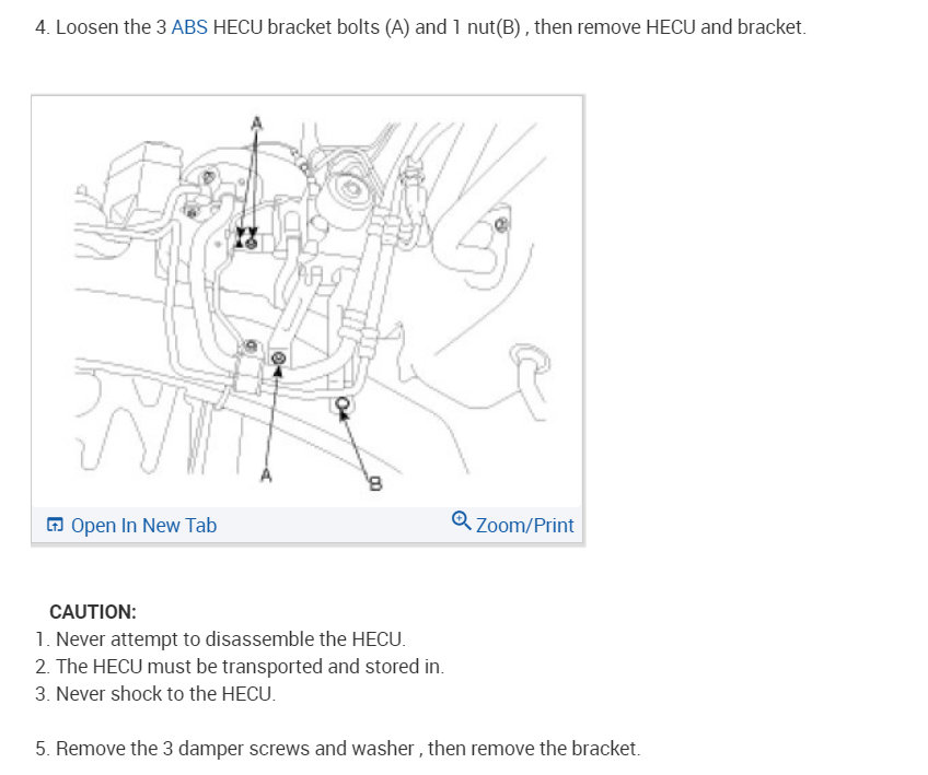

This only leaves the ASB controller being bad. Here is how you can change it out with a new unit in the diagrams below. Check out the diagrams (below). Please let us know what you find.

Yes, the controller is giving you an error even though there is none, so the warning portion of the controller is bad, the labor time to change it out is .6 hours.
