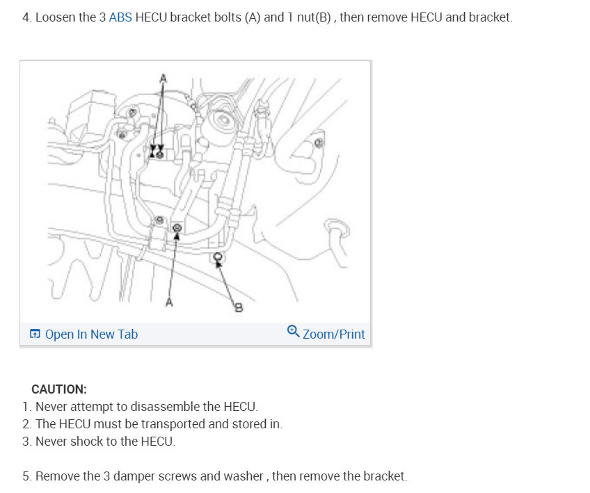

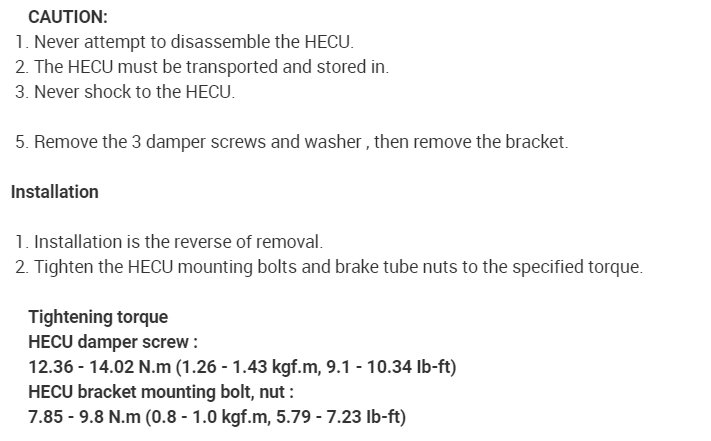

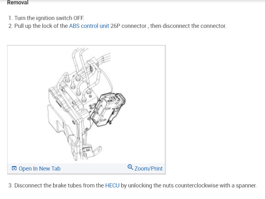

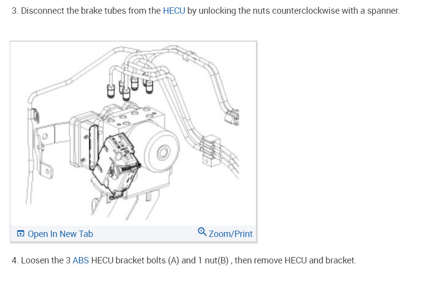

This only leaves the ASB controller being bad. Here is how you can change it out with a new unit in the diagrams below. Check out the diagrams (below). Please let us know what you find.

So even though the ABS was tested recently while it was being driven with a scanner connected to it, and it was working, it is still the ABS controller which is bad that is showing the ABS light? This is the part I am confused about.
If I was able to source the correct part, how much would you charge for the labor of replacing it?
Jun 9, 2022 at 6:36 AM
  • 54,837 POSTS
Yes, the controller is giving you an error even though there is none, so the warning portion of the controller is bad, the labor time to change it out is .6 hours.
