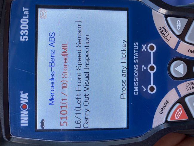

My ABS light came on and the code on screen was right ABS sensor which I changed. The light went off but after 20 minutes of driving, light come up again . Any idea what is the problem?

Was it for the same sensor? Also, what specific code was it? Was the wiring properly routed and not damaged? Let me know so I can do a little research.

Thanks a lot for prompt answer. The code was 5101 and the connection looks well. I have a plan to do some diagnostic on new sensor, but I have problem removing old sensor and insertion of new sensor as well. Is there a possibility of overheating brake system to damage sensor?

And yes was the same sensor and initially work and light turns off but it came on again after 20-30 minutes of driving!
