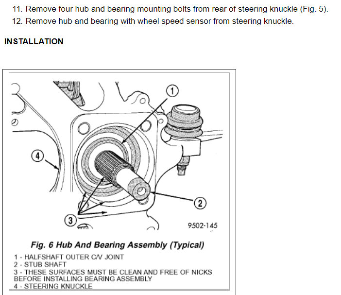

I was told by the car dealer that the reason that the ABS light would flash on and off was because a wheel bearing in the right front wheel was going out. But the other day when my wife was driving home from work the lights went out for about 2sec. I was wondering IF the ABS light would flash on and off because of that and also if the malfunction switch would give the same problems or not.

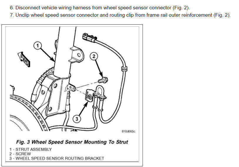

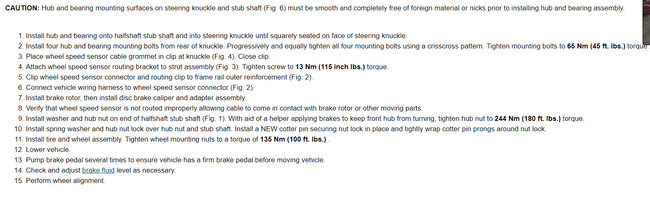

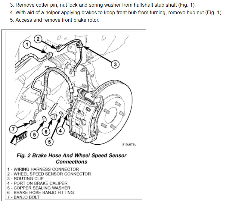

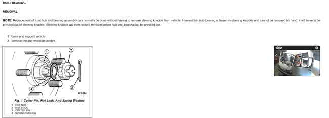

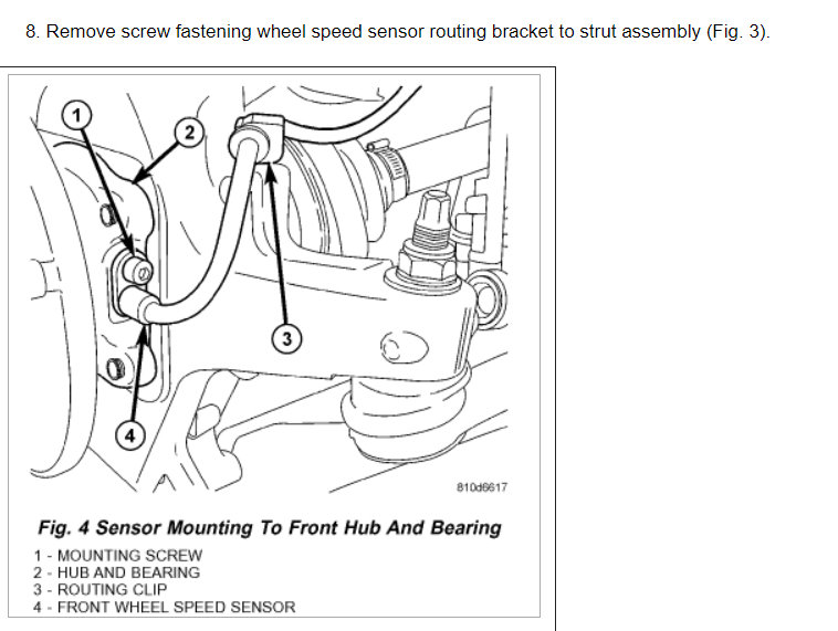

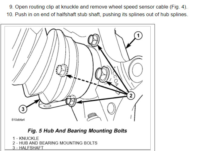

Yes the axle bearing can cause the ABS light to flicker as the sensor cannot follow the wheel speed. Here is a guide to tell let you see what you are in for when doing the job.
https://www.2carpros.com/articles/bearing-hub-replacement
and
https://www.2carpros.com/articles/abs-warning-light-on-easy-repair-guide
Here is how it will be for your car check out the diagrams (Below) Please let us know if you need anything else to get the problem fixed.
