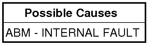

If you take a look through this description, it will better explain what I am saying. It is actually the diagnostics for the code you provided. I have to be honest, there is a 99.9% chance the module needs replaced.
___________________________
2008 Jeep Truck Wrangler 4WD V6-3.8L
ABS
Vehicle ALL Diagnostic Trouble Codes ( DTC ) Testing and Inspection C Code Charts C2200 ABS
ABS
C2200-ANTI-LOCK BRAKE MODULE INTERNAL
For a complete wiring diagram Refer to Diagrams/Electrical.
- When Monitored:
Ignition on. The Anti-Lock Brake Module monitors its internal microprocessors for correct operation.
- Set Condition:
If the Anti-lock brake module detects an internal fault, the DTC is set.
pic 1
Diagnostic Test
1. ABM INTERNAL FAILURE DTC PRESENT
Turn the ignition on.
With the scan tool, read DTCs.
With the scan tool, erase DTCs.
Turn the ignition off.
Does the scan tool display ANTI-LOCK BRAKE MODULE INTERNAL FAILURE?
- Replace the Anti-Lock Brake Module.
- Perform ABS VERIFICATION TEST. See: A L L Diagnostic Trouble Codes ( DTC ) > Verification Tests > ABS Verification Test.
- Perform the ABS Intermittent Condition diagnostic procedure.
- Refer to the ABS-INTERMITTENT CONDITION TEST. See: Antilock Brakes / Traction Control Systems > Component Tests and General Diagnostics > ABS Intermittent Condition Test

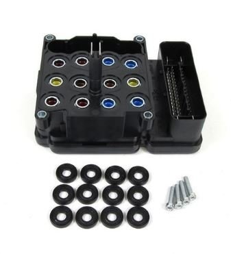

Thanks Joe, I would like to ask another question if you don't mind. Is it safe for the Jeep to have the module replaced by myself as long as I do it right of course? I know that if I hand it over to the dealership they will probably require me to pay a ridiculously high amount of money for this, I saw a YouTube video of a guy replacing a module and it seems quite simple. the guy said he would then have the Jeep taken to the dealership for them to reprogram it, which would cost him a lot less than having the dealership doing the whole thing.
So, can I do it myself?
Thanks again.
Feb 10, 2020 at 10:59 AM
STEVE W.
  • 15,421 POSTS
Replacement of just the electronics is easy, the hard part is finding the correct part. Mopar # 68030936AB is just the control module mounted on the control block. Last I checked they run about $275.00 to $300.00 for new. Replacement is disconnect unit, remove 4 screws, remove the unit from the ABS control block, Replace the O-rings and reverse the process to install the new one. Reconnect and get it programmed. The hardest part is getting the unit out of the bracket.
Pretty good video on it.
https://www.youtube.com/watch?v=_ZP_kyLAozI
