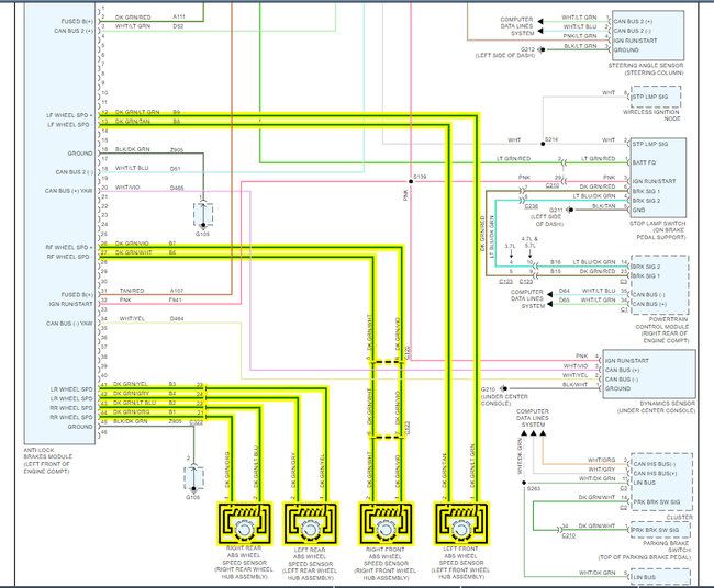

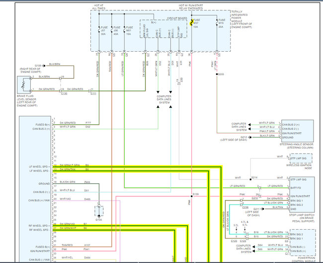

Which wiring was repaired? The wires are so small for this system that repairing the wiring is extremely difficult.
https://www.2carpros.com/articles/abs-wheel-speed-sensor-test
I attached a wiring diagram for you to view the system. I also attached a guide for the testing. What you need is a scan tool that can read the wheel speed of all the wheels to be sure that all the wheels are sending the correct signals.

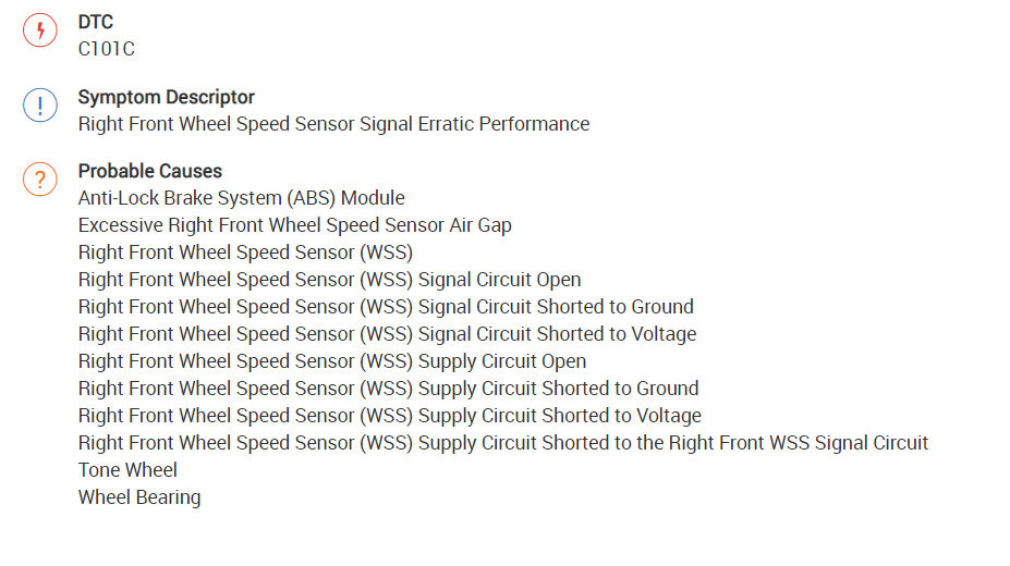

Here's the info I got from a scanner:
Dodge ABS
C101C (1/3) Stored
Right front wheel speed sensor signal erratic performance.
Oct 30, 2021 at 3:50 AM

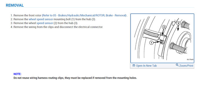

This indicates a wheel speed sensor issue. I attached the possibilities for you, but the most common problem is the sensor itself.
https://www.2carpros.com/articles/how-to-replace-an-abs-wheel-speed-sensor
