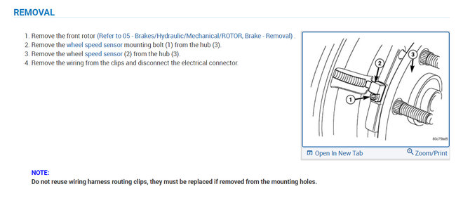

https://www.2carpros.com/articles/abs-warning-light-on-easy-repair-guide

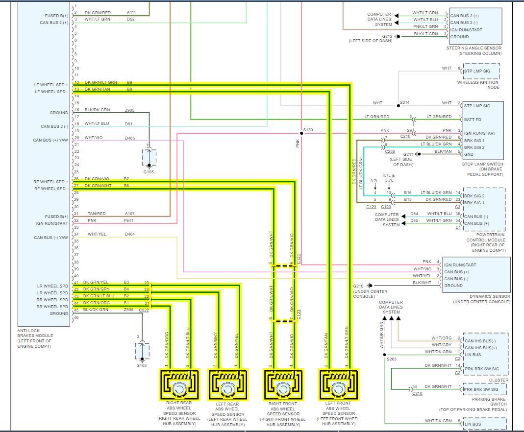

Which wiring was repaired? The wires are so small for this system that repairing the wiring is extremely difficult.
https://www.2carpros.com/articles/abs-wheel-speed-sensor-test

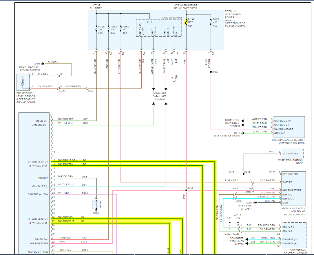

I attached a wiring diagram for you to view the system. I also attached a guide for the testing. What you need is a scan tool that can read the wheel speed of all the wheels to be sure that all the wheels are sending the correct signals.

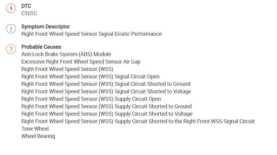

Here's the info I got from a scanner:
Dodge ABS
C101C (1/3) Stored
Right front wheel speed sensor signal erratic performance.
Oct 30, 2021 at 3:50 AM
This indicates a wheel speed sensor issue. I attached the possibilities for you, but the most common problem is the sensor itself.

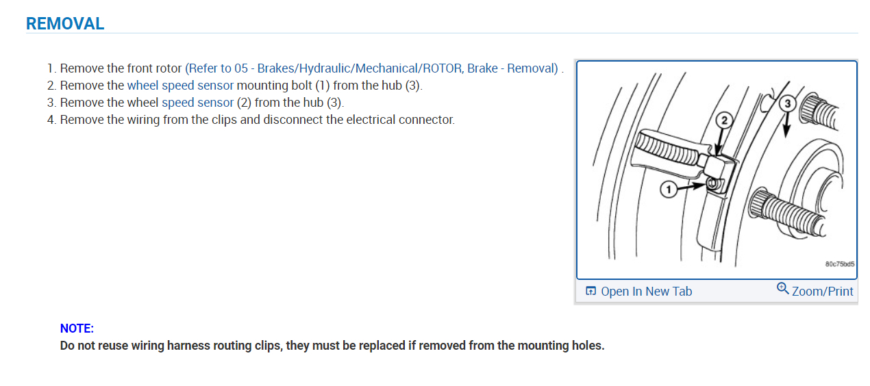

https://www.2carpros.com/articles/how-to-replace-an-abs-wheel-speed-sensor

I had the wheel speed sensor replaced twice. Would you agree that it may be wiring issue? If so, can the wiring be replaced? Thank you in advance for your continued support.
Oct 31, 2021 at 10:00 PM
It is possible. You need someone with a scan tool that can read the voltage from the sensor while the truck is moving. That will confirm if it is the wiring.
Yes, the harness can be replaced.
