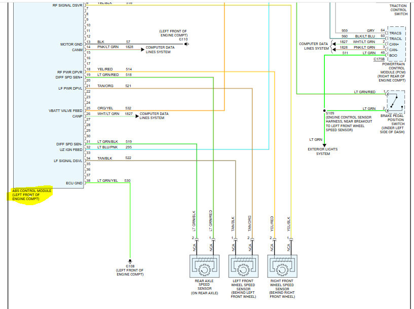

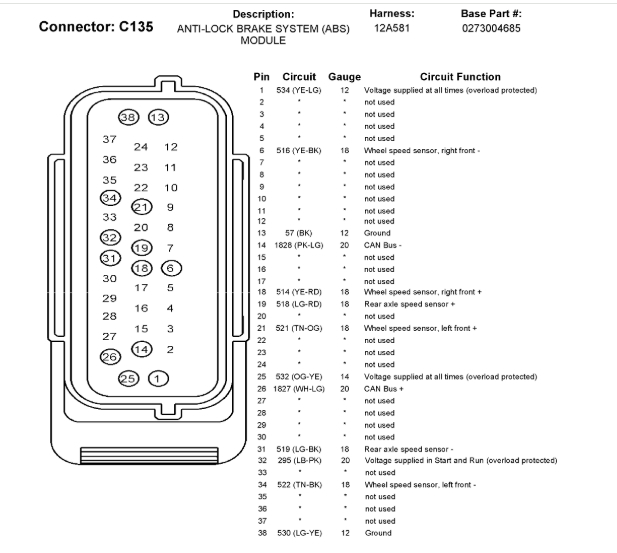

Looking for a pin out for the ABS connector to check power and ground.

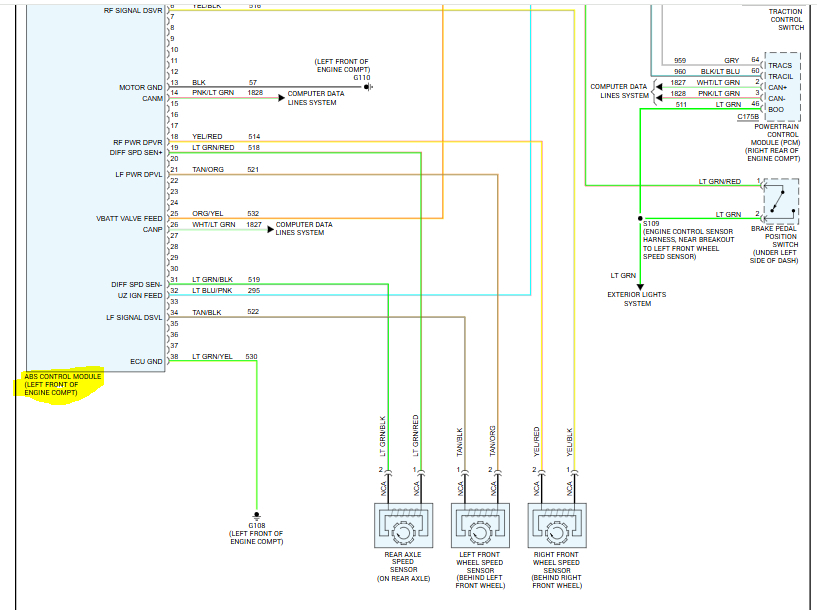

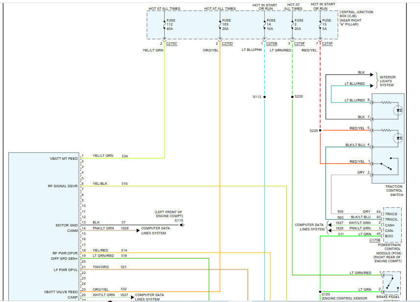

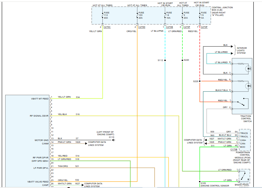

If you look below, I attached the wiring schematic as well as the connector pinout. When you check things, make sure there isn't a cracked connector pin. I chased a similar issue for way too long. LOL
I hope this helps.
See pics below. Note, I had to cut the schematic in two, so it was readable. I did overlap the two so you can follow from one to the next.

Sorry for the slow reply but I only get weekends to work on this truck. Got 2 ohms resistance on the grounds and good voltage at the power supply and pin 32 with key in run. Any other test I can use to prove the ABS module is bad before I replace it.
