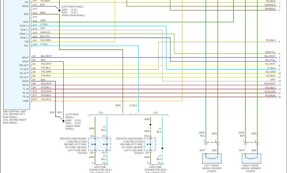

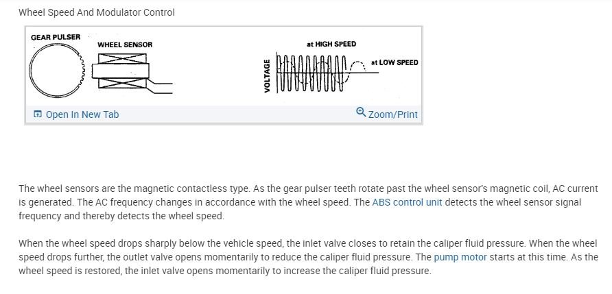

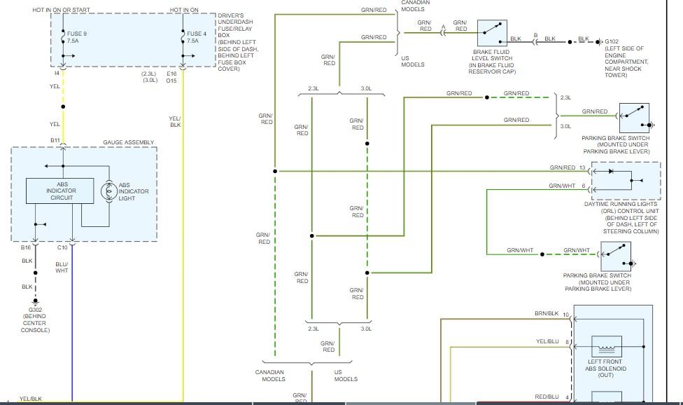

The brakes are working perfectly, but the ABS light is on always.
Feb 14, 2020 at 8:56 PM
Good morning,

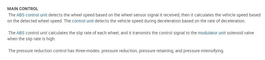

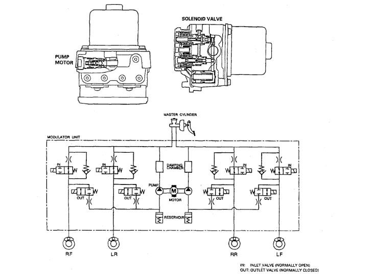

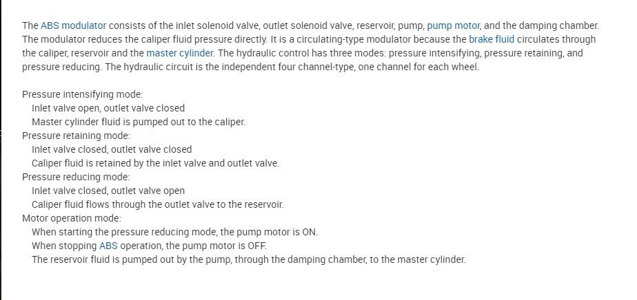

The system is for stopping safely in the event of a sudden stop. The wheels will not lock up if the system is working correctly.

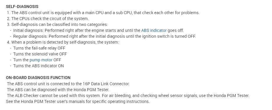

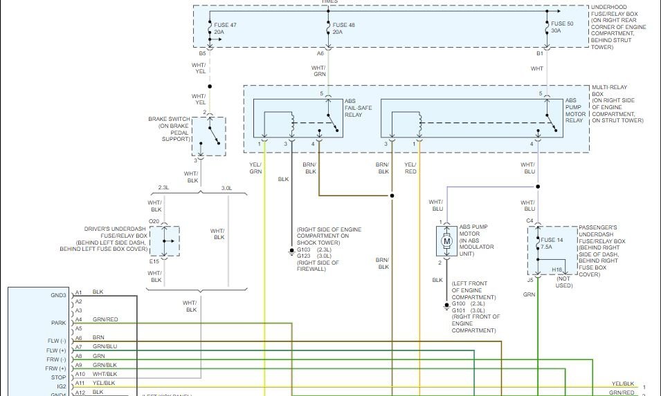

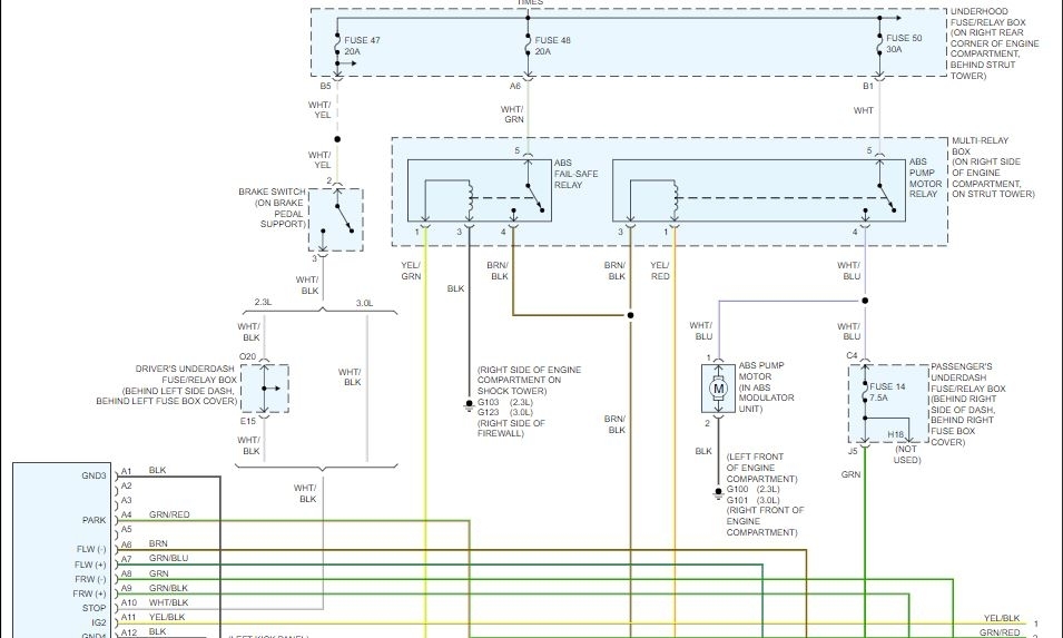

When there is a fault, the light comes on and the system is off line.

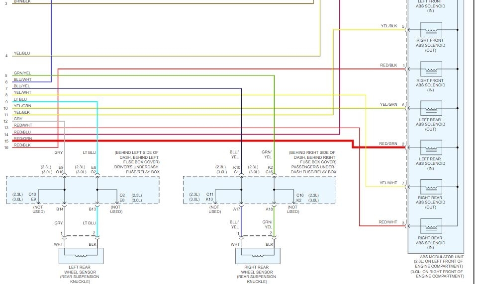

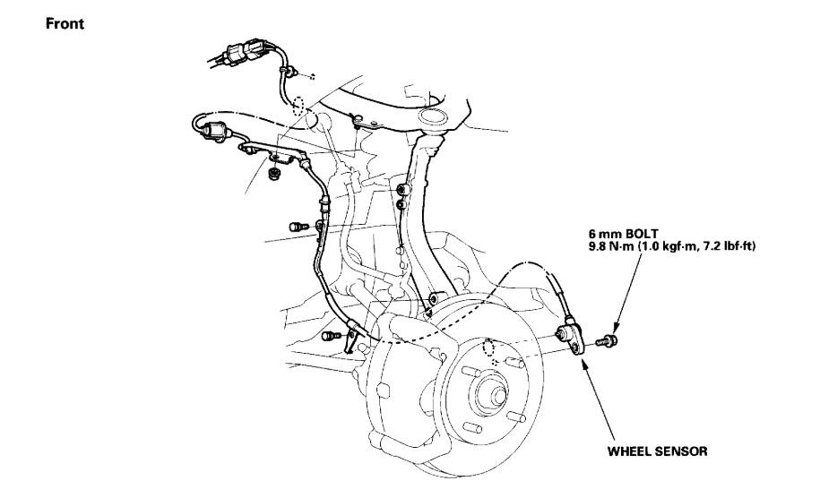

There is a fault code stored and I need that code to narrow the area of failure for you.

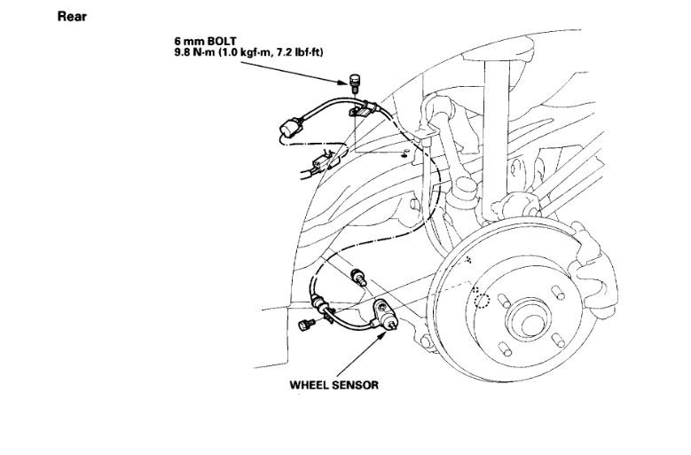

A wheel speed sensor is the most common failure but needs to be confirmed.
