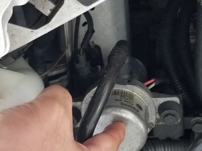

Also, check your vacuum pump. That supplies vacuum to the booster. With key on pump the brake pedal. Motor should come on. If it does not check fuses. If fuse is blown that will trigger the check engine light on for all oxygen sensors.
If fuse is good replace the motor. Very common for that part to fail. Let us know what you find and let us know about the codes.
Feb 8, 2017 at 2:57 AM
JIS001
  • 3,412 POSTS
Forgot to add, if fuse is blown replace the vacuum pump motor. They seize up and cause the duse to blow also.
