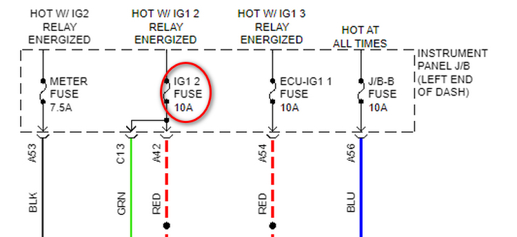

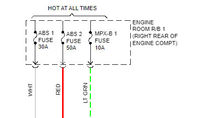

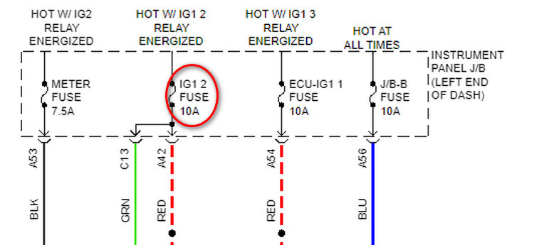

I'm trying to find the ABS fuse sir.
Sep 8, 2022 at 3:28 AM
BORIS K
Experienced Mechanic
836 POSTS
There are 3 fuses for the ABS module.
2 in the engine room fuse block, ABS fuse 1+2.
The third fuse is located in the dash panel fuse block, fuse IG1 2.
See images below.
