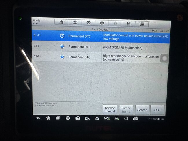

Battery drained because i forgot a light on. Jumped it and now its running fine but traction and ABS lights are on.

So you have codes: So I would replace the left front wheel speed sensor, then use your scanner and clear the codes. The first to codes are because the battery was low.
6111 - VSA/ABS modulator control unit power source (IG) low voltage
8311 - PCM (Powertrain Control Module) malfunction / VSA stoppage due to a fault in PGM-FI or engine control
2311 - front left wheel sensor issues
. Please let us know what happens.
