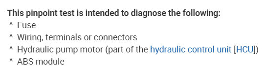

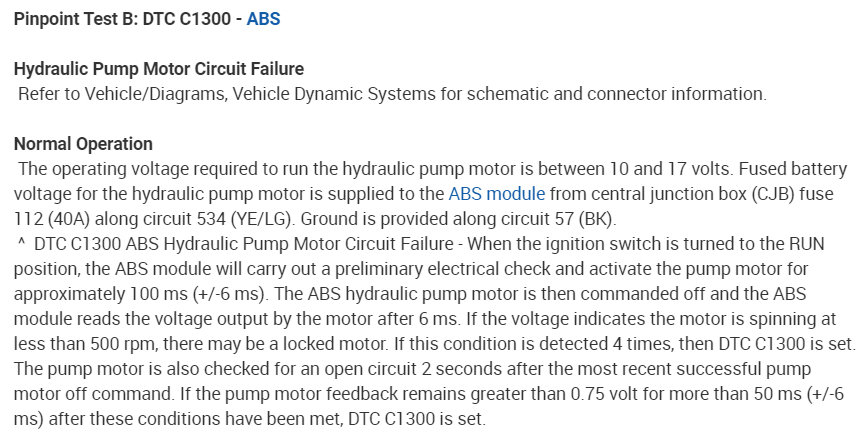

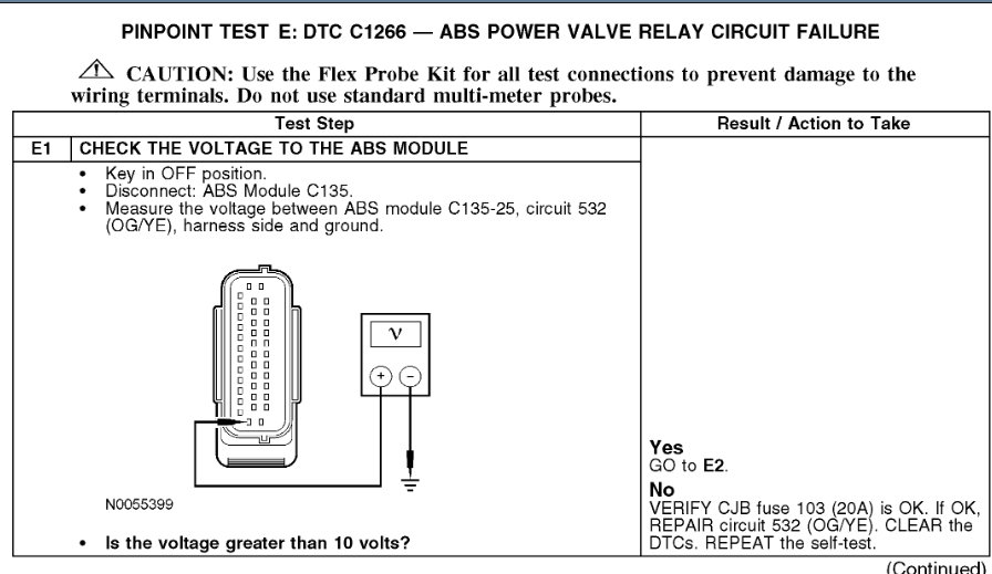

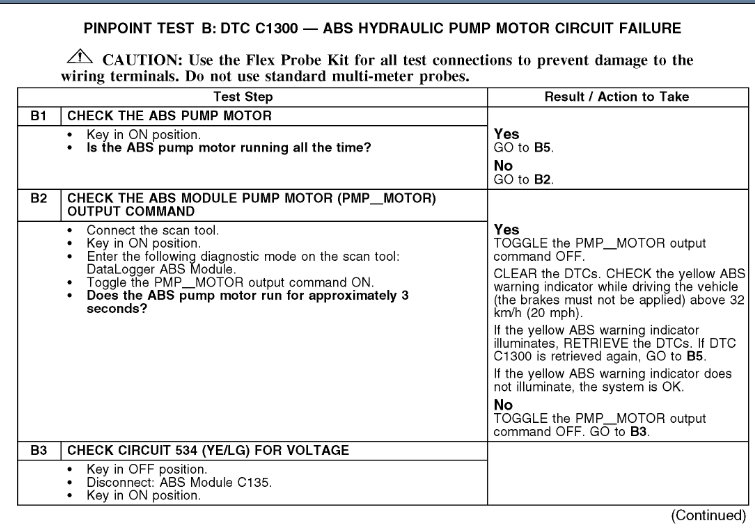

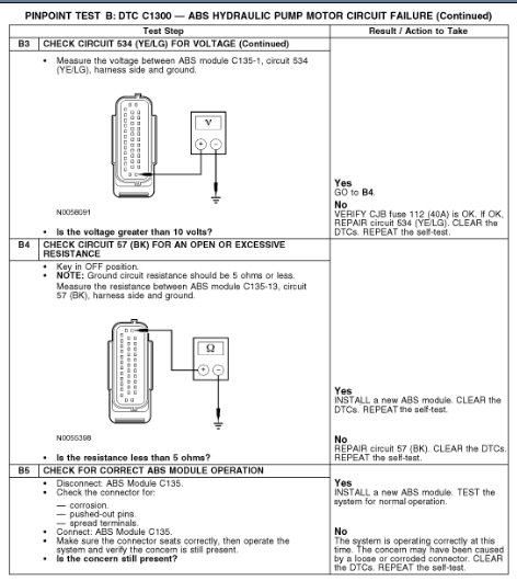

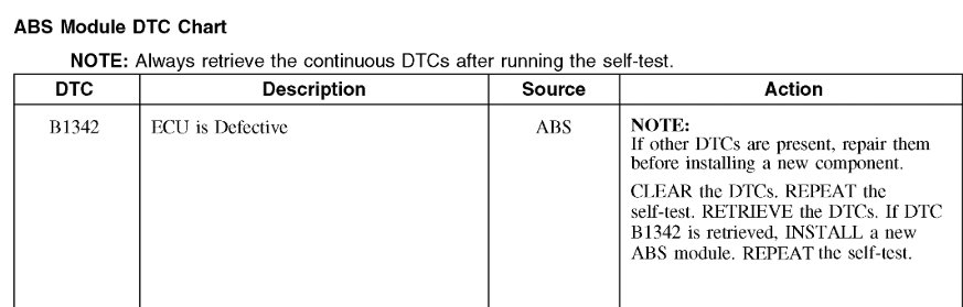

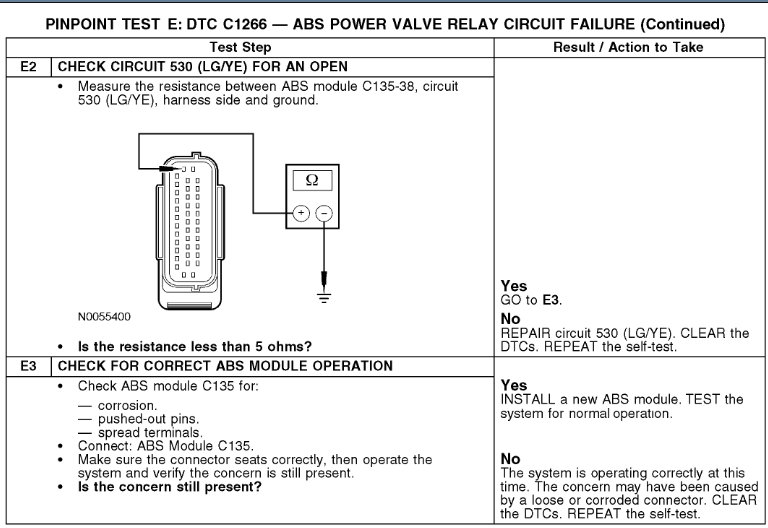

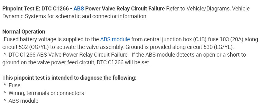

I have these three codes when I put the computer on the truck; C1266,C1300, and B1342. Which of the codes is related to all three codes and if replaced will clear all the lights on the dashboard? Please help.
Thank you
Aug 2, 2020 at 1:30 PM
DANNY L
  • 5,648 POSTS
Hello, I'm Danny.
I've attached picture diagnostic steps below for your 3 ABS codes that you requested.Hope this helps and thanks for using 2CarPros. Check out the diagrams (Below). Please let us know if you need anything else to get the problem fixed.
