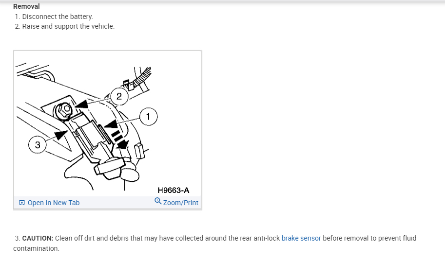

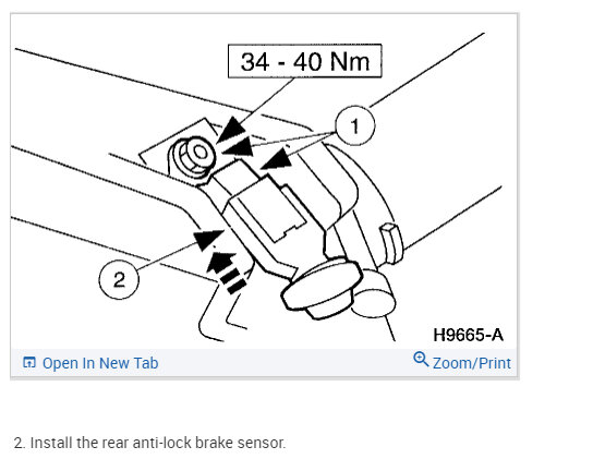

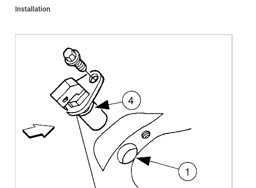

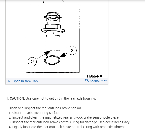

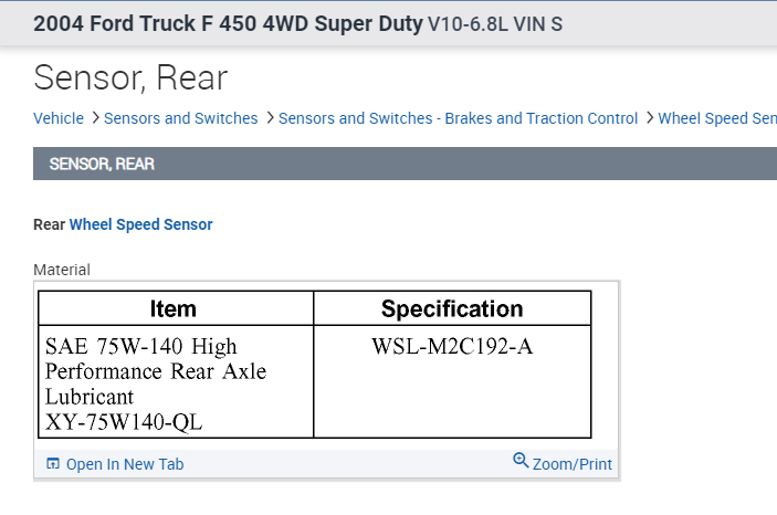

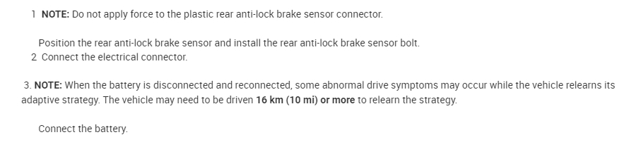

It sounds like a wheel speed sensor (ABS sensor) is failing. The instrument cluster is hardwired to the four-wheel anti-lock brake system (4WABS) module. Data from the 4WABS module commands the speedometer with a corresponding speed.
The vehicle speed signal is generated by the rear anti-lock brake sensor and sent to the 4WABS module. So, I suspect the sensor is failing. However, you could confirm it by using a live data scan tool that can identify what the sensor is indicating.
I attached the directions for replacing the rear sensor below. This is my first suspect, but as mentioned, you can test it if desired.

Thanks. I’ll go ahead and replace it.

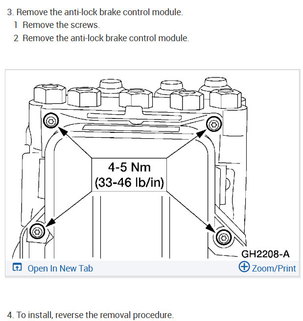

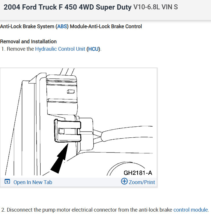

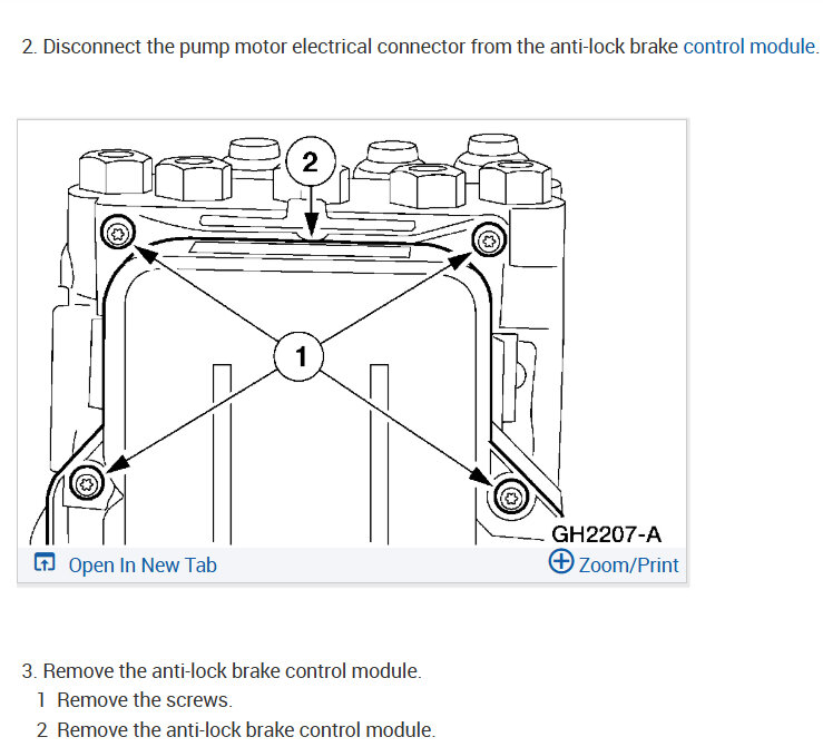

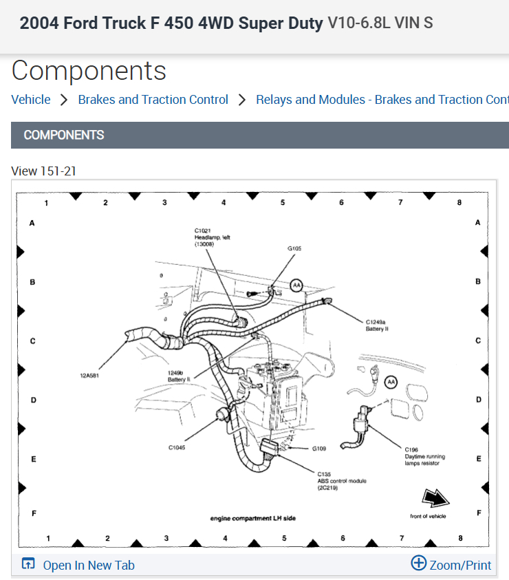

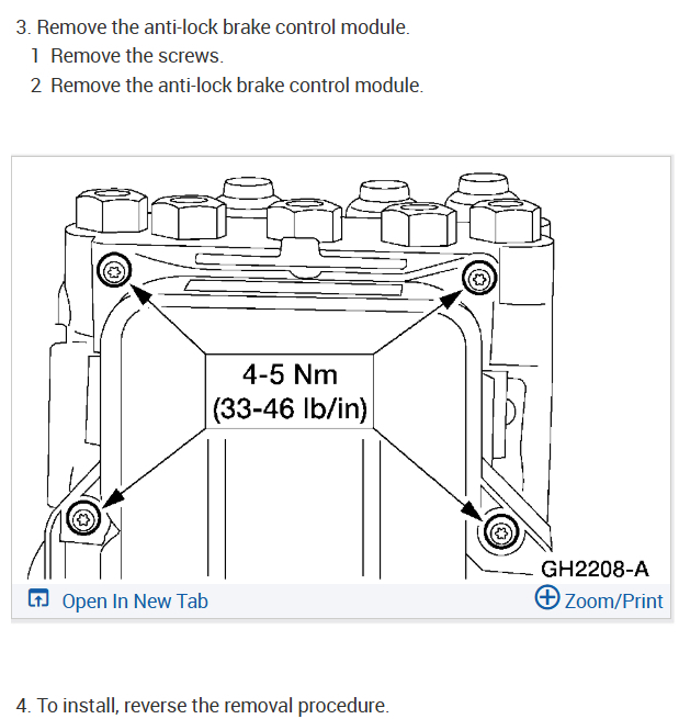

The ABS control module on my 4 x 4 bucket truck with dual rear wheels is no longer functioning. I ran across a ford part #2C3Z-2B373-CA that matches my ABS control module that is discontinued but this part number matches the same year make model but with for single wheel. Will this module work for my vehicle? Also, where is the ABS control module located? Is it on the side of the hydraulic system for the ABS or is it on the firewall driver side? I added a pic. Please let me know if this it
Mar 1, 2025 at 3:51 AM (Merged)
  • 55,214 POSTS
If they have the same part number, you are good to go. Here is the location of the ABS control module and how to change it out. Check out the images (below). Let us know how it goes.
