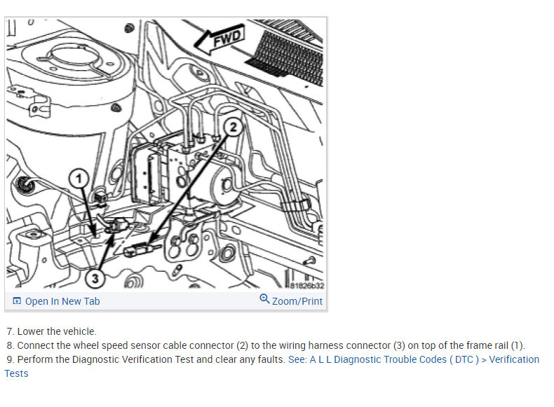

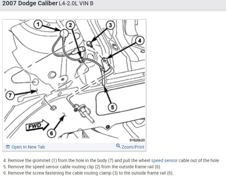

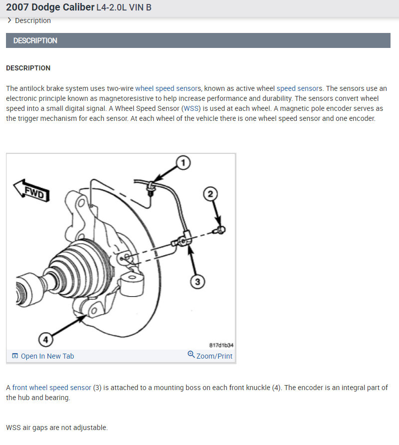

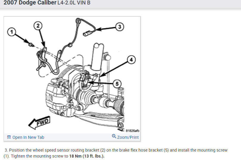

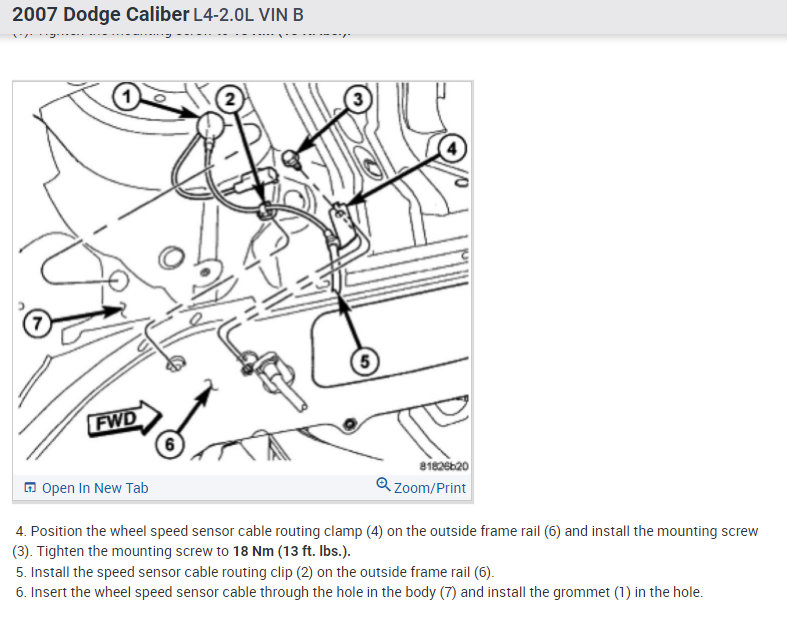

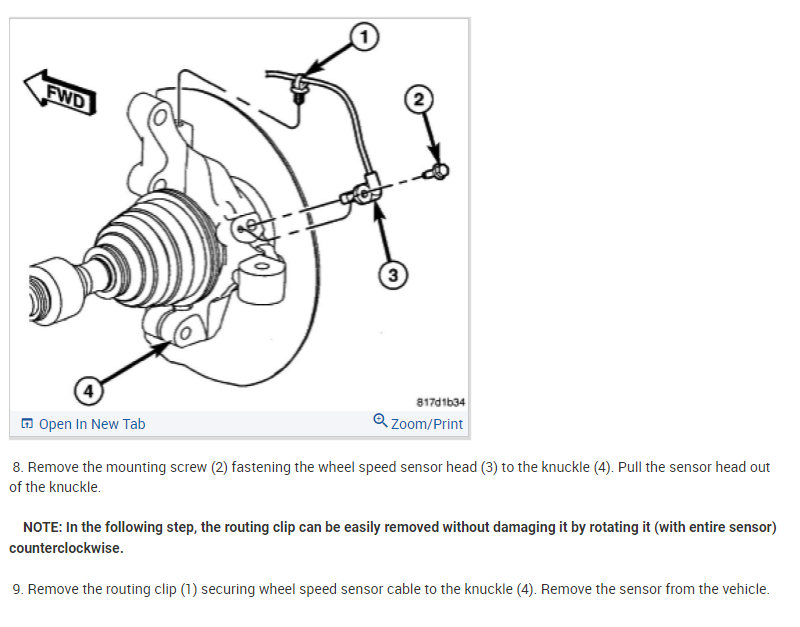

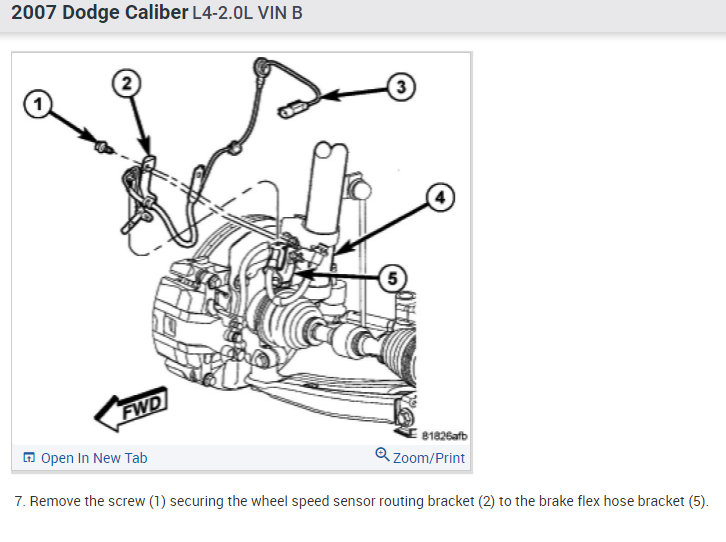

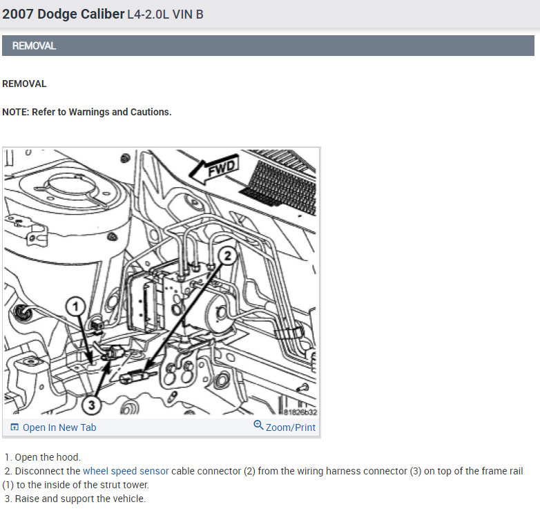

After brake pads were replaced the ABS, light is on. I do not have a tool
ABS capable. Any information where to start or how to disable the light.
Very much appreciated. Brakes operating good but no ABS. Also, I do not hear any noise coming from the actuator, so I don't believe it's working either. Thanks, JC

Since the ABS light was not illuminated before you changed out the brake pads, it is possible that the connect for the ABS light is loose or go knocked off.
For the ABS light to go off, you will first have to repair the issue.
If you are able to scan the ABS module, it will help determine what is the issue the light is illuminated.
https://youtu.be/rTtAnsOlZU4
