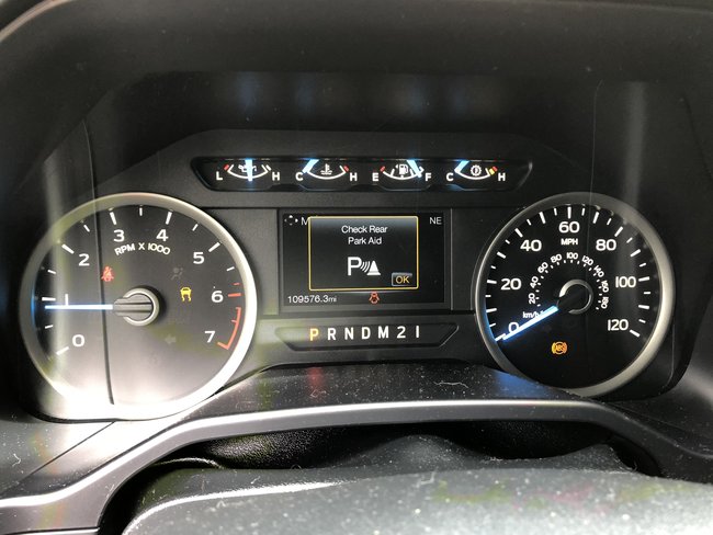

Could this be an issue with possibly damaging the wheel speed sensors
110,000 MILES • 2.7L • V6 • TURBO • 4WD • AUTOMATIC
NHUNTER24
  • 8 POSTS
The truck listed above has an2.7 EcoBoost. I have ABS, hill descent control, Rear Park Aid and AdvanceTrac warning lights and messages on my dash. I just replaced UCA’s and had to remove CV axles in order to do this. Could this be an issue with possibly damaging the wheel speed sensors in the process of messing with the axles? Have you seen this issue before?
Aug 13, 2020 at 3:56 AM
Good afternoon,
The ABS system has stored a fault code. I need that code to direct me to the area of failure.
ABS video https://youtu.be/Pb6nXV-iamI
ABS codes video https://youtu.be/rTtAnsOlZU4
Once the ABS is repaired, all the other systems will come back on line.
Aug 13, 2020 at 5:41 AM
