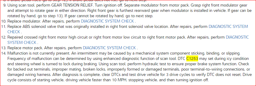

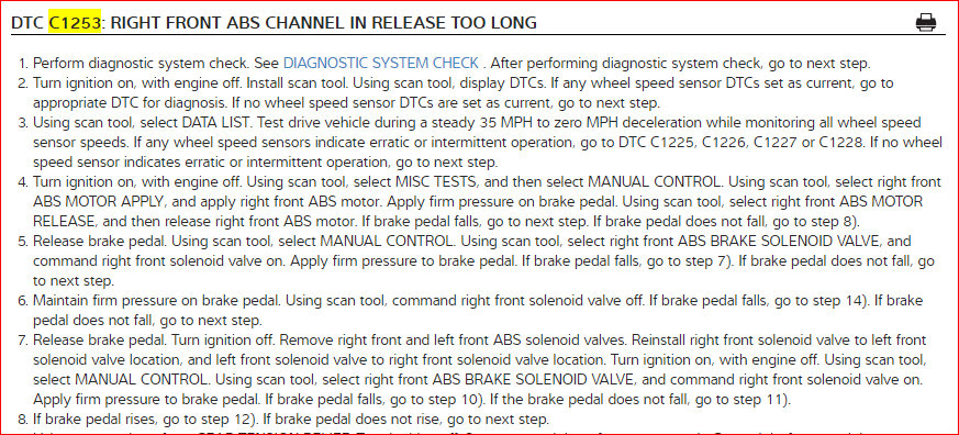

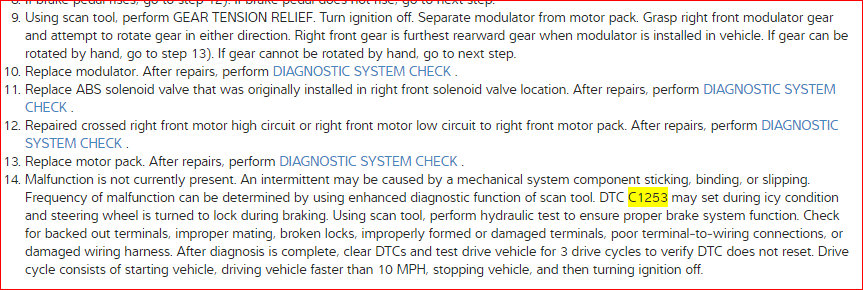

I was able to read the code. C1253:Rf channel input release too long.

I have attached a step-by-step testing picture. For better results you might want to find someone or a shop that has a GM Tech 2 brand scanner. Hope this helps and thanks again for using 2CarPros.
