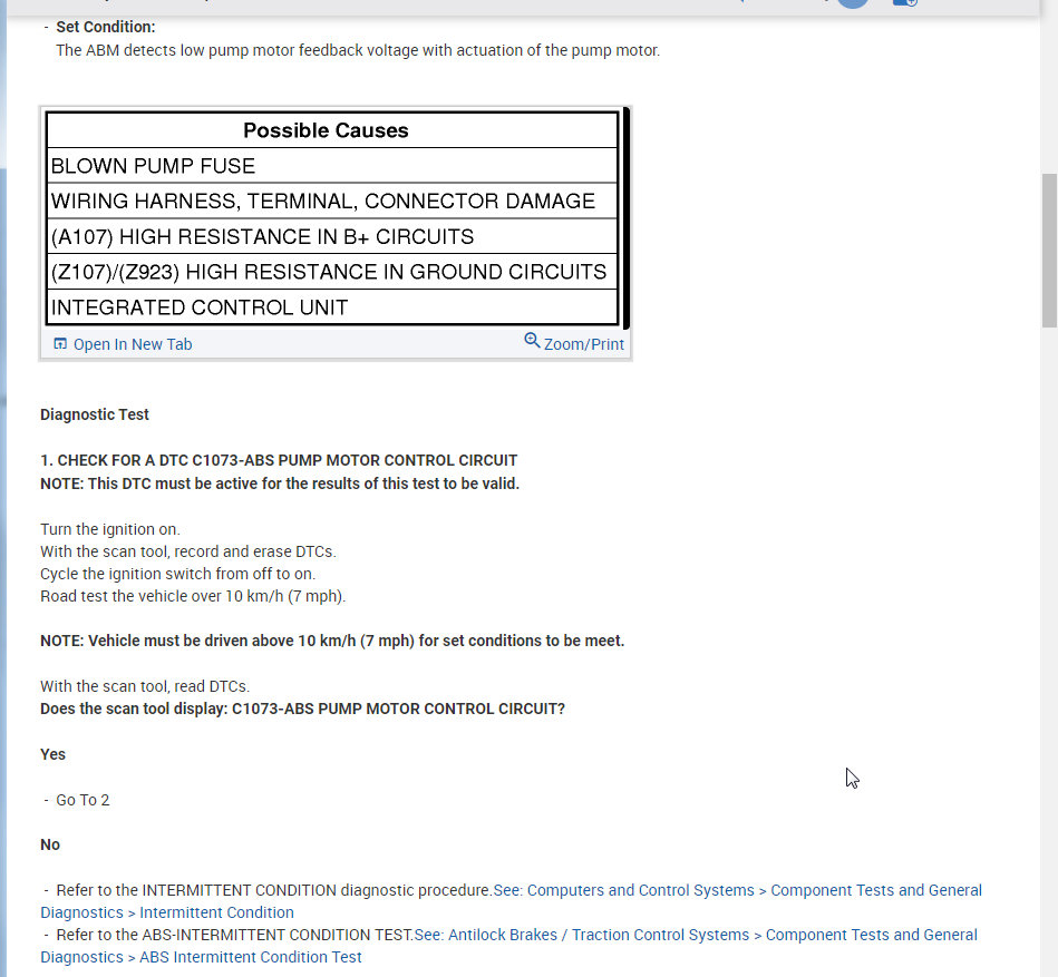

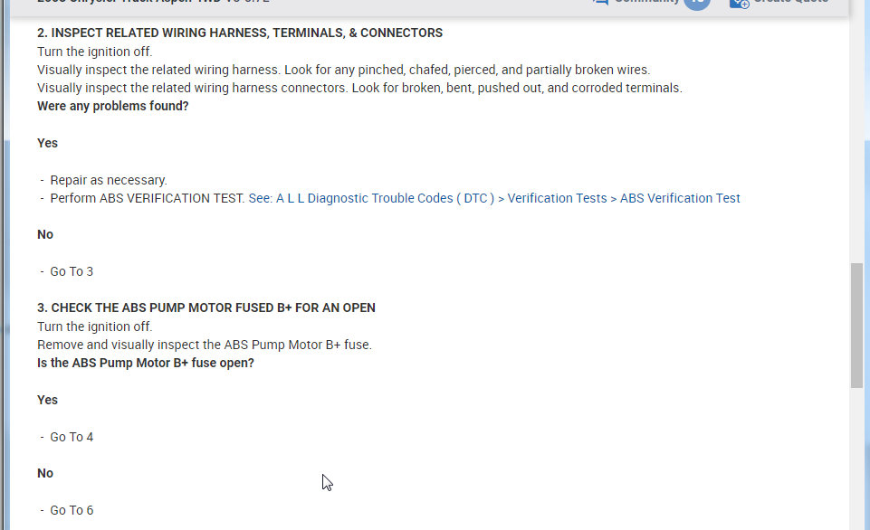

This week I started my car on a cold morning and the ABS, brake, esb, and traction light came on. I plugged in an ABS scanner and a 1073 code came up. I am wondering if I can clear the code to see if it comes on again or if I should take it directly to a mechanic?
Dec 10, 2020 at 9:14 AM

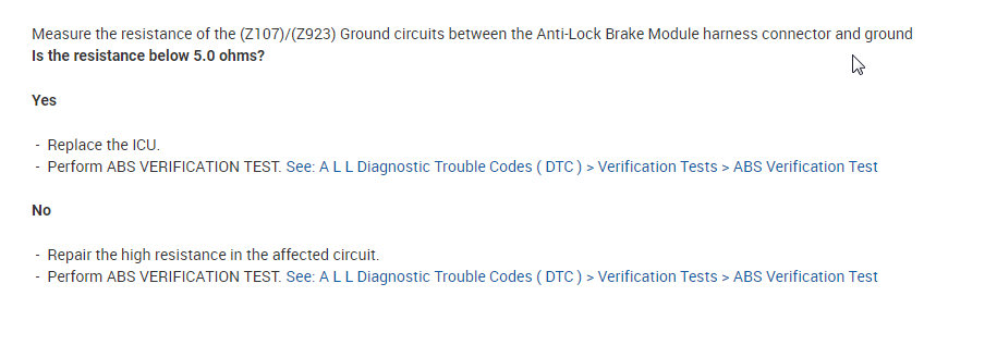

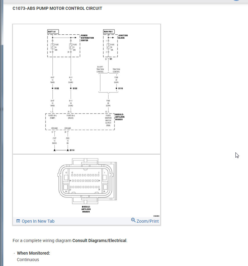

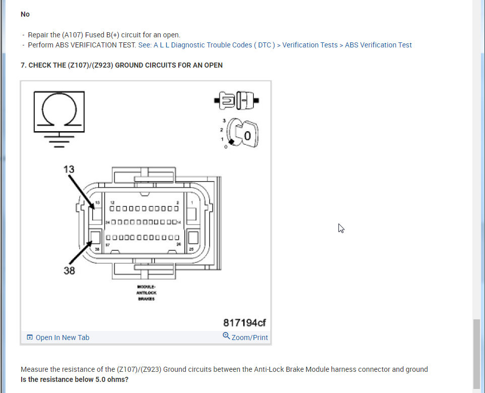

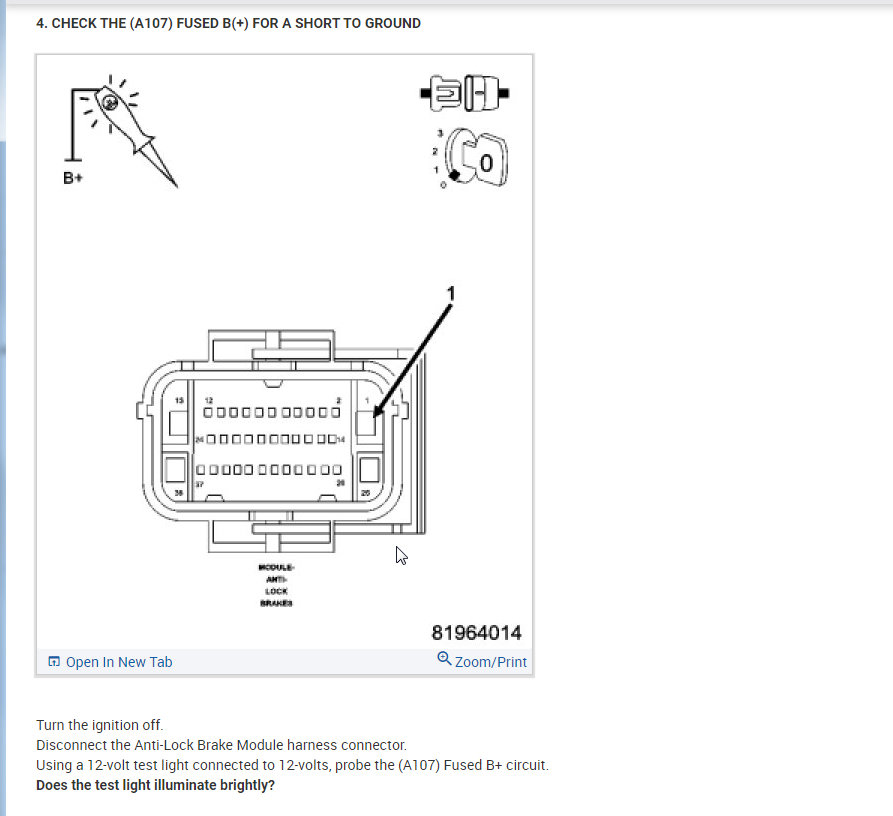

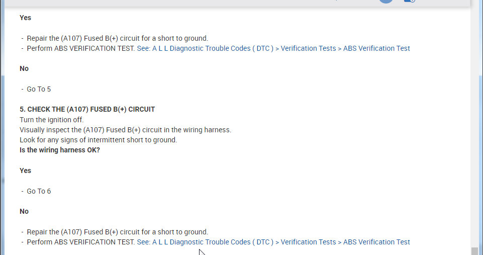

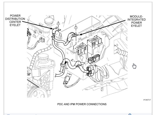

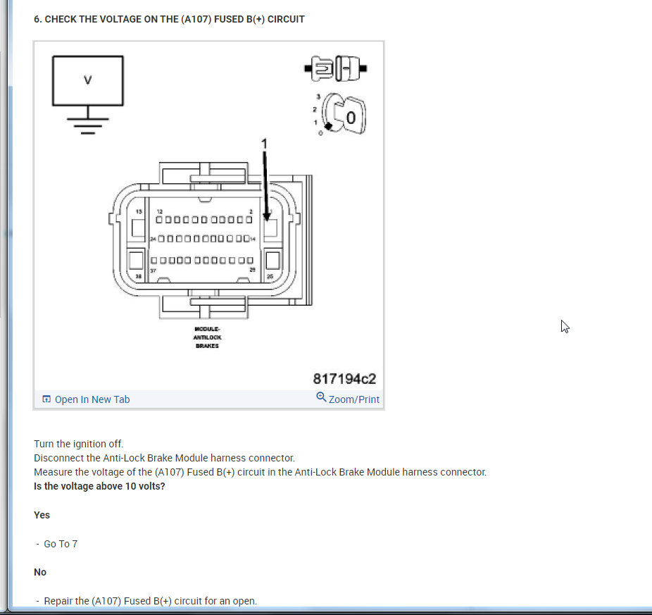

I doubt the code will clear if this is active. This code is pointing to either a wiring issue or a module issue.

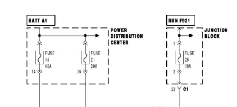

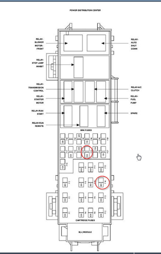

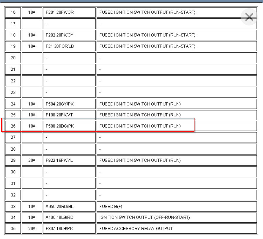

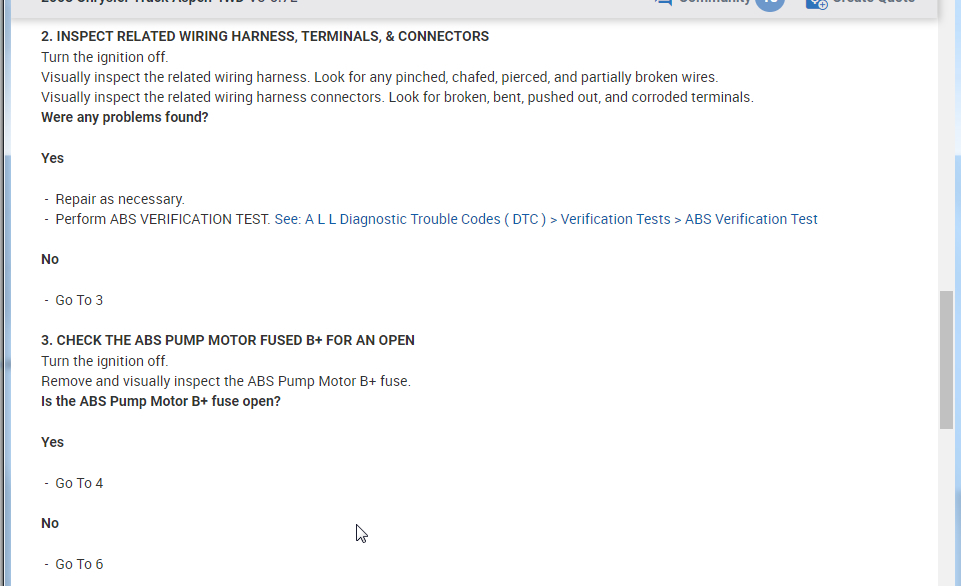

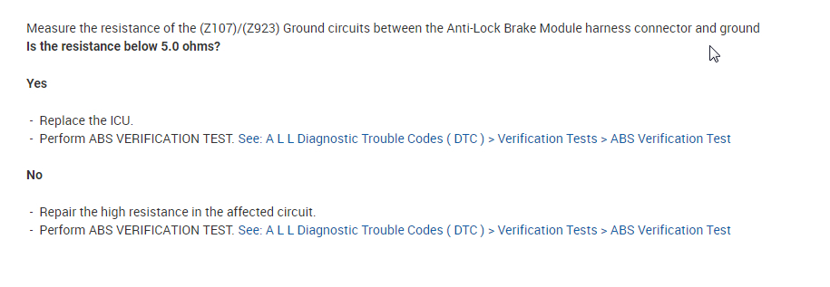

I attached the testing that we need to run through to find out what the issue is.

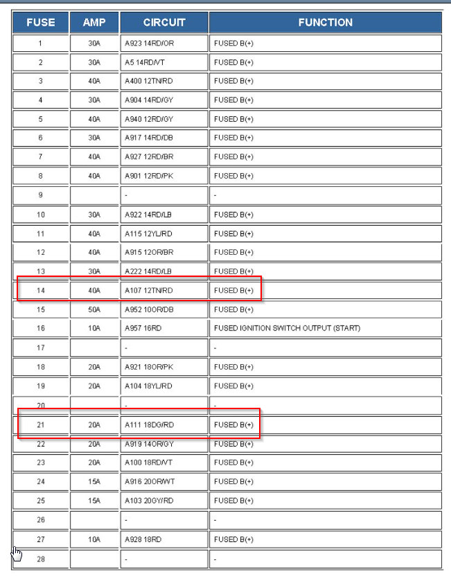

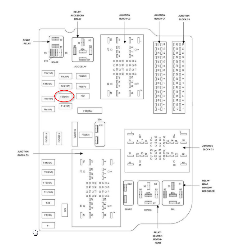

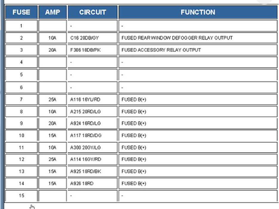

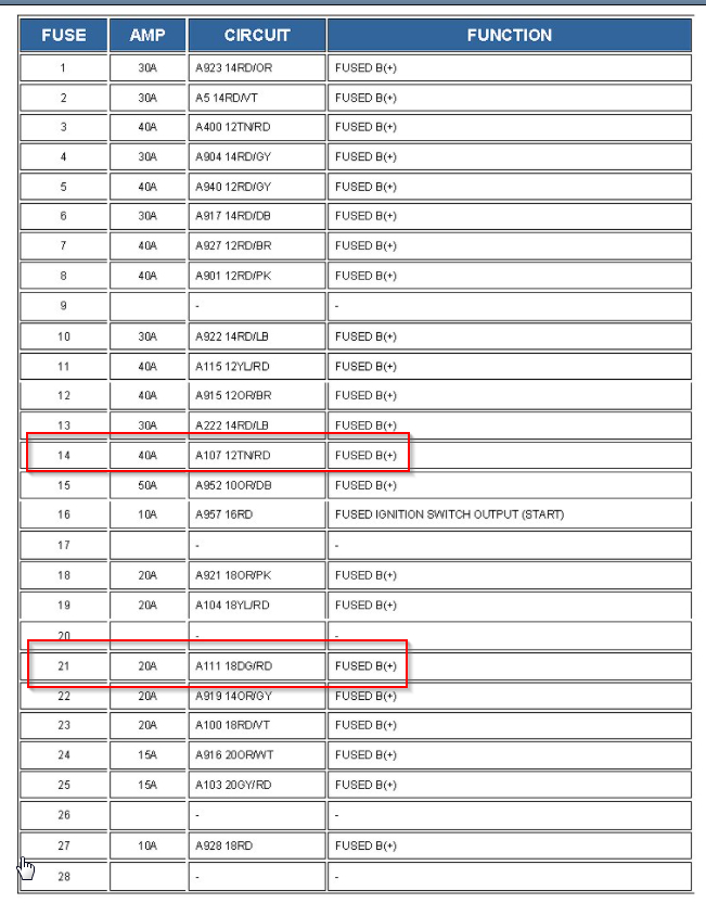

We need to start with checking the fuses. I attached the info on which fuses are involved. If the fuses are okay then the rest of the testing will need to be done in order to find the issue.
Let us know what questions you have.
