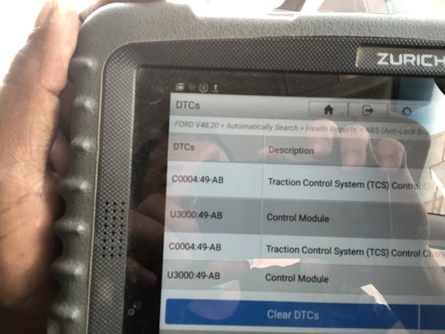

ABS/traction/traction off/brake lights all on together
2013 FORD EDGE
80,000 MILES • 3.5L • 6 CYL • 4WD • AUTOMATIC
IVAN CLARK VIGILIA
Scanned and found error codes regarding traction control.
Jun 16, 2021 at 10:52 PM
  • 55,402 POSTS
Can I get the entire screen image please? Also this happens when a wheel speed sensor goes out. This guide and video can help us see which one so you can replace it to fix the problem:

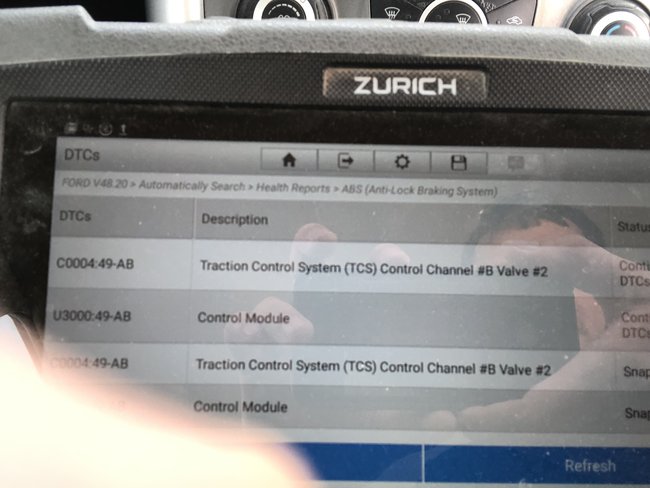

sorry, i have another image i hope it helps. we already tried to erase/clear the code several times and it doesn’t disappear.
Jun 18, 2021 at 1:23 PM
  • 55,402 POSTS

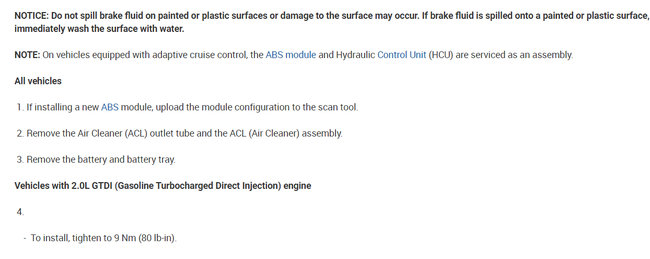

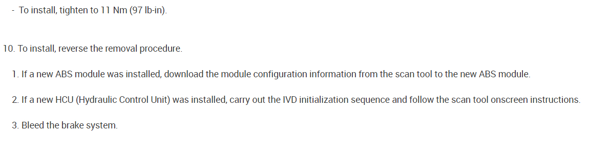

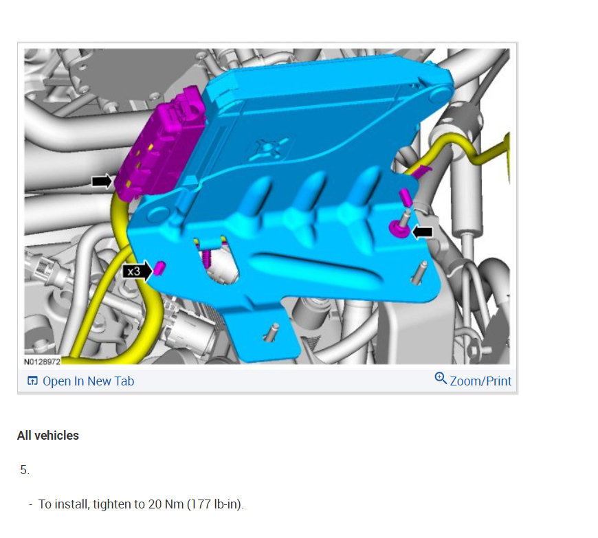

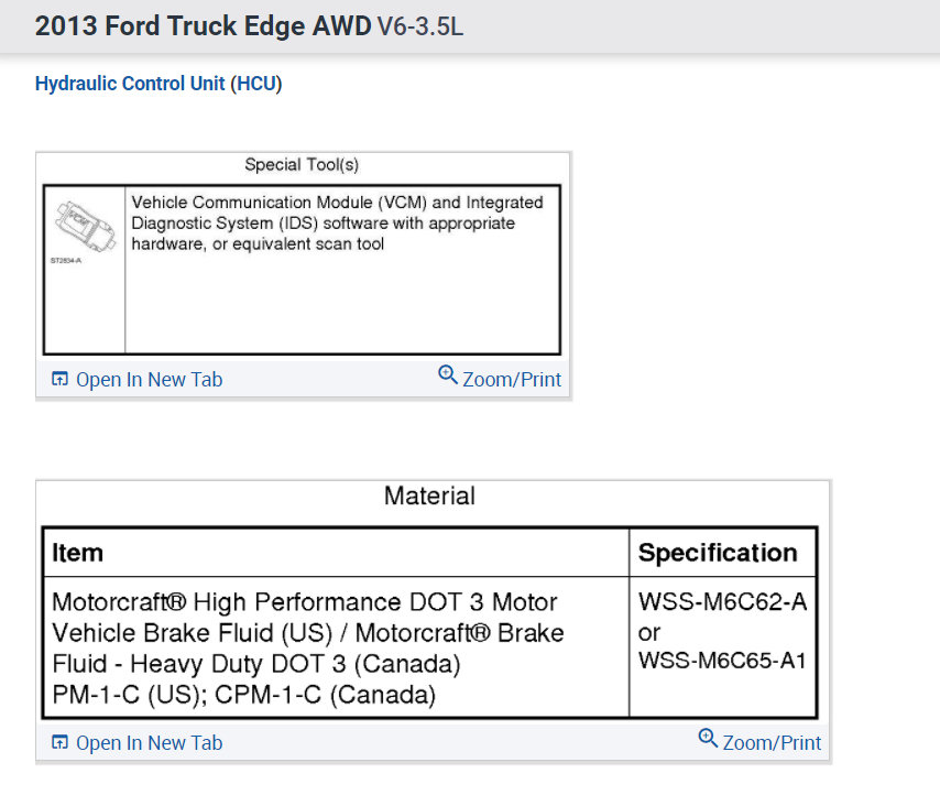

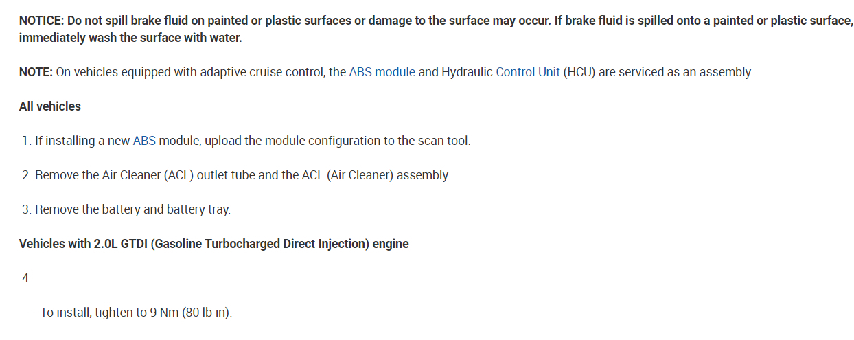

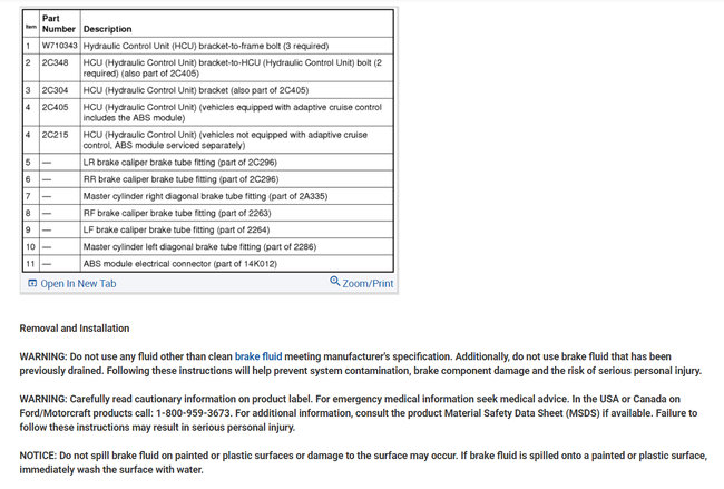

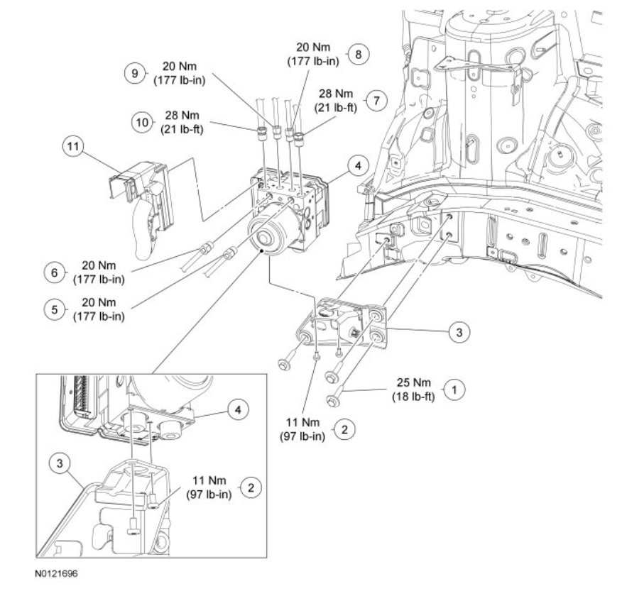

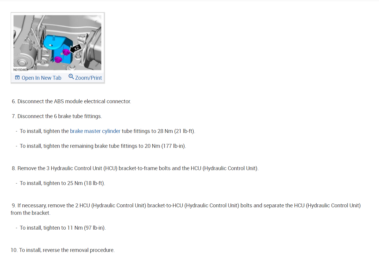

Okay, it looks like the ABS module is out. here is how to replace it in the diagrams below.
