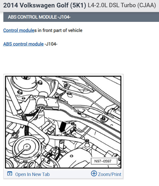

So, was the car in a flood or is the wiring messed up? Is this a race car?
19-CAN Gateway -- Status: Malfunction 0010
02-Auto Trans -- Status: Malfunction 0010
03-ABS Brakes -- Status: Not registered 0011
You didn't start the engine before running the codes correct? To me to sounds like the ABS control module has gone bad, here is how to replace it. This problem is not obvious, if you want to take it to the dealer, I would not blame you. Check out the images (below). Please let us know what happens.

For the clutch problem please start a new thread because we only handle one problem per. Since there is a Wheel-Speed Signal code let's check the sensors manually.
Here is a guide to help:.
https://www.2carpros.com/articles/abs-wheel-speed-sensor-test
Please go over this guide and get back to us.
