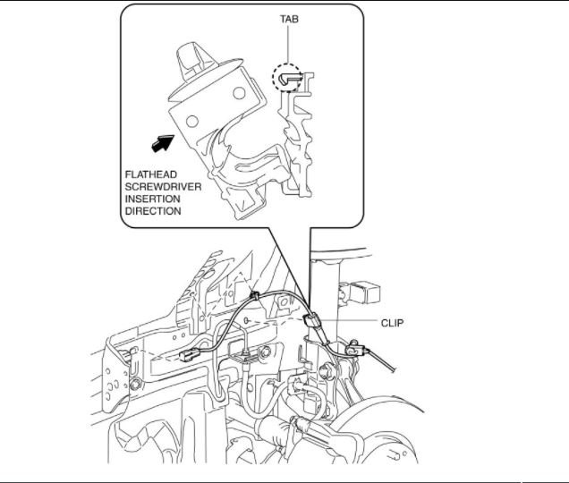

after a hit to the right front side of the car, the ABS, traction, engine lights are on, and the diagnostic is reading changes in 3 out of the 4 wheels except one which is stuck on a fixed number. I changed the wheel sensor and still . what could it be?

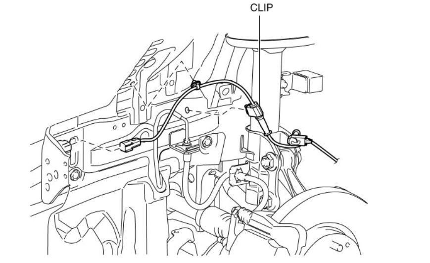

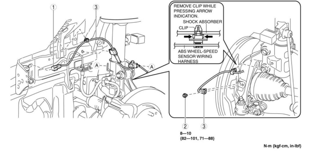

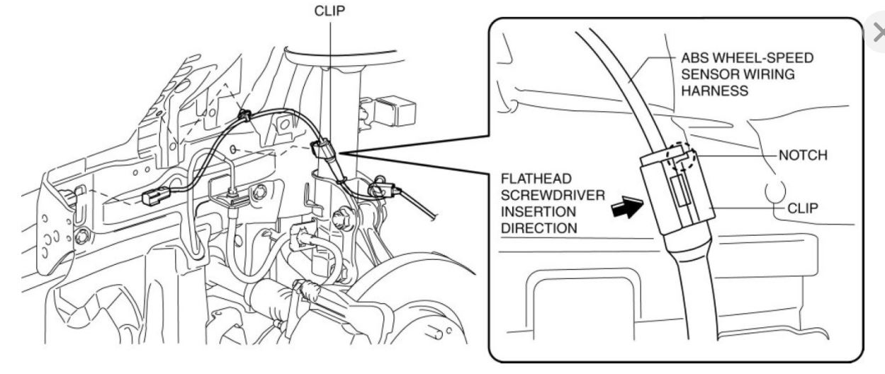

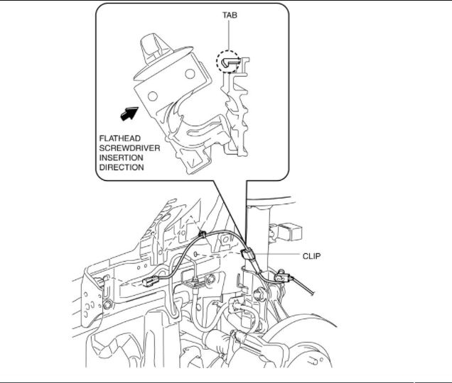

Did you change the sensor on the wheel that has damage?
I attached the procedure below for you to view.
https://www.2carpros.com/articles/how-to-replace-an-abs-wheel-speed-sensor
2014 - Mazda6 - Brakes
FRONT ABS WHEEL-SPEED SENSOR REMOVAL/INSTALLATION
1. Remove the mudguard.
2. Remove in the order indicated in the table.
3. Install in the reverse order of removal.
4. After installation, verify that there is no twisting in the front ABS wheel-speed sensor.
Front ABS Wheel-speed Sensor Wiring Harness and Clip Disconnection Note
NOTE:
- Refer to this note only if the disconnection of the front ABS wheel-speed sensor wiring harness and the clip shown in the figure is required.
1. Insert a flathead screwdriver from the side where there is no notch as shown in the figure.
2. Detach the tab as shown in the figure and disconnect the ABS wheel-speed sensor wiring harness and clip.
