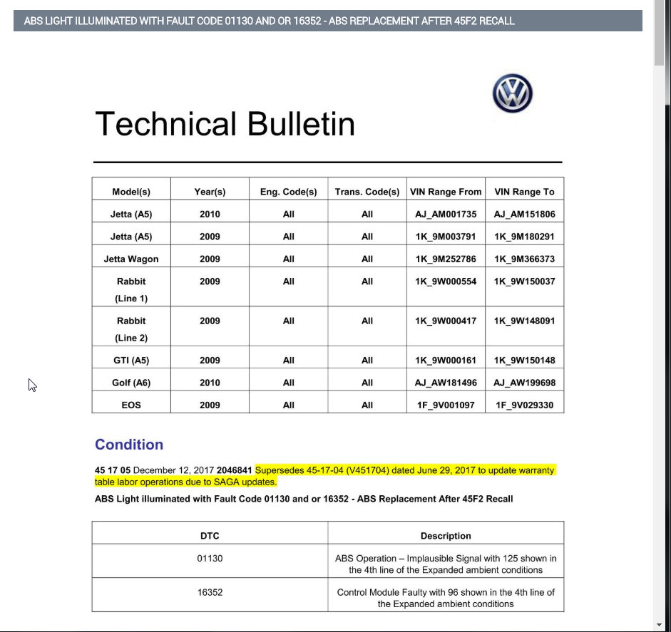

Hello, i own a 2009 golf 6 2.0 tdi i recently bought 4 new pirelli tires size 205/55/r16. The following day while driving on the highway with these new tires the ABS, ESP, and handbrake light turned on. Today i visited the garage and was told the fault is the ABD module and needs to be replaced.
Do these lights have anything to do with the new tires? Or should i proceed and change the ABS module.

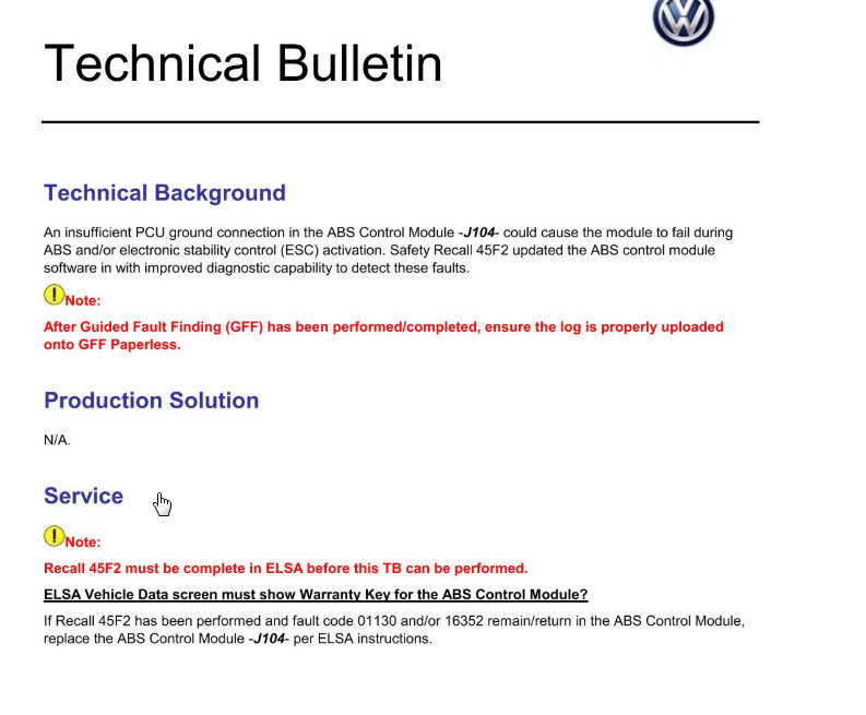

The code read by the scanner is 01130, i have checked the fuse box and found nothing. Any additional information i need to know about this code?

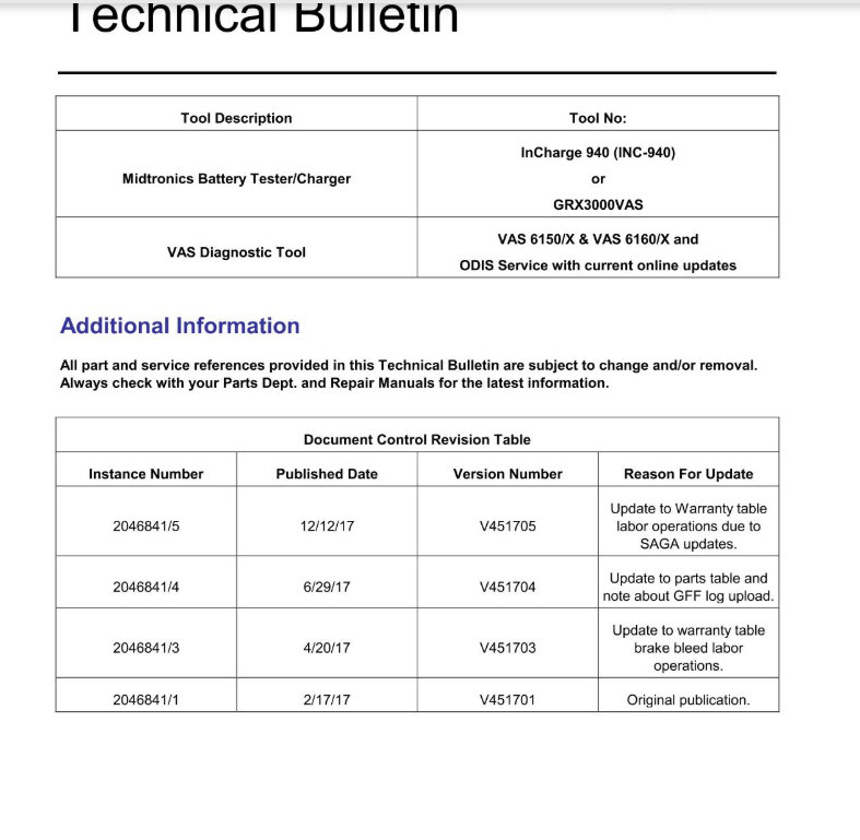

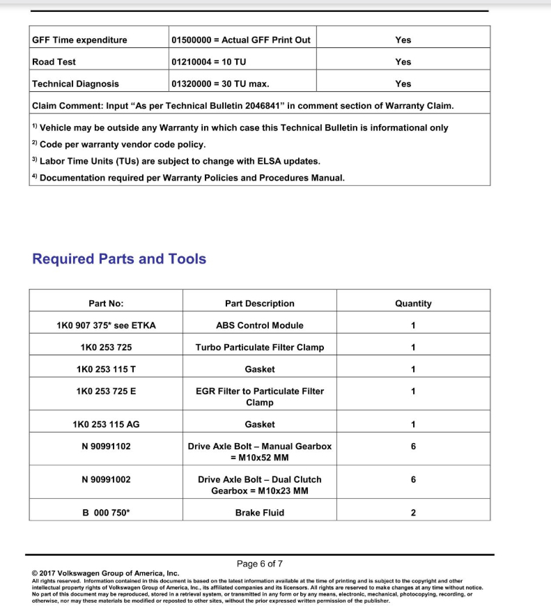

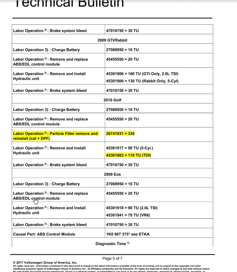

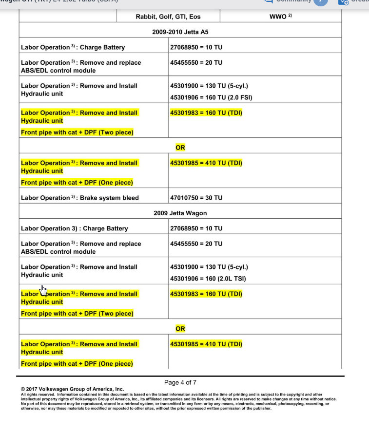

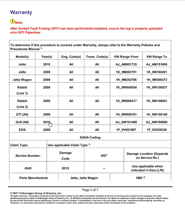

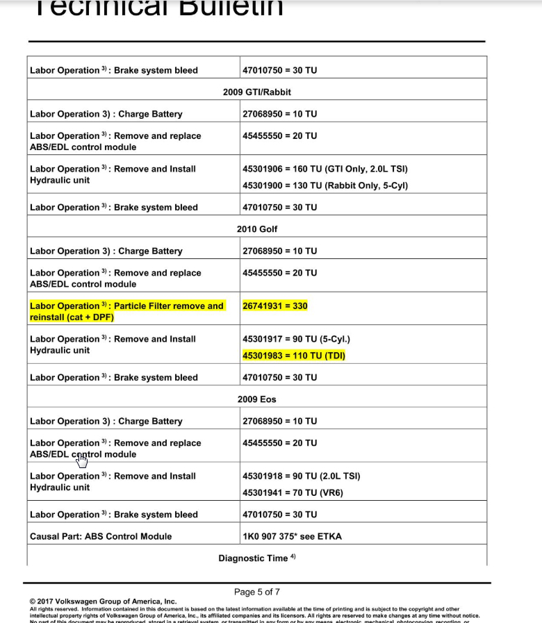

As I said, this has nothing to with the tires. This code is for the ABS module operation. I attached a TSB that address the most common cause of this.
As you will see on the second page the background of the issue is the PCU ground connection of the ABS control module (J104) may have failed. Granted this TSB is for this fault occurring immediately after the recall 45F2 being performed because this recall was to instruct the module to monitor this "closer." So the vehicle may fail after the recall. However, the code is still saying the same thing even if your vehicle doesn't fall under this specific TSB/Recall.
