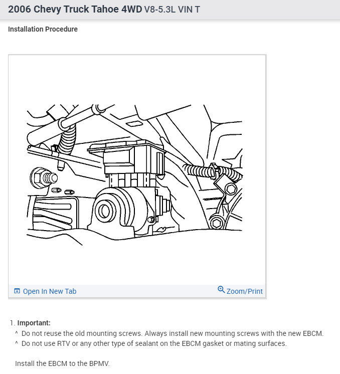

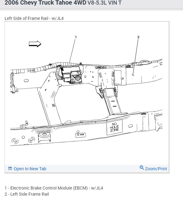

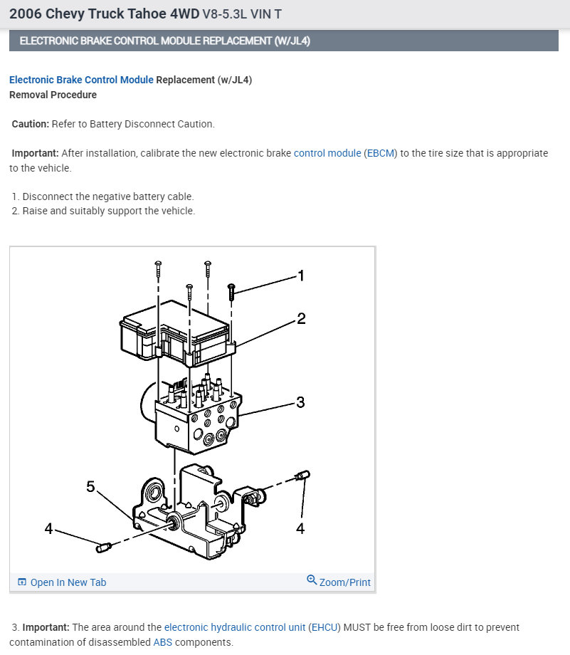

I replaced the ABS Control Module after it gave me a pump malfunction code. That code is gone and is now reading a new code C0558 "Calibration Data Not Programmed". I followed your installation guide for the Yukon XL. Do I need to have the dealership flash the new control module? Is this something a normal tire shop can do? Where do I go from here? Thanks guys! Great video by the way!
Aug 23, 2016 at 2:25 AM
SQM
  • 6,383 POSTS

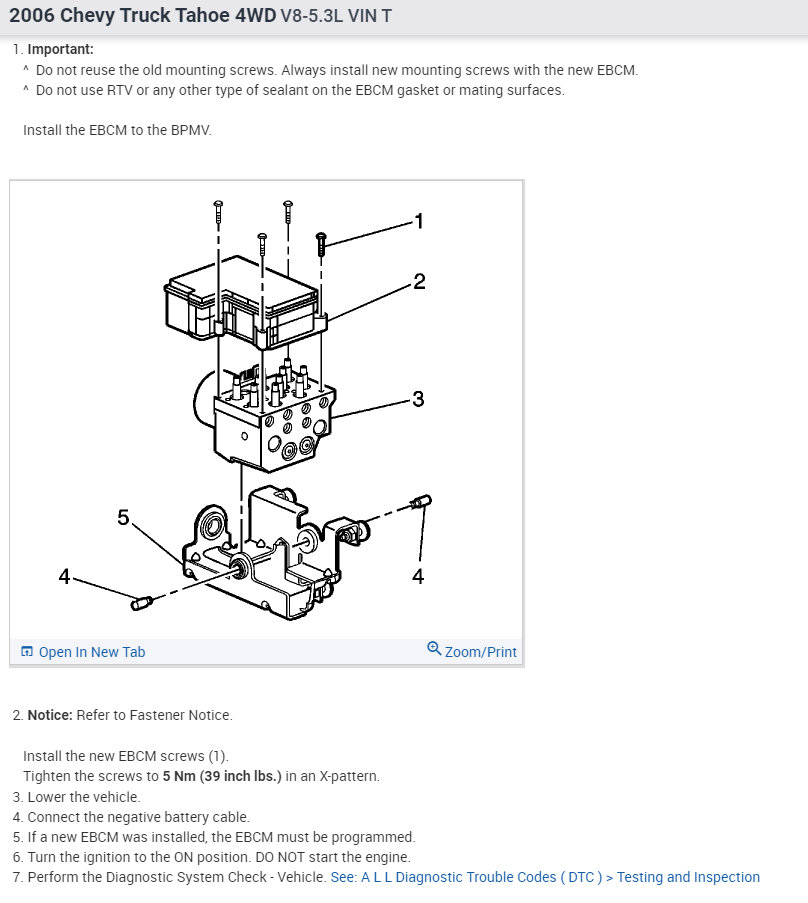

The EBCM does need to be programmed / relearn after the install.
It can be done at any shop that has specialty scan tool.
https://www.2carpros.com/articles/how-to-replace-a-abs-controller
