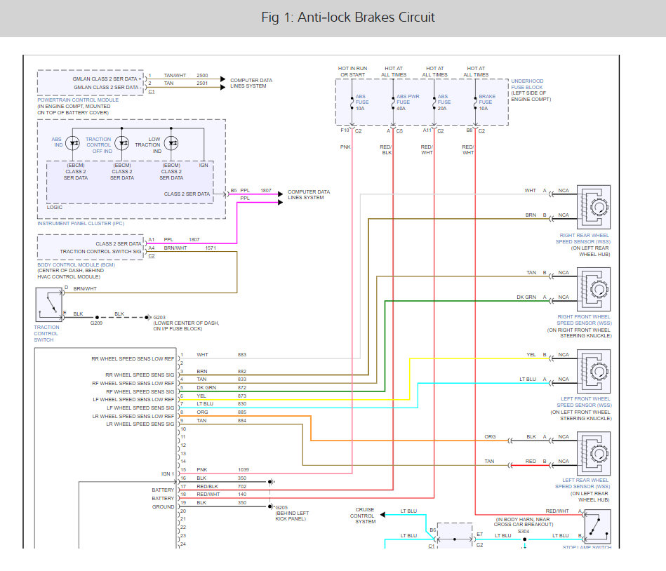

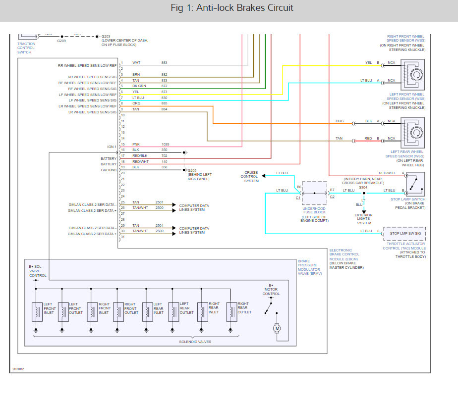

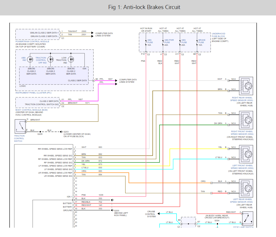

Where can i find a diagram of the ABS front wiring system?
Oct 29, 2019 at 6:56 AM
AL514
Experienced Mechanic
5,700 POSTS
hello thanks for using 2carpros, Here is the ABS wiring diagrams below and a guide to help you test the connections.
