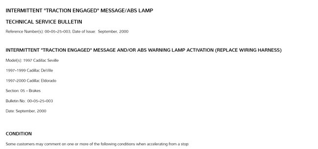

The diagnostic tech found Codes C1261, C1262, C1267, C1268, C1272, C1273, and C1274. recommends replacement of ABS Control Module#19244918.
Jun 2, 2022 at 9:11 AM
AL514
  • 5,656 POSTS
Okay, did you happen to have an intermittent issue here, such as messages on the Driver Information display "Traction Engaged" and/or the ABS light coming on? and did he check the main connector or the wiring harness for the ABS module for corrosion? And did this happen all at once?
Just asking because this is a lot of codes to set. In a situation like this, I would think it's a major failure of the ABS module or there is a wiring harness issue.

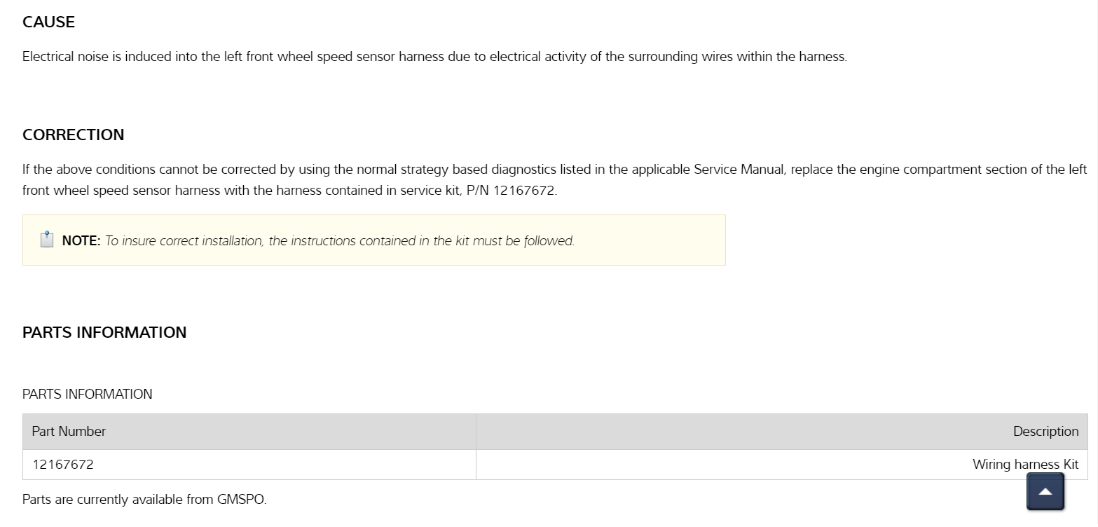

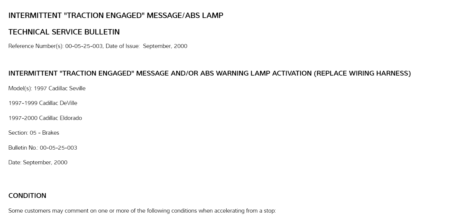

I'm not saying it's not a failed ABS module, because it could be, but each one of these codes is a certain solenoid failure, so that's 7 solenoids that failed out of the 13 there are. There is only 1 Technical Service Bulletin for the ABS module on this vehicle, (posted below). It's possible to check the resistance of each solenoid and determine the reason for its failure. But it's tough to make a call on replacing the module without knowing what testing he did, and I wouldn't make such a deal of it if the module was available. So, if he did inspect the main connectors for the module and did the correct testing, I'd say replace the module. But of course, it will have to be a used one.
