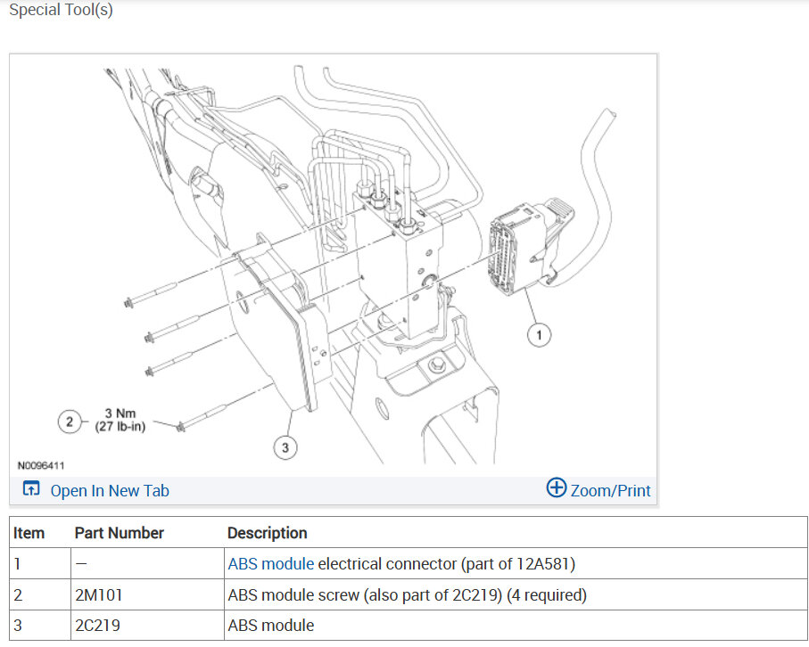

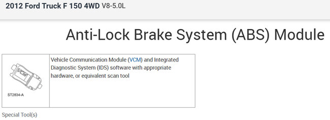

I'm swapping my ABS control module on my truck listed above that a shop said was faulty. I want to do it myself but need a scan tool that can pull the program off the old one and transfer it to the new one. Anybody know a cheaper end scanner that is capable of doing this?

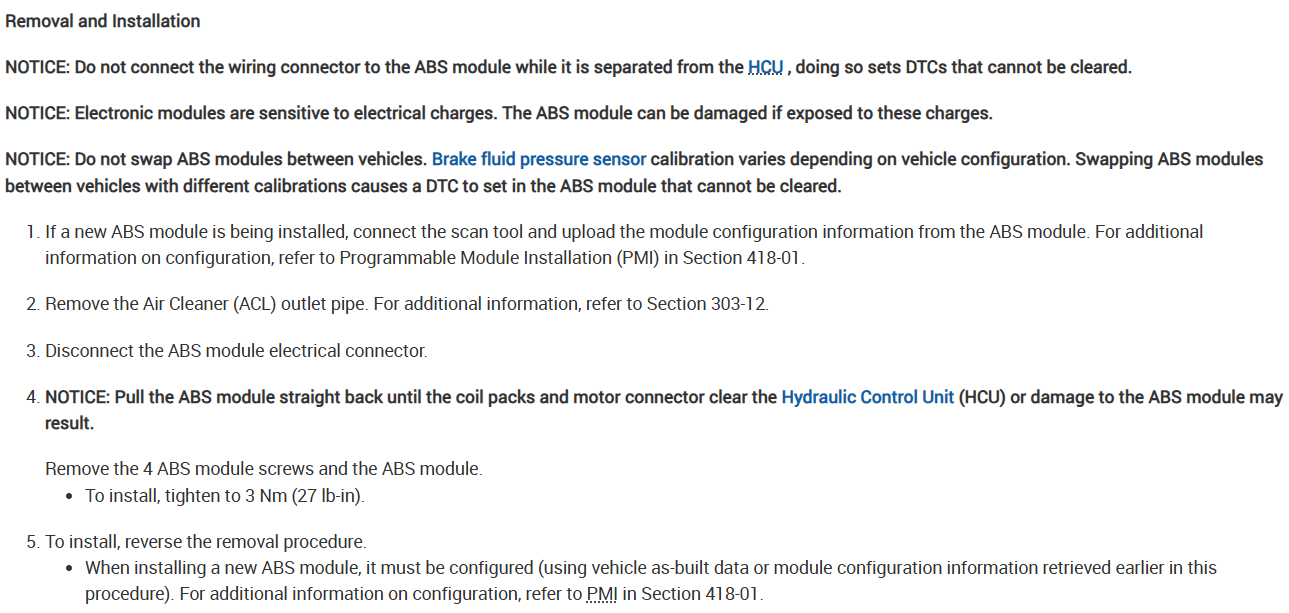

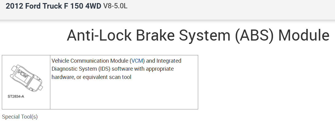

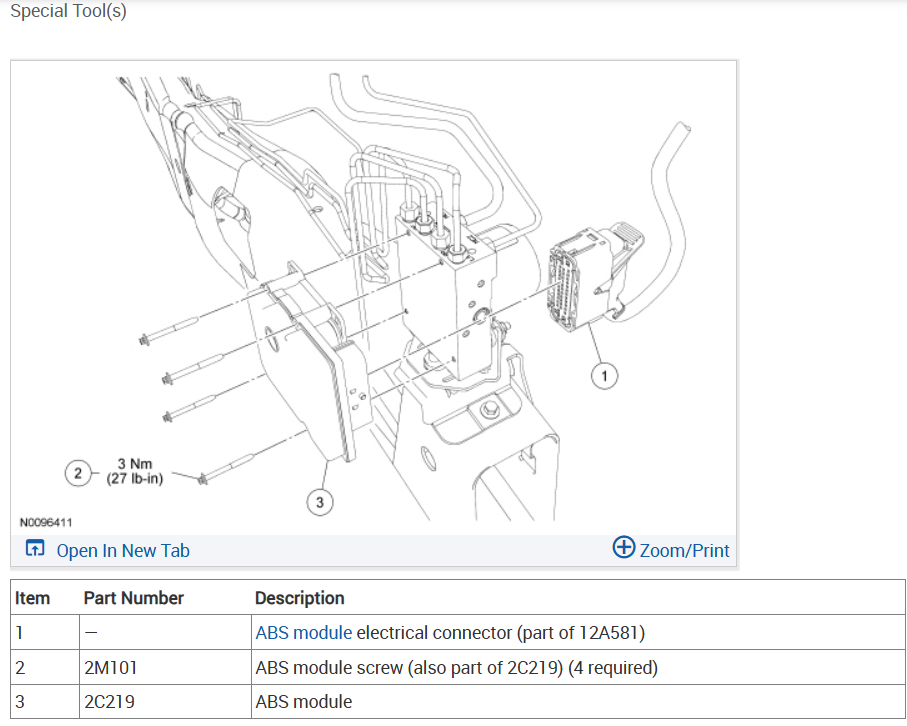

Here is a pass-through programmer for $235.00 the cheapest one I can find.
https://amzn.to/3D3a8EQ
Here are the instructions on how to replace the ABS controller. Check out the images (below). Let us know if you need anything else.
