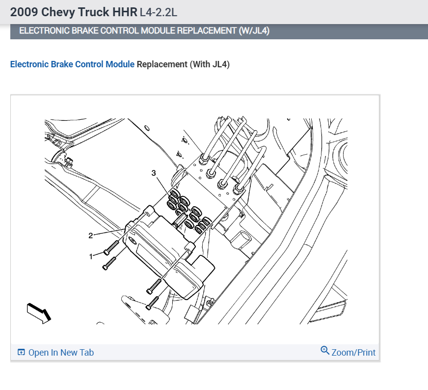

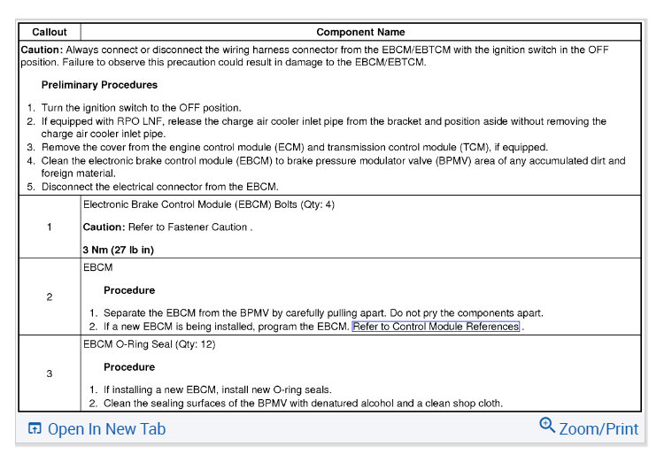

Have you installed it yet? If so, does it work okay and is the ABS warning light on? I would try it without new programming because the manual says you might not need to. We have had good luck in the shop for just replacing the module and it-self learns.
Electronic Brake Control Module Programming and Setup
EBCM Replacement
If the electronic brake control module (EBCM) is replaced, the following procedures must be performed:
EBCM Reprogramming-Refer to Service Programming System (SPS) (See: Vehicle > Programming and Relearning).
EBCM Reprogramming
If the EBCM needs to be reprogrammed, refer to Service Programming System (SPS) (See: Vehicle > Programming and Relearning).
Setup for Component Replacement
The replacement of ABS components will not require a setup procedure for complete repair.
Here is a guide of us doing the job with no programming required:
https://www.2carpros.com/articles/how-to-replace-a-abs-controller
Here are the instructions for the ABS module replacement. Check out the images (below). Please let us know what happens.

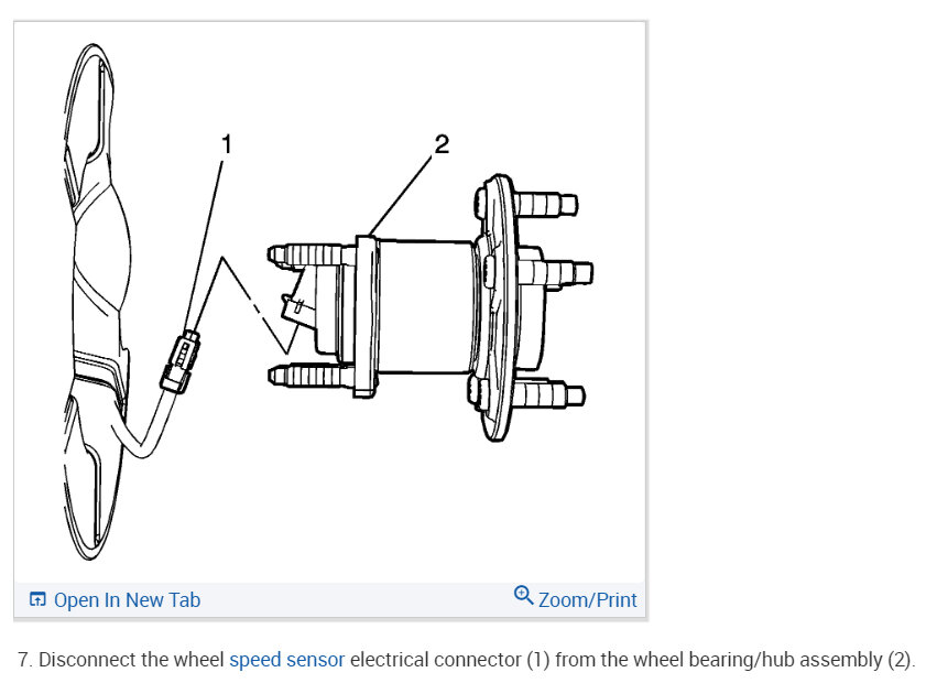

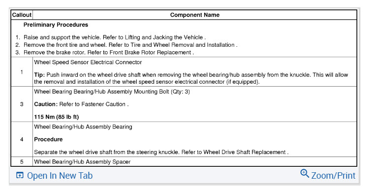

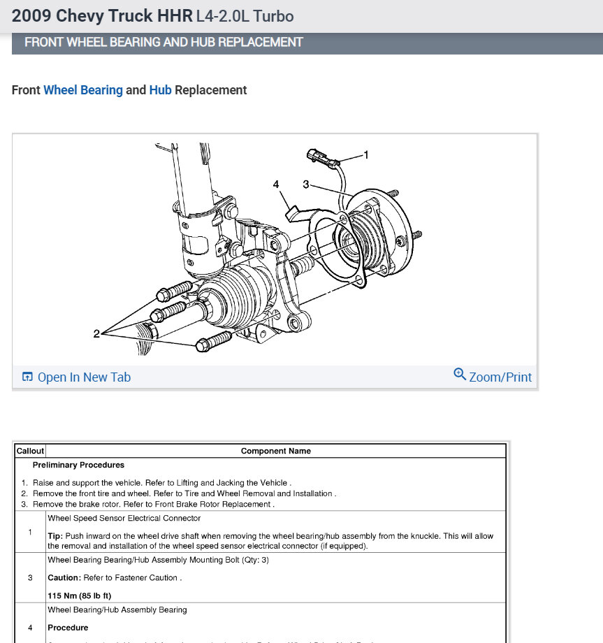

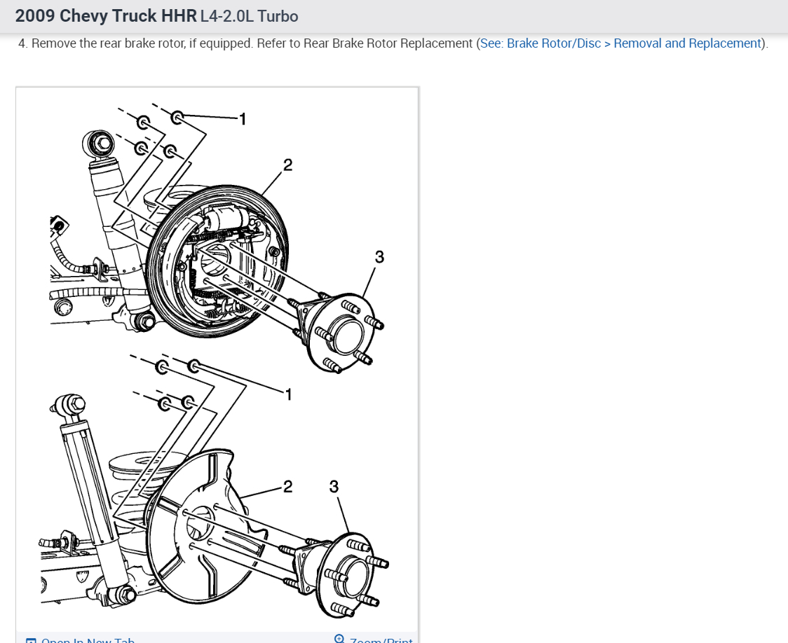

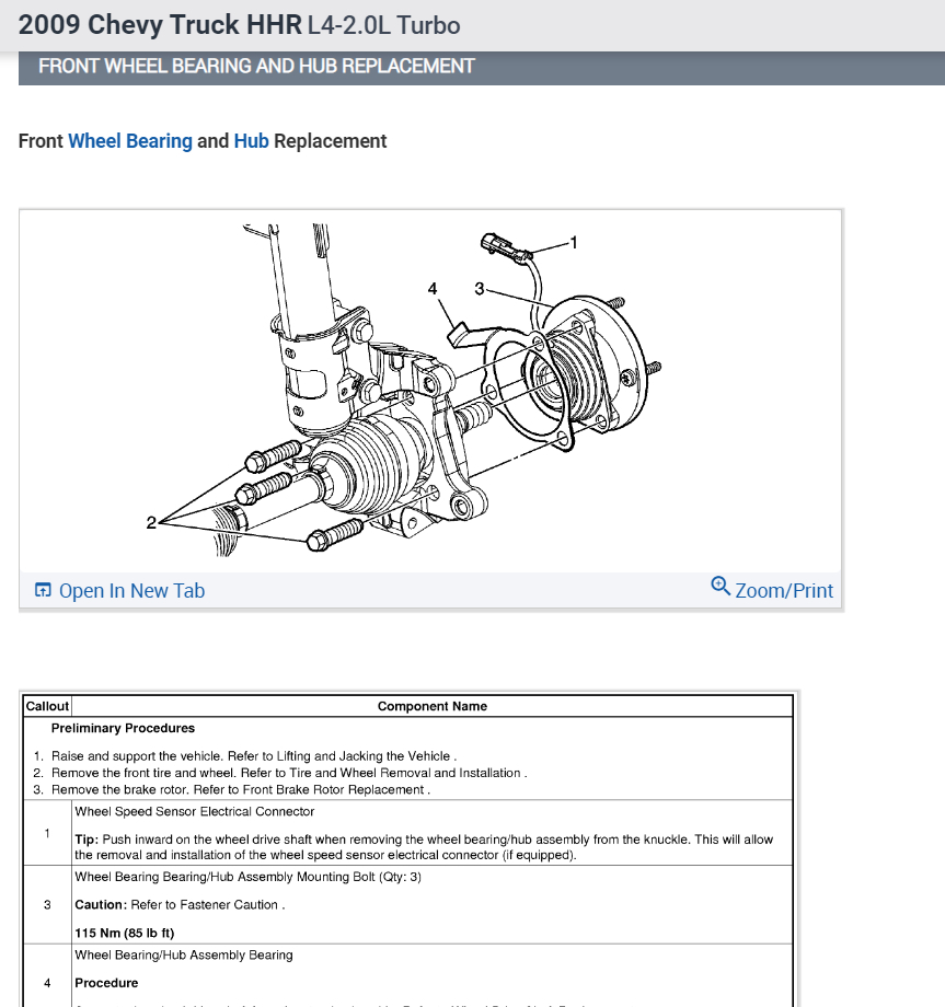

From what you have described it seems like you have a front bearing hub going out which the wheel speed sensor depends on for the ABS reading, if you hit a bump the bearing allows excessive movement causing the ABS module to react. It could have been working just fine. There will be no codes for this problem because to the module the system is working. Do you see any rust-colored dust around the bearing hubs? Check out the images (below). Please let us know what happens.

The dealer was able to program the used ABS module. It was in fact the module not identifying the VIN. All is good now.
