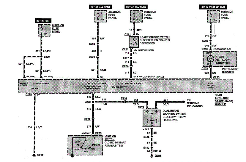

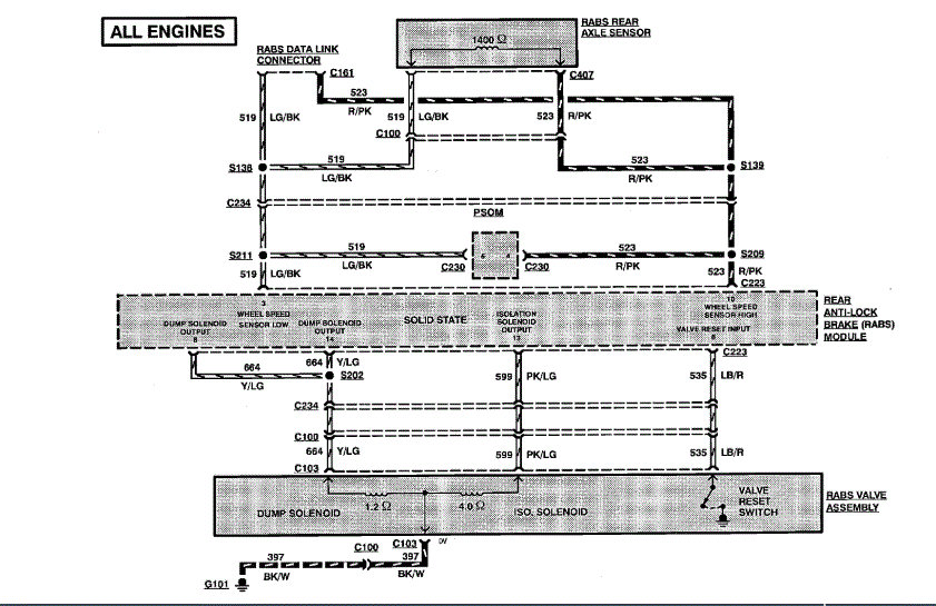

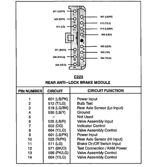

I’m having trouble finding the ABS control module on this van. can someone help me?

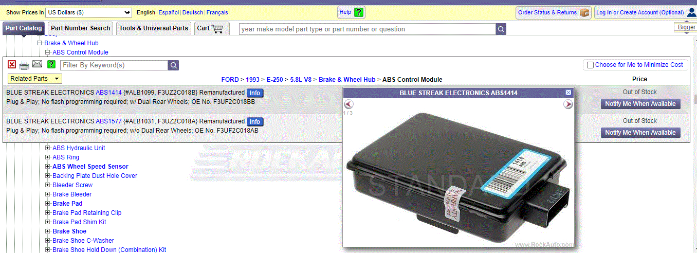

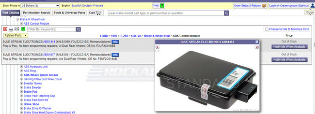

They did not have a picture but I found the module at rock auto and attached it for you.
https://www.2carpros.com/articles/abs-brake-system-repair
It is under the dash on the drivers side.
1. Disconnect battery ground cable.
2. Remove screw securing module to the instrument panel lower brace, then pull module off retainer clip assembly.
3. Disconnect wiring harness from module by depressing plastic tab on the connector and pulling off.
4. Reverse procedure to install.
