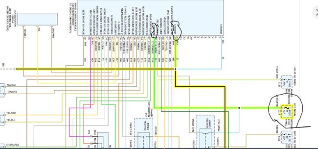

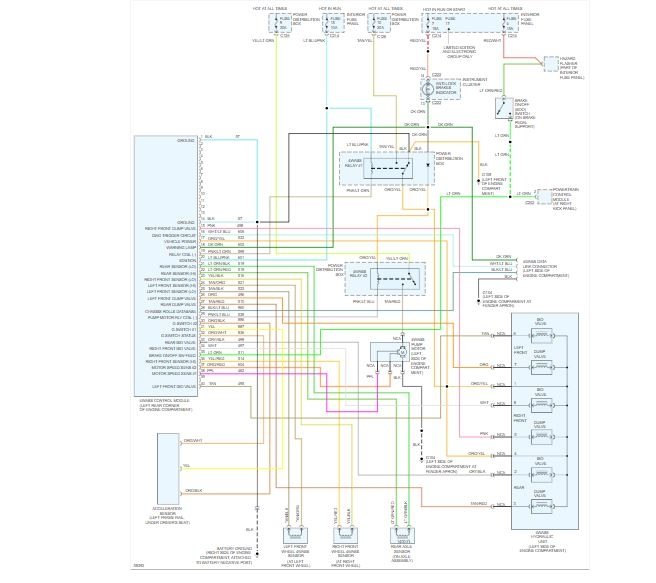

Those codes are for the internals of the ABS module itself. They are not working or have no power.
I attached 2 diagrams for you.
The one shows power and ground to the module. Check those wires. If you have power and ground the ABS module is bad.
If you do not have power, check the fuse I circled for power on both sides with the key on.
