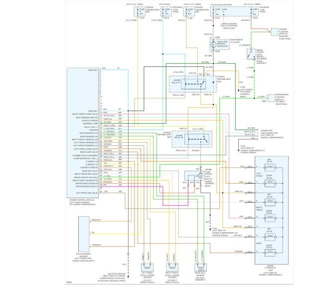

Had my wheels rotated and afterward my ABS light was on. Also my ignition switch was broken. Took car to AAMCO for evaluation, found codes below but unable to decipher.
Performed IVC retrieved ABS Codes Found:
22 front L inlet valve
23 front L outlet valve
25 front R outlet valve
26 rear axle inlet valve
27 rear axle outlet valve
Took car to auto shop, now want $265.00 and did not check ABS. Instead said they found small oil leak which leaked on hose and needed replacement. Very dissatisfied and don't know what to do about this issue. Shop refuses to release car without full payment.

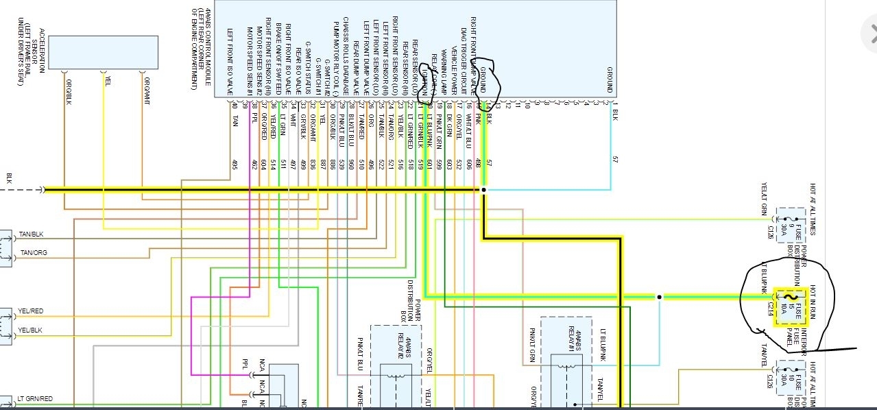

Those codes are for the internals of the ABS module itself. They are not working or have no power.
I attached 2 diagrams for you.
The one shows power and ground to the module. Check those wires. If you have power and ground the ABS module is bad.
If you do not have power, check the fuse I circled for power on both sides with the key on.
