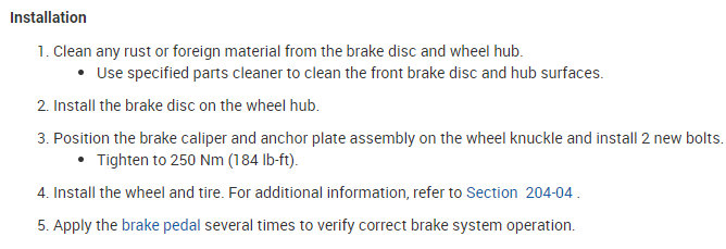

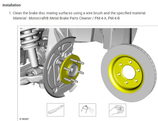

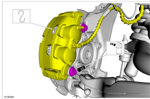

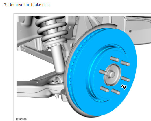

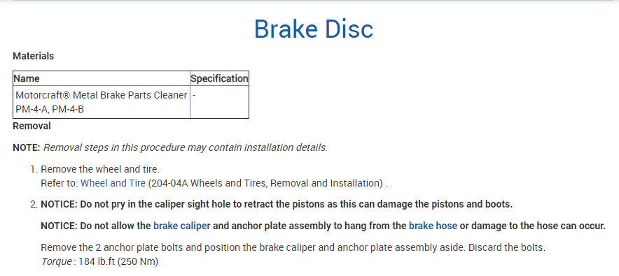

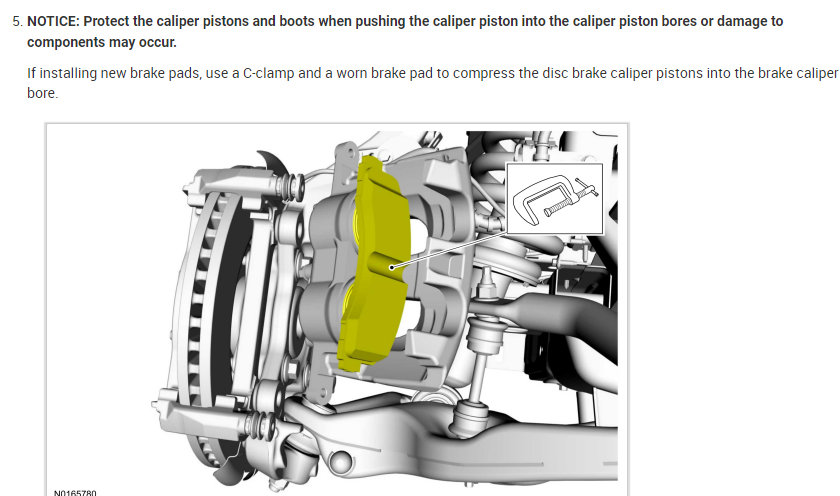

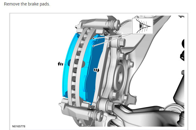

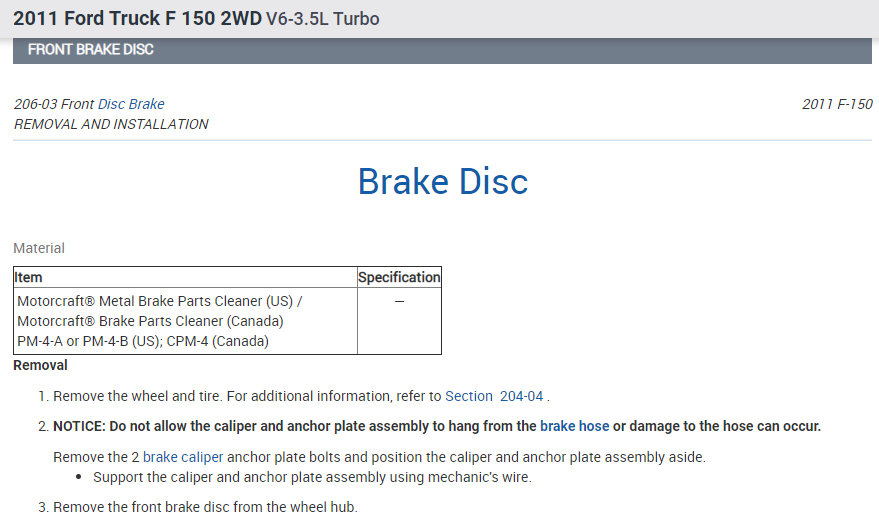

I also hear an intermittent sound that comes from the front passenger side brakes so I need to do a brake job can you help me please? Thanks
Oct 23, 2019 at 8:18 AM
DANNY L
  • 5,648 POSTS
Hello, I'm Danny.

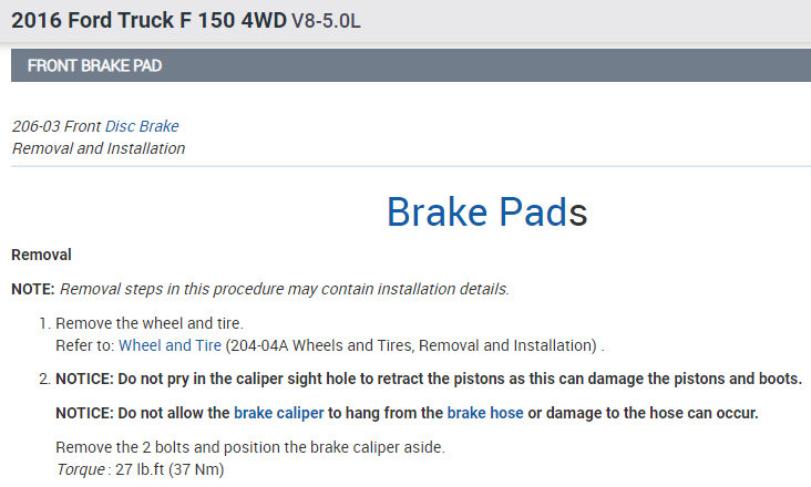

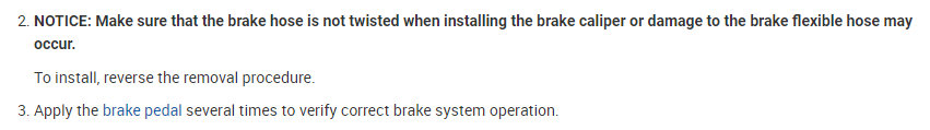

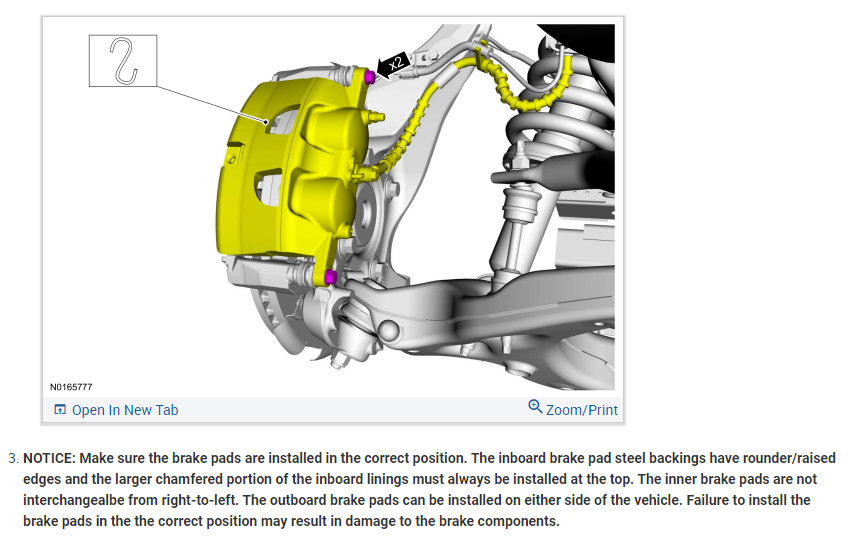

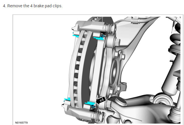

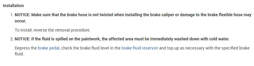

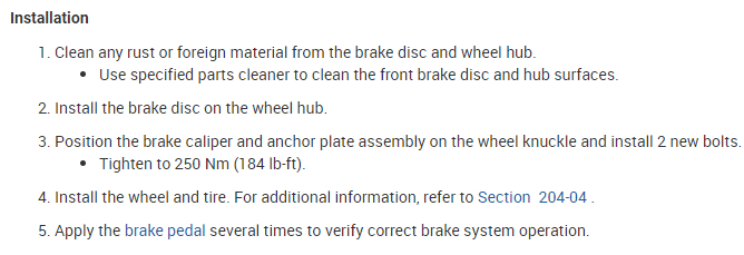

Here is the information you requested. This is a tutorial showing what is involved on how to change front brake pads and brake rotors:
I've attached picture steps below on how to change the front brake pads and rotors on your truck. Hope this helps and thanks for using 2CarPros.
