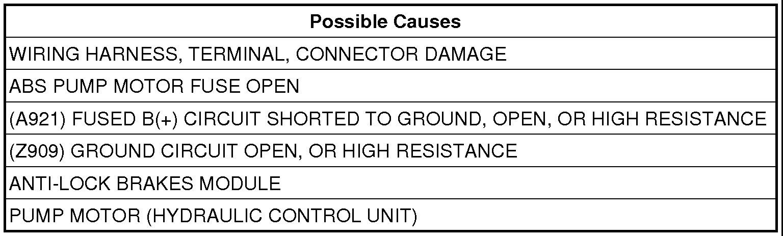

That indicates low voltage to the ABS pump motor. Here are the diagnostics for it. Before going crazy, check and make sure there are no ground issues and check battery voltage. The attached pictures correlate with the directions.

Vehicle ALL Diagnostic Trouble Codes ( DTC ) Testing and Inspection C Code Charts C2116
C2116-ABS PUMP MOTOR SUPPLY LOW VOLTAGE
pic 1
For a complete wiring diagram Consult Diagrams/Electrical.
- When Monitored:
With the ignition on and the ABS Pump Motor deactivated, but not if supply voltage faults are detected.
Or, if the control is switched off.
- Set Condition:
If the Anti-Lock Brakes Module detects either a low voltage condition when the ABS Pump Motor is activated or deactivated or a high voltage condition when the ABS Pump Motor is deactivated.

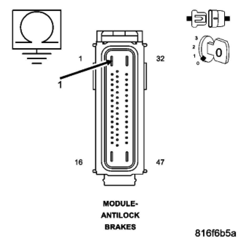

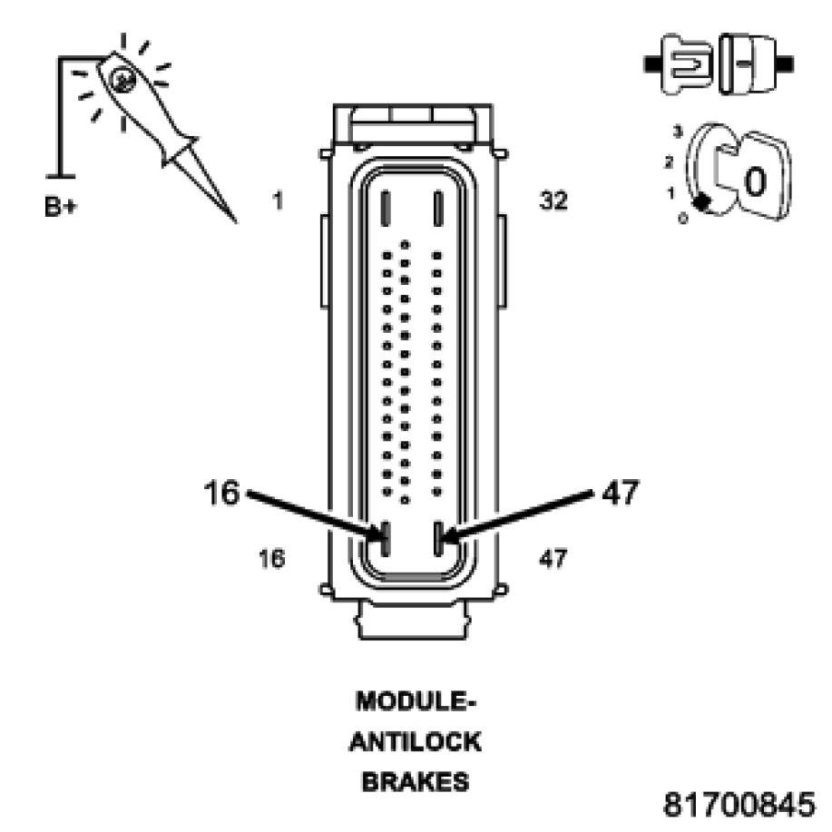

4. CHECK (A921) FUSED B(+) CIRCUIT FOR A SHORT TO GROUND
pic 3
Disconnect the Anti-Lock Brakes Module harness connector.
Measure the resistance of the (A921) Fused B(+) circuit between ground and the Anti-Lock Brakes Module harness connector.
Is the resistance below 10k ohms?
- Repair the (A921) Fused B(+) circuit for a short to ground.
- Perform ABS VERIFICATION TEST. See: A L L Diagnostic Trouble Codes ( DTC ) > Verification Tests > ABS Verification Test.
- Go To 5

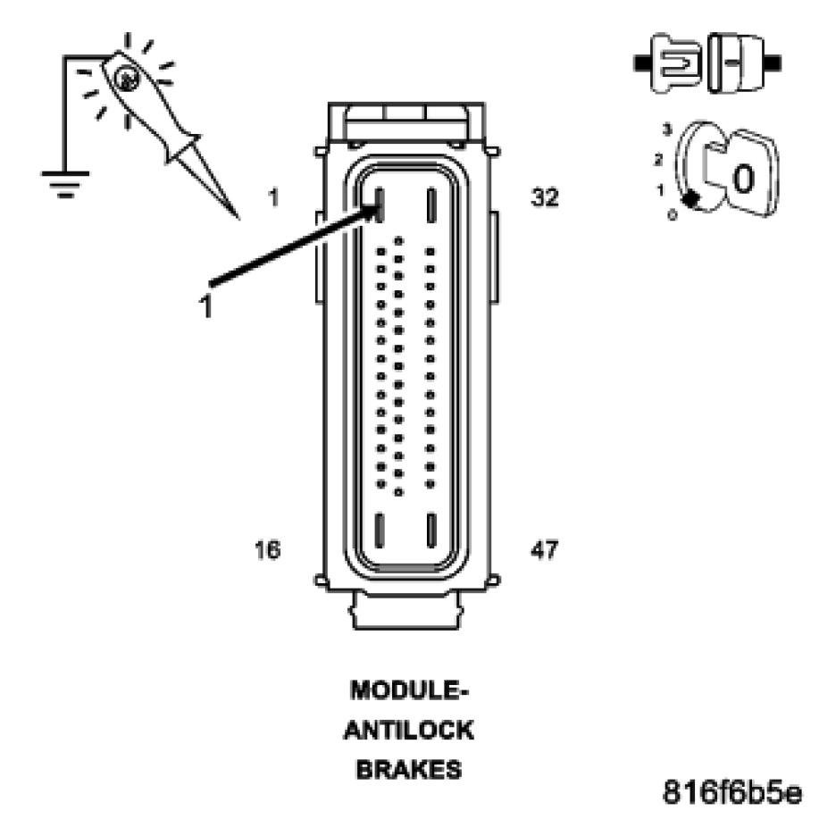

5. CHECK (A921) FUSED B(+) CIRCUIT FOR AN OPEN OR HIGH RESISTANCE
pic 4
Replace the ABS Pump Motor fuse.
Using a 12-volt test light connected to ground, probe the (A921) Fused B(+) circuit.
NOTE: The test light should illuminate brightly. Compare the brightness to that of a direct connection to the battery.
Does the test light illuminate brightly?
- Go To 6
- Repair the (A921) Fused B(+) circuit for an open or high resistance.

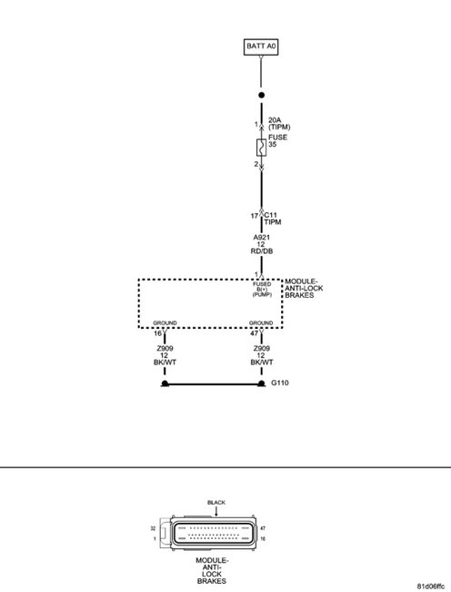

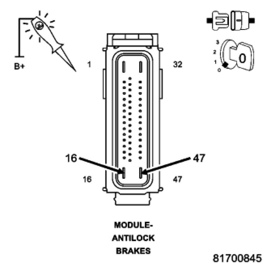

6. CHECK (Z909) GROUND CIRCUIT FOR AN OPEN OR HIGH RESISTANCE
pic 5
Using a 12-volt test light connected to 12 volts, probe the (Z909) Ground circuit.
Does the test light illuminate brightly on both circuits?
- Go To 7
- Repair (Z909) circuit for an open or high resistance.
