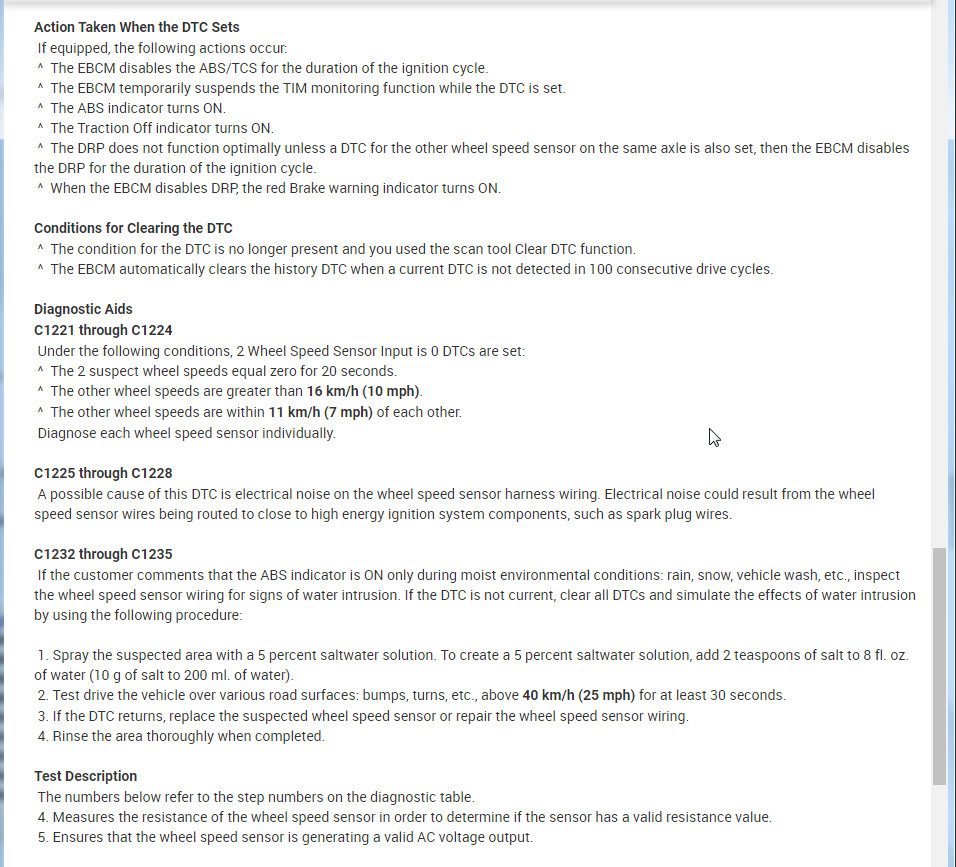

I've replaced the right front wheel hub bearing assembly twice in a week. I thought might have a faulty sensor. Still getting a code from time to time c1233. ABS, check engine, traction off lights on. Sensor connector?, Wiring?, Or ABS controller?
Apr 20, 2021 at 4:10 AM

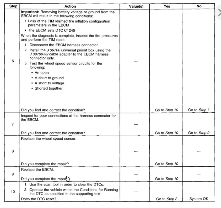

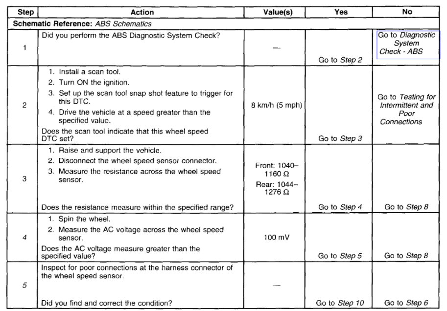

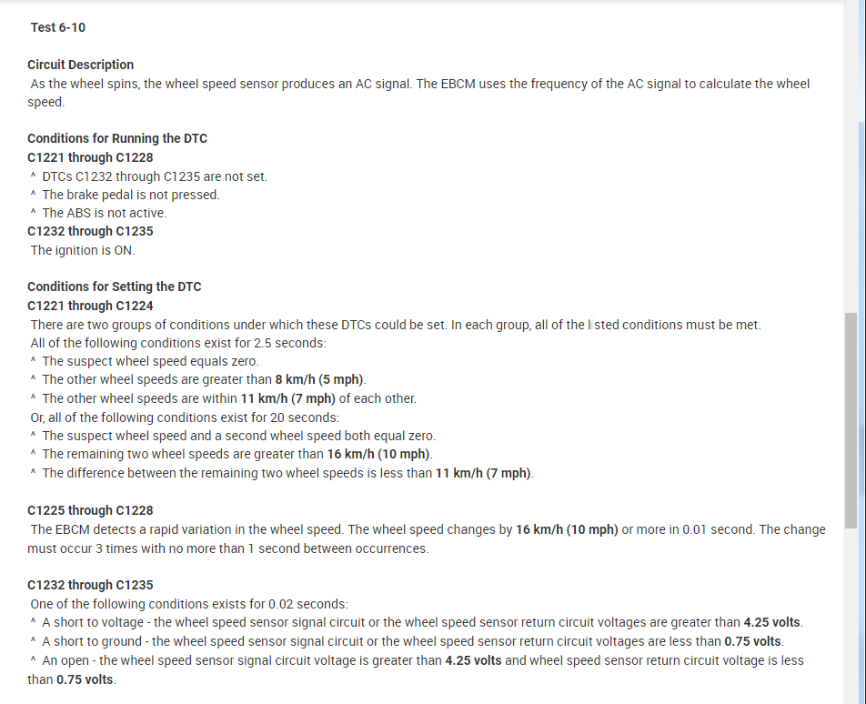

If you have all these light coming on, I suspect you have an issue with the ABS module. However, you would normally have more codes then just this.
So I would suggest running through this test and go from there.
https://www.2carpros.com/articles/abs-wheel-speed-sensor-test
Also, below is the testing from the manual. Please let us know what you find with this and we can go from there.
