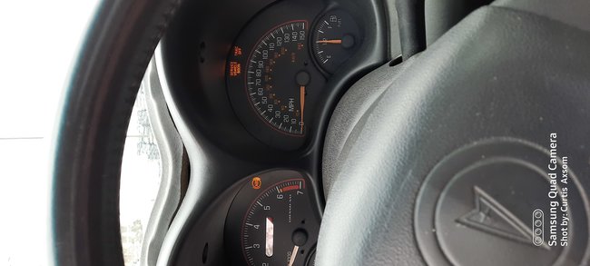

Both front wheel hub bearing assembly have been changed. It has been about a month and I've noticed when I get in the car and start driving the ABS, check engine and traction control light comes on. I stop and shut the car off.
Restart it and lights are gone. As long as I don't shut the car off they don't come back. And I repeat the process. It's not registering in my code reader. so there is nothing to clear. Help please.

What we ask you to do is perform a CAN scan to retrieve all code information from your car. A CAN scan will test all the systems on your car including the check engine and traction controls lights you've mentioned. Here is a tutorial showing what is involved for a CAN scan:
After performing this procedure get back to us with all stored code information and then we can properly diagnose these issues with your car. Hope this helps and thanks for using 2CarPros.

Danny, I've noticed also that when it rains the lights don't come on and everything seems okay.

Have you been able to have the CAN scan performed to retrieve any stored codes? Please keep us updated and supply any code information so we can properly diagnose any vehicle issues. Thanks again for using 2CarPros.
