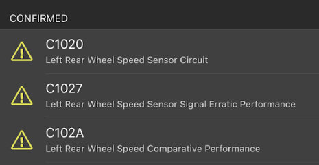

use a ODBII scan the code related this part:
C1020 Left Wheel Speed Sensor Circuit
C102A Left Rear Wheel Speed Comparative Performance
U0415 Implausible Data Received from ABS
U417 Implausible Left Wheel Distance Signal Received

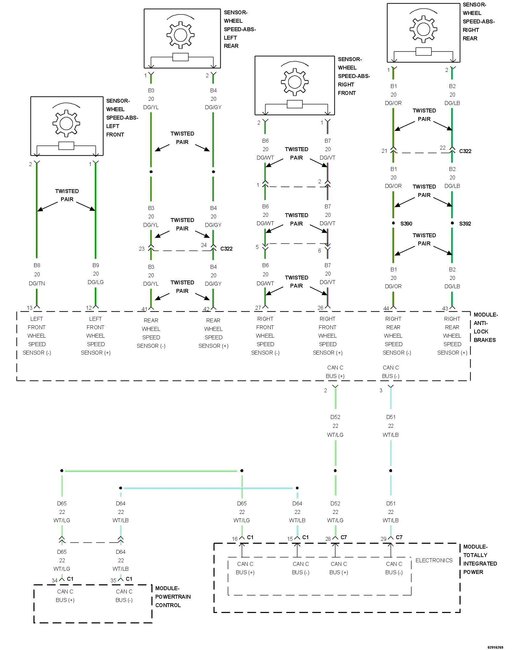

The green wires go to the ABS module. I have attached the entire wiring schematic below. I had to cut it in half to make it readable. I did overlap the two so you can follow them easier.

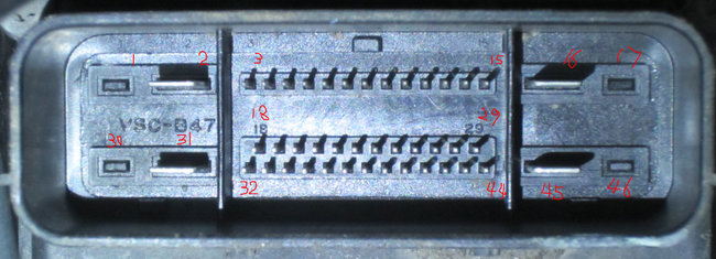

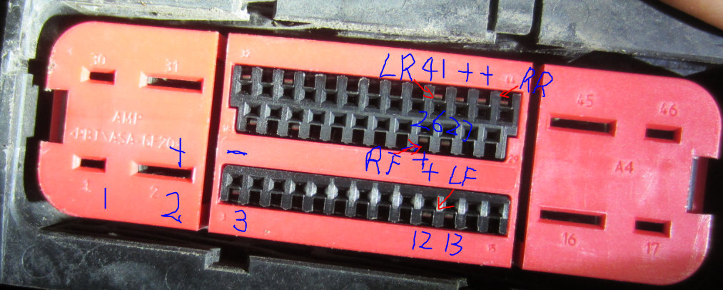

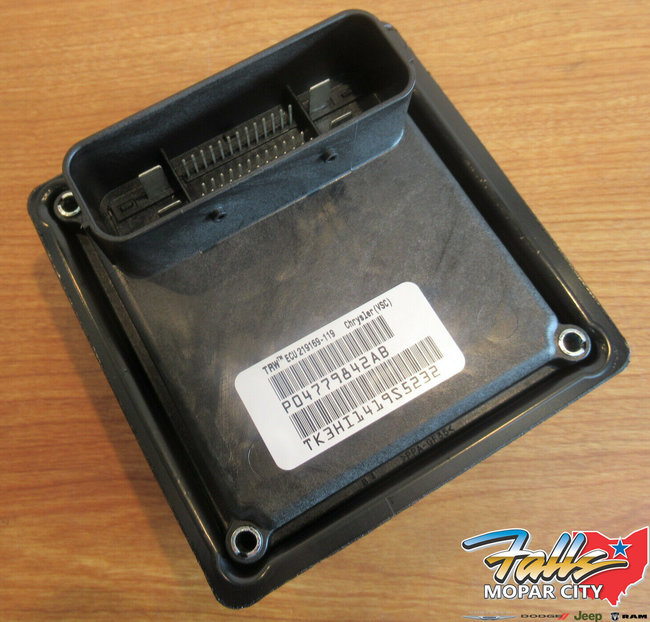

and I take two images for the ABS module interface, it's this year car cabling terminal:
The red female terminal come with 12V in Pin 2, so Pin 41 should be the Left Rear positive cable, but can't measure the voltage when the terminal opening.

If there is an open circuit, I would suggest replacing the cable. Also, I attached the wiring schematic from the manufacturer below. Take a look through it and let me know if it helps.

Both the dark green to interface 42
and the yellow to interface 41
are not break, they are good to the ABS module interface ,no short between the cable.
But this dark green cable can't be found a 12V voltage, but the right rear cable can be measured a 12V voltage when the key turn on.
According to this part diagram, the male interface can't be measure the voltage when the terminal opened. The power input in the female side, only when the terminal connection, the power cable connected.

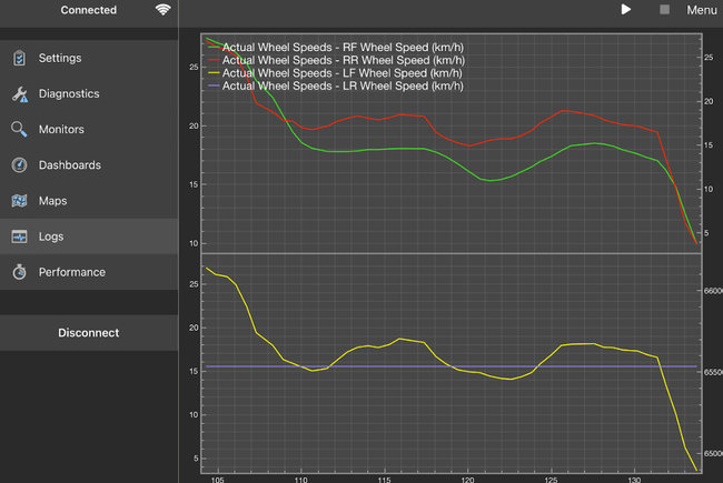

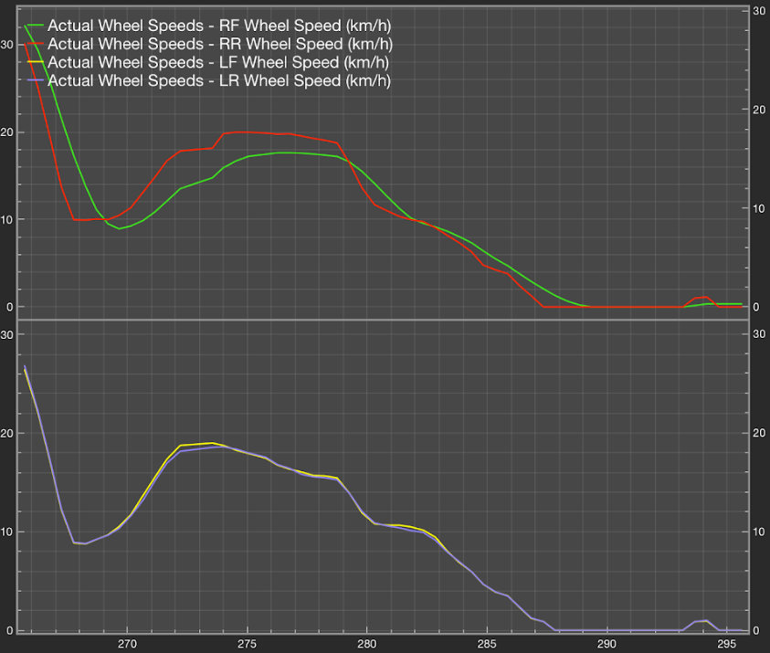

After this found, I use the ODBII monitor the four speed sensors again, it's the same result, only the left rear one no reading. Because it can't be measure the 12V when the key turn on, and the cable problem only inside the ABS module.

A little update: previous I said the positive in #41 interface, it should #42 interface.

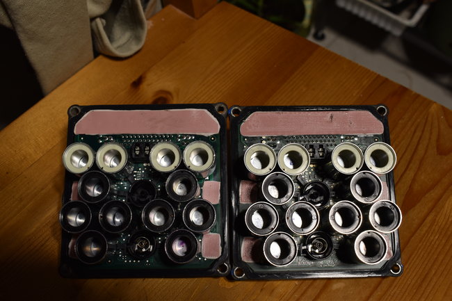

I watch some video in YouTube, they open the ABS module and rebuild the circuit tiny cable, that's be possible some cable broke inside the ABS module, because the 12V voltage through the ABS Module without the fuse. maybe this is the reason the cable broke inside the Module?
I viewed some ABS Module images and video, the more easy way is to buy a used Module, disassembly the circle side and replace my one, if this is possible, I don't need to touch the brake oil tube and valve.

This time new ABS model replace directly as a comparison, another module coming, I can't find my record now, but it means:
1) the ABS Module should be initiated
2) all the four wheel speed sensor can be found, but the new replaced one in the Left Rear, the data is not same with the other three sensors, this make the brake pedal shocking in every time normal brake,
This looks the ABS module is good, but really require a initiated, this part should include two parts, the ABS module communicate with ECU correct; and the four wheel speed sensor should correct in same data.

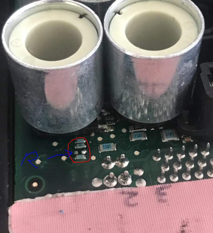

After more than one year, the problem gone!
Conclusion:
1) ABS module lost one resistor
2) ABS sensor broken in the left rear (maybe I broke it when disassembly)

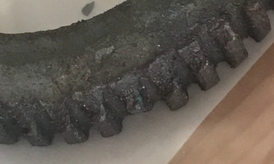

3) The left rear parking brake assembly is almost left nothing, because the salted road in all the winter, It only 4 fixed bolts left, replaced new brake base, finally it works when the speed sensor tone ring changed. This old ring got some teeth breaking when the packing brake was destroyed.
It's really a big project, a general mechanic should change my ABS control model, the two-packing brake assembly, ABS speed sensor, speed tone ring, that's a lot of job and trying :)

1)the original OBD error code:
2)the wrong OBD speed status log:
3)the correct OBD speed log:
4)the lost resistor in ABS controller: without this resistor, there is no voltage in the left rear ABS cable
5)the old speed tone ring: only a little breaking in teeth, changing this one is not difficult as I thought, only a hammer is OK, but it requires remove the rear axle, this should open the rear differential. I made a mistake in first time, few gears fall down from the rear differential, should lock it immediately after remove the locking ring.
