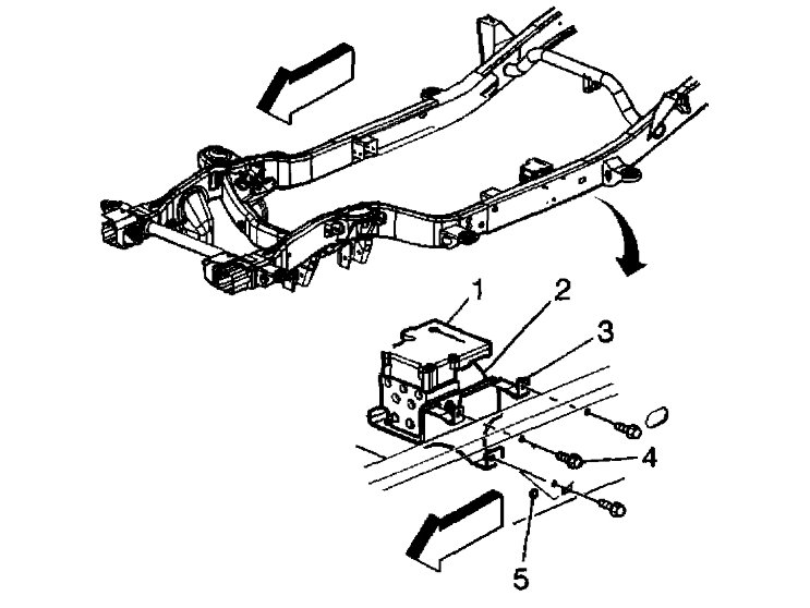

Light on ABS problem. I changed bearing hug wheel but still on when run the truck 10 miles/hour. I erased the code and come back after run at the speed. And my truck when is running light on ABS but I hear a noise like forced and with problems to run more faster sometime I think is the transfer case module. Please help me I use my truck, the snow came and I need drive to my work.

This code is for the pump itself. In most cases, it is the ABS pump that has failed.
Circuit Description
The EBCM applies the ground needed for pump motor activation. The low side of the pump motor has a feedback circuit to the EBCM. When the pump motor is commanded OFF and at rest, feedback voltage is high. When the pump motor is winding down after being commanded ON and then OFF, feedback voltage is low. The EBCM monitors this feedback voltage in order to determine if the motor is functioning properly.

Removal Procedure
Caution: Refer to Battery Disconnect in Service Precautions.
Important: After installation, calibrate the new EBCM to the tire size that is appropriate to the vehicle.
1. Disconnect the negative battery cable.
2. Raise and suitably support the vehicle. Refer to Vehicle Lifting..
Important: The area around the EHCU MUST be free from loose dirt to prevent contamination of disassembled ABS components.
3. Thoroughly wash all contaminants from around the EHCU (1).
4. Disconnect the electrical connectors from the EBCM.
5. Loosen or remove 3 bolts (4) securing the EHCU mounting bracket (3) to the frame rail (5).
6. Gently move the EHCU down enough to remove the four mounting screws that fasten the EBCM (2) to the BPMV (1).
7. Remove the EBCM (2) from the BPMV(1). Removal may require a light amount of force.
8. Clean the BPMV to EBCM mounting surfaces with a clean cloth.
