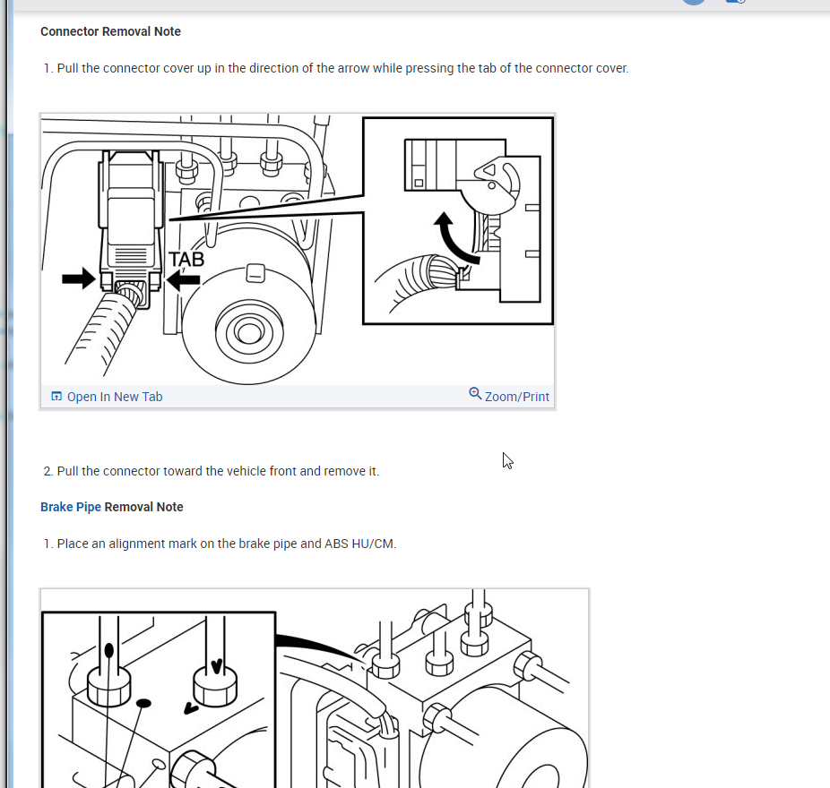

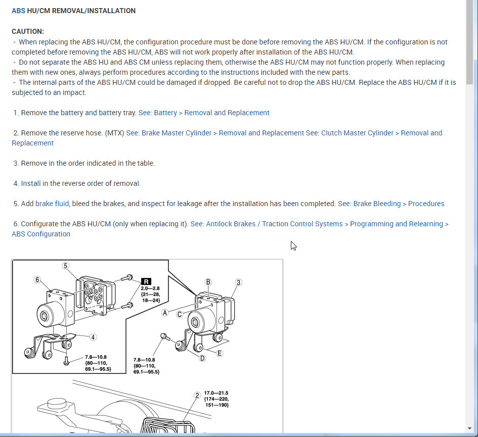

First the ABS light failed to go off and then an hour later the brake light did the same. I have been told I have to replace the whole system at a phenomenal cost. I was just wondering.

Here is a guide that will help with this:
https://www.2carpros.com/articles/abs-warning-light-on-easy-repair-guide
Here is a guide that will help as well on how to replace this:
https://www.2carpros.com/articles/how-to-replace-a-abs-controller

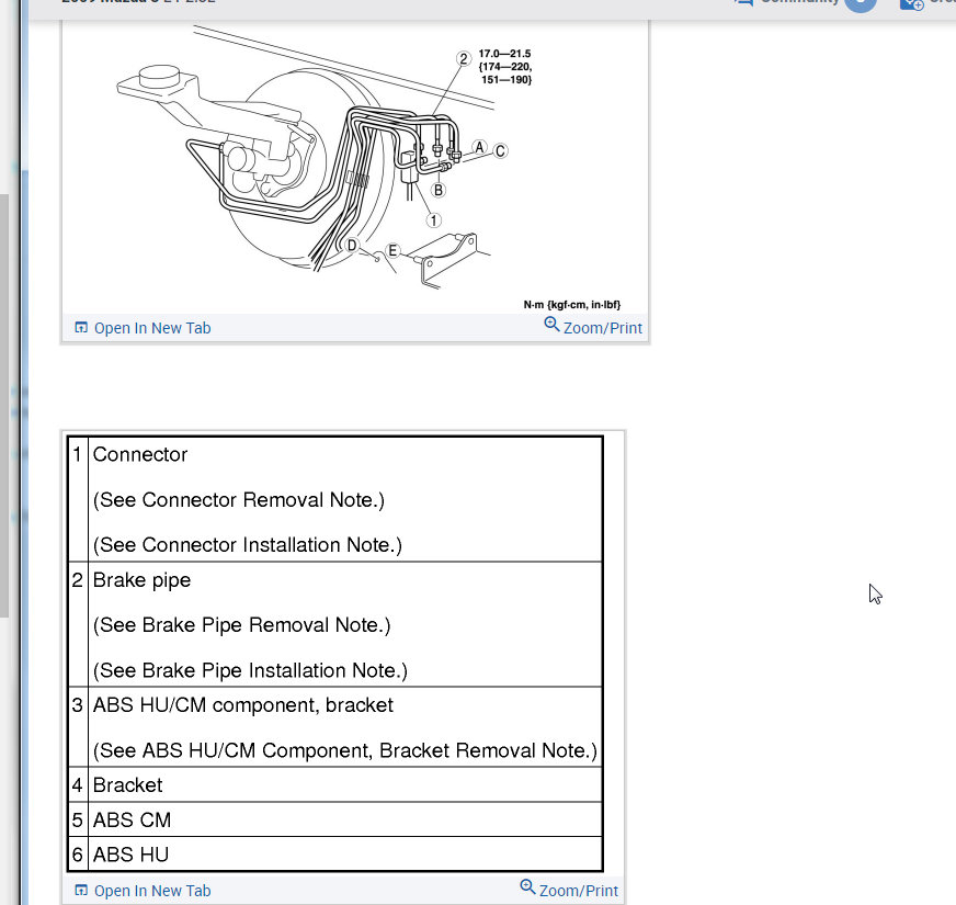

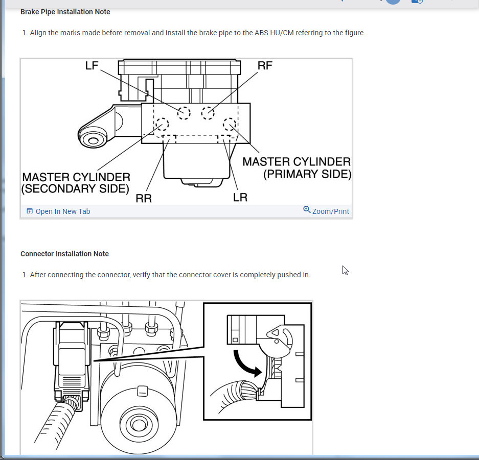

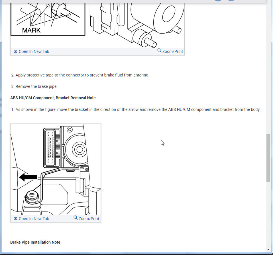

Below you will find the process on how to replace this from the manual which will provide the info that you need.
let us know if you have other questions. Thanks
