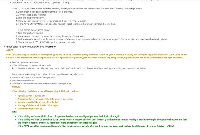

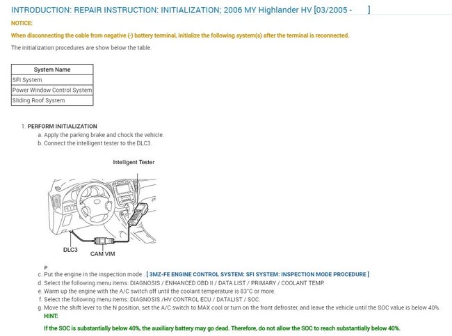

I like your video and thanks. My car has ABS & VSC problem. just replaced ABS module and repaired it myself. I could not clear ABS & VSC. Please guide me what i need to do. Do i need to buy a good scanner tool? Please give me some idea's.
Best Regards,
Raj
Dec 23, 2021 at 9:15 AM

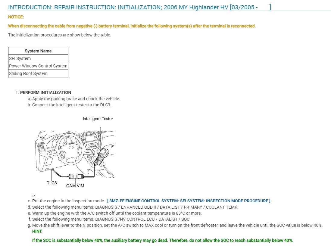

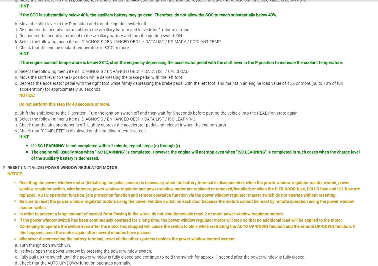

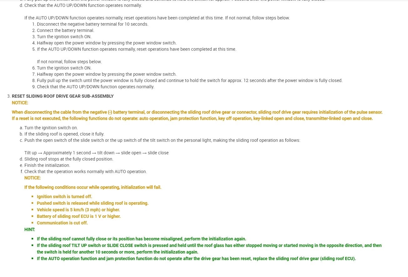

Good afternoon,
The ABS module has to be programmed with the most current information from Toyota.
You would need a scan tool that can program modules and you will need access to Toyota technical support for the download.
I attached the procedure below for you for the initialization.
