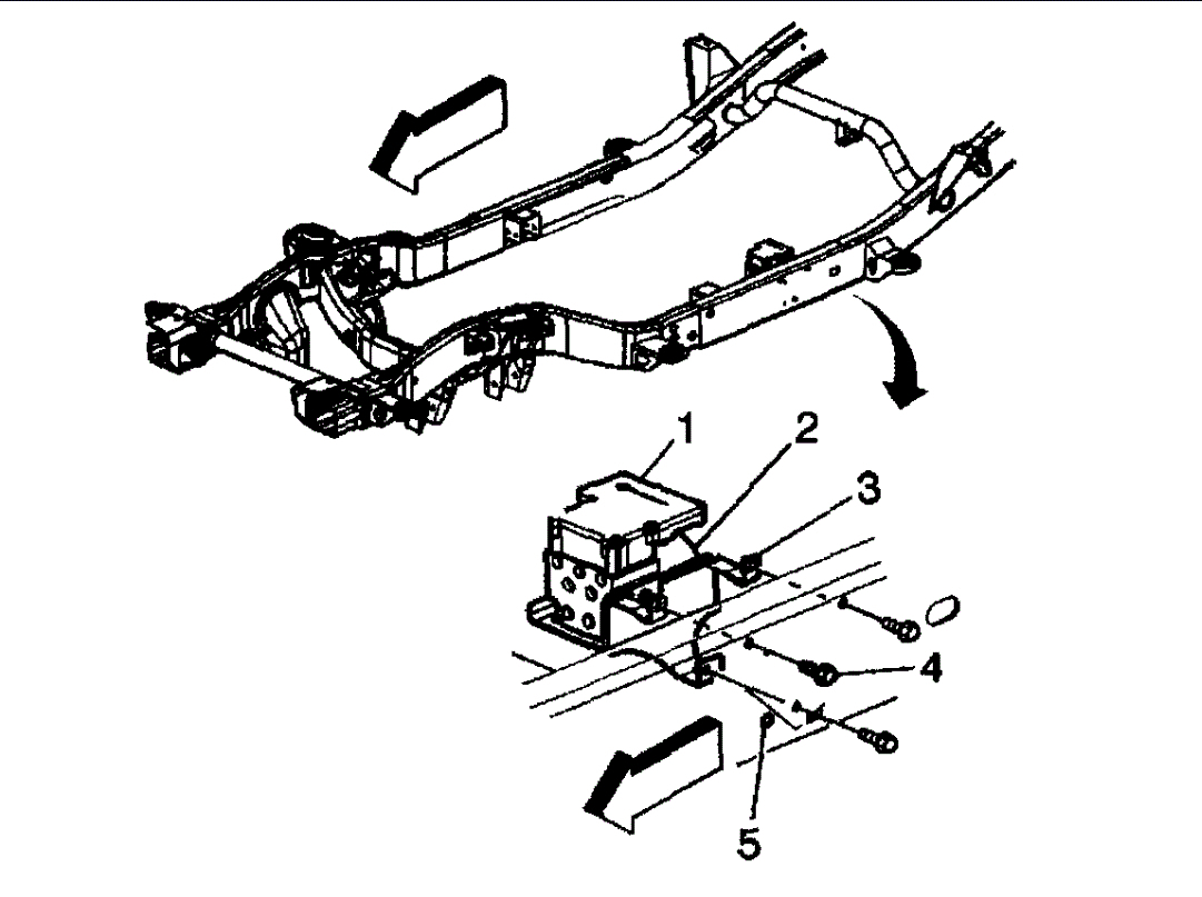

I have seen times where an axle seal leak or wheel cylinder leak will cause a wheel to lock up. However, I suspect you have already checked that. The only other thing I can think of is the brake pressure modulator. If the vehicle originally had rear abs and now doesn't, it is even possible that the brake lines were attached incorrectly at the module. Did you do the work?

No, i did not do the work. Is there a senor for ABS? The whole rear assembly was change.where is the module location? Somebody else change the rear end assembly.
Aug 31, 2020 at 7:31 AM
  • 110,236 POSTS
There is no "ABS Sensor". Each wheel has a wheel speed sensor. Is the ABS light staying on in the vehicle?
As far as the ABS module, it is under the vehicle. I attached a pic of it.

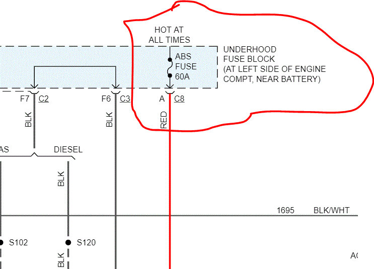

Do me a favor. Remove the ABS fuse and see if the same thing happens. I attached a pic to help you locate it.

I am sorry the ABS light is on. No signal form rear brakes. No ABS on rear axle.
  • 110,236 POSTS
You had be stumped when you said it wasn't on. LOL Anyway, remove the ABS fuse and see if it stops doing it. If it doesn't, then we know it isn't ABS related. By removing the fuse, you will lose abs control but not lose the brakes.
WESTRUCK
  • 55 POSTS
Hi Joe, i took the ABS fuse the fuse out. It did the same think.the wrong axle assembly was put in.
