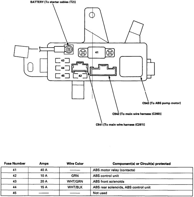

ABS light is on and brakes do not work at all

Where is ABS fuse box? Passenger side wont bleed. Not losing any fluid from reservoir. Help! Cannot afford a mechanic.

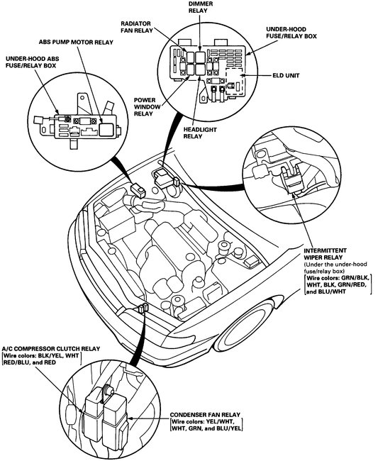

The ABS fuse and relay box is under the hood on the passenger side. See picture 1. Let me know what is happening. Is the brake pedal going to the floor? I have to be honest, if the ABS light is on, that shouldn't prevent the brakes from working. It will, however, prevent the ABS from working.
